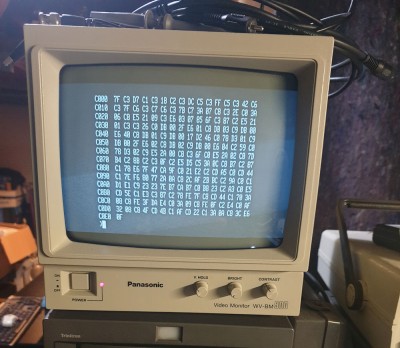

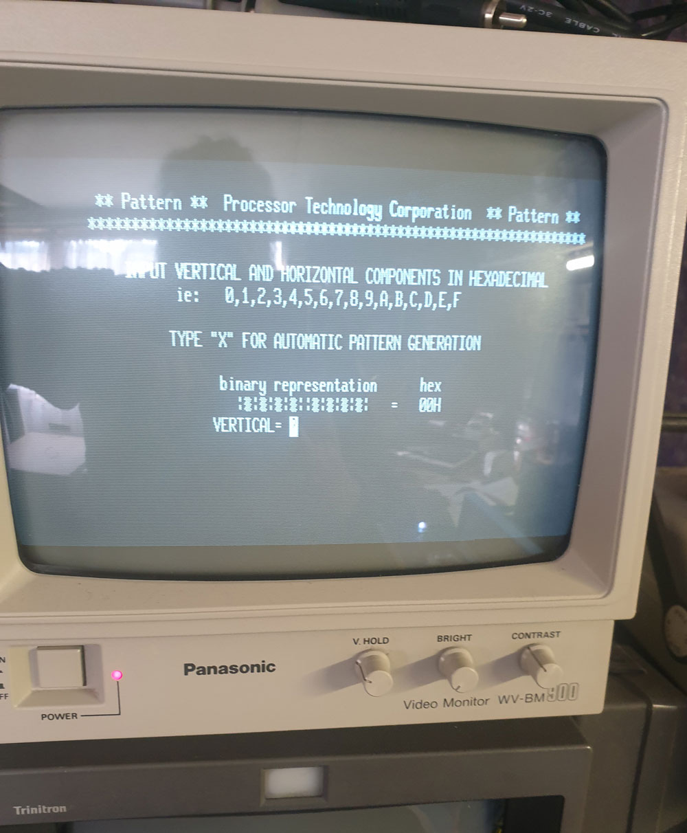

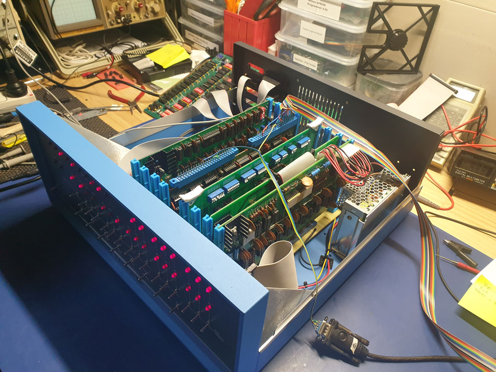

I've got Mikes Flex64K board and a VDM-1 2021 board plus the 3S+P serial and have attach a ASCII keyboard plus serial port to the laptop.
I've now got Cuter to boot to the prompt and can dump memory etc, then tested a transfer of a program of to the Altair 8800c it's very slow transfer at 300 BAUD. Think I change this to 9600 over the weekend. Still learning about the CUTER Monitor, I also need to find a way to get ALS8 into EPROM next, I can not seem to find a BIN/HEX file for this.?

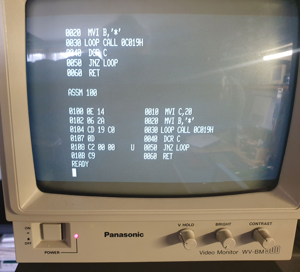

That seems to have gone very easy thanks to your pre made hex file. Is it much work to make a .hex file for ASCII input for the 3P+S board and out to the VDM-1.?
I have only read though the ALS8 Assembler manual once so far, then typed in your example from your video. I got close. I'm guessing I have a space
or something not quite right as I had a error on line 0050, it's fun playing with these old assemblers.

Try this using ALS-8 to assemble it. This should echo everything typed to the screen. Exit by pressing ESC (1Bh)
LOOP CALL 0C01FH
JZ LOOP
CPI 1BH
RZ
MOV B,A
CALL 0C019H
JMP LOOP
