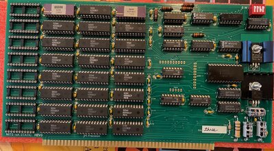

Hi all,
I completed a third 88-16MCS board. As you can see I didn’t have enough 4200 chips to fully populate it, so it currently only has 12K. This works great as the third board because I am able to set the FDC+ memory to start at B000, providing a seamless address space. But of course I’ll definitely be looking for a few more RAM chips to finish it out.
