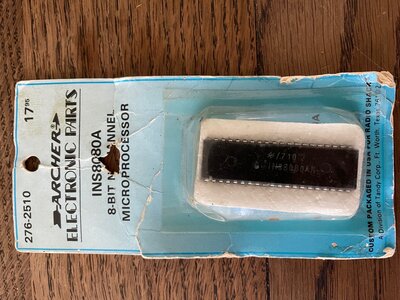

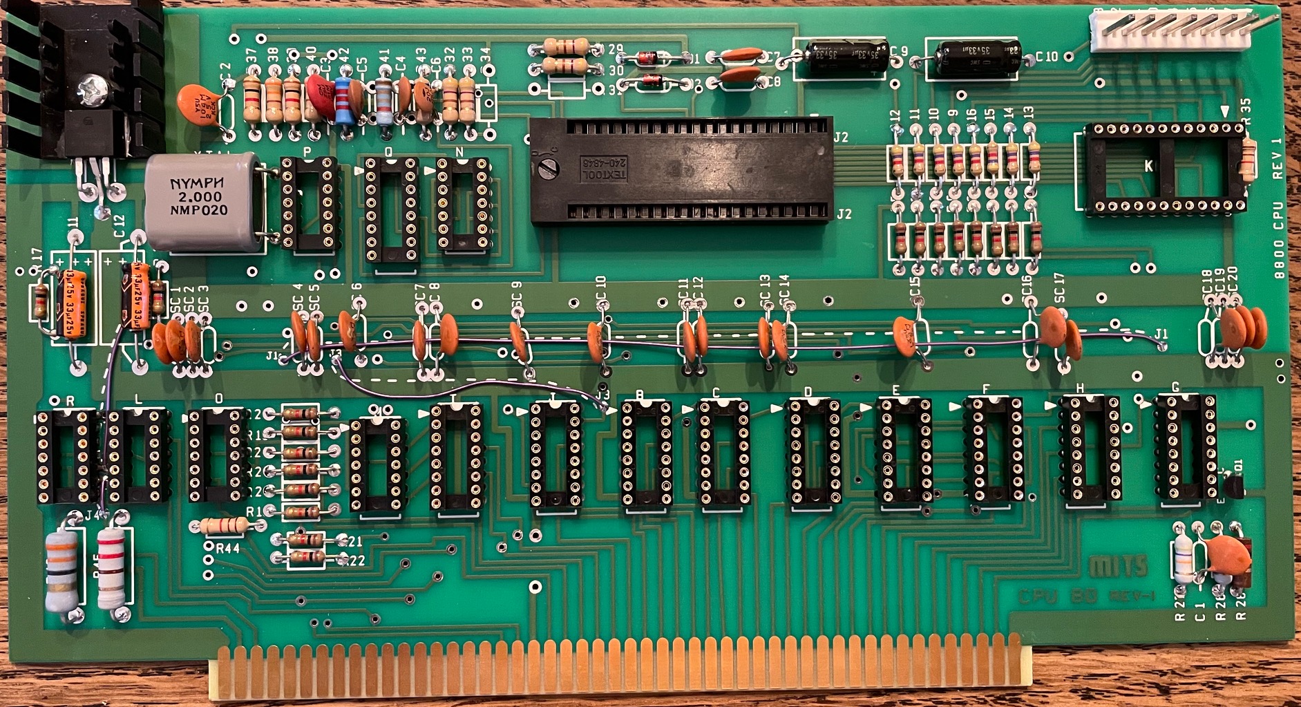

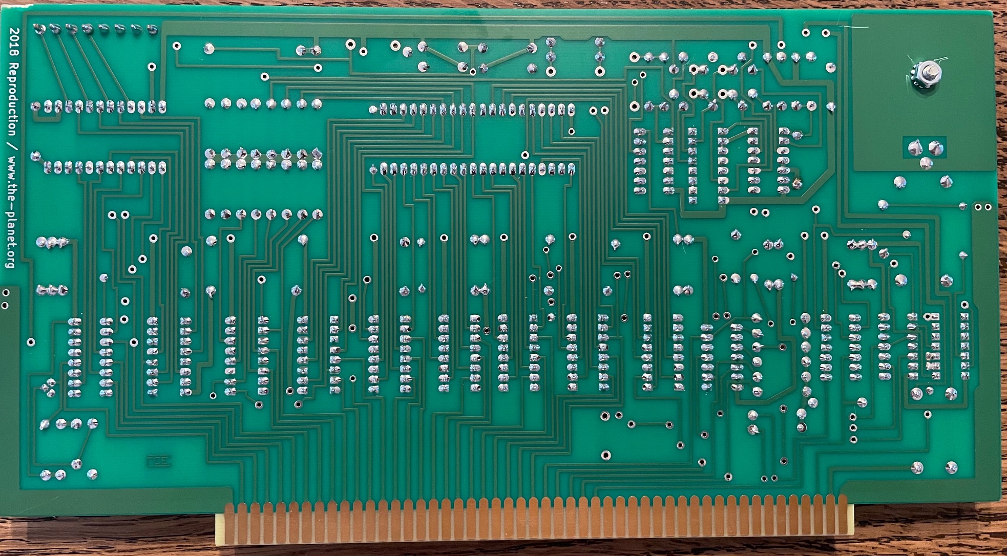

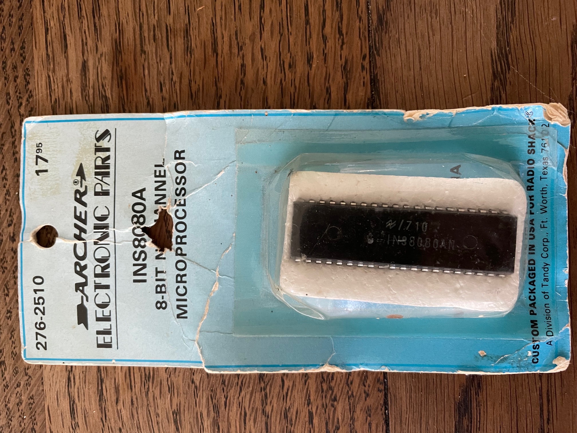

Here are a couple of photos showing some of my progress so far. Here are the CPU board, and also a CPU I hope to use. I have had this since I was about 14 years old, so over 40 years I have miraculously held onto this. Note there is neither bar code nor www dot anything anywhere on it.
I also completed the backplane and will post photos of it next.
Sirius
CPU board top
CPU board reverse
8080A CPU

Welcome, new friend!
Absolutely love that Radio Shack processor chip.
I can just picture it hangin' on the pegs at the local Radio Shack, taking it down and paying for it at the register that had no point-of-sale system. The salesman hand-wrote the ticket, took your money and sent you on your way... For you to happily install it in your Altair today!

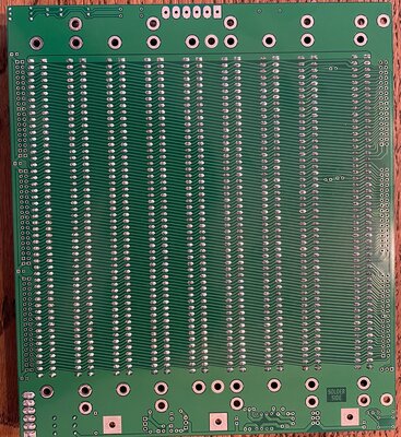

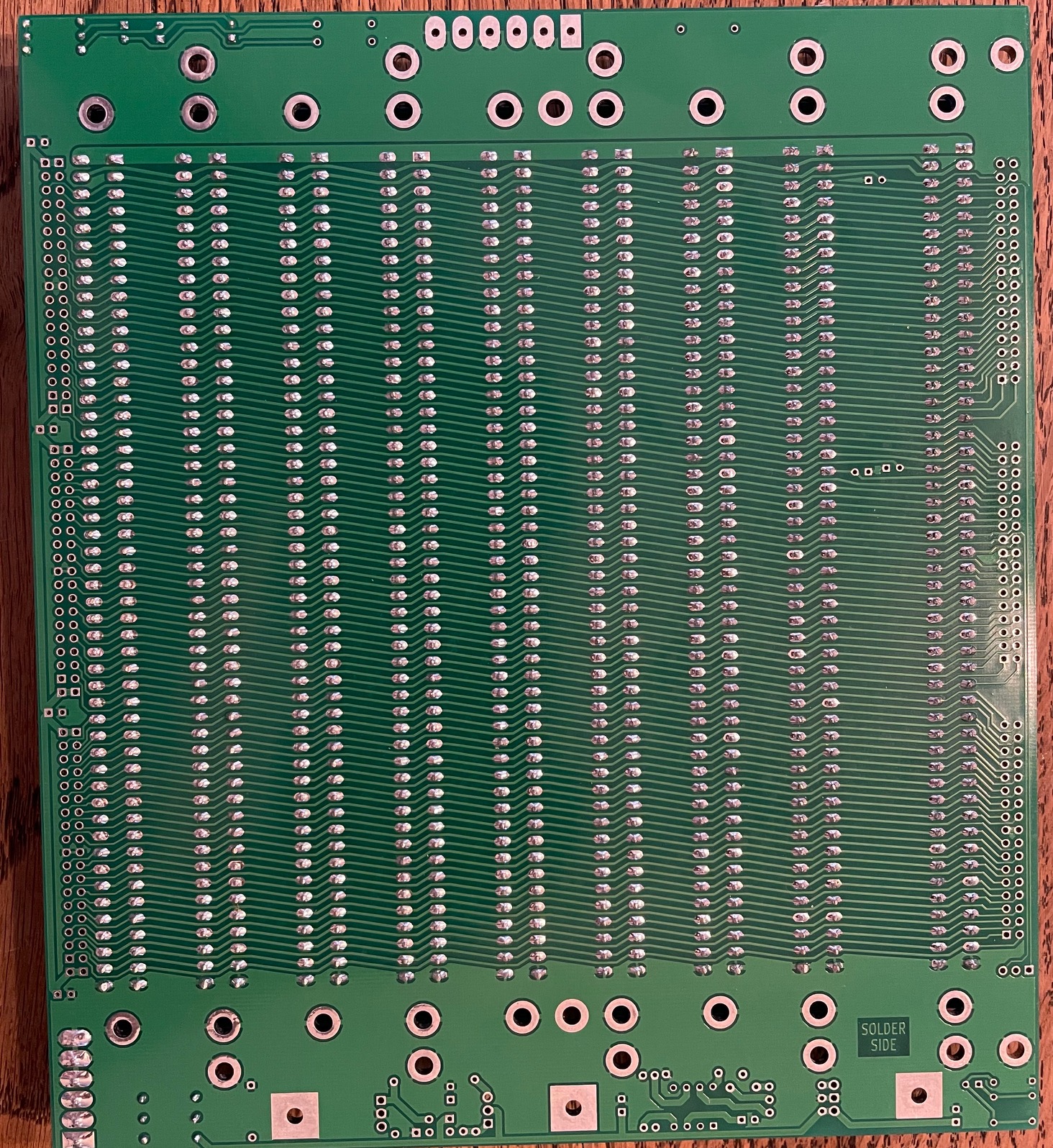

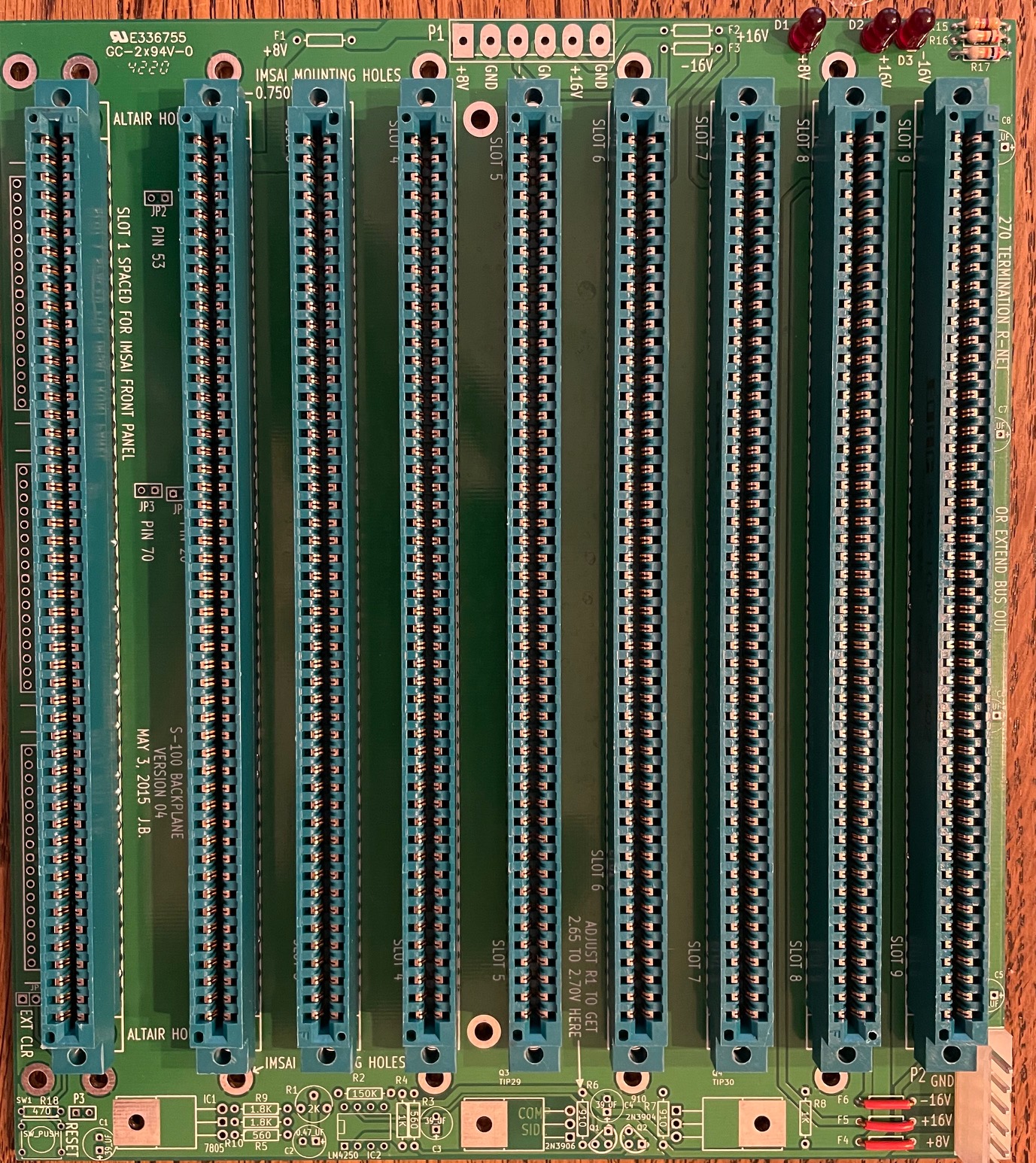

I have photos of my completed backplane here as promised, but also a question for you guys:
What are folks who want one doing for an audio tape (cassette, stream, etc) interface? The options I’ve learned about so far are the 88-ARC, possibly 88-UIO, and I’m wondering also if the cassette interface for the Altair clone is an option? I would assume not, but I dunno anything about the innards of the clone.

Now for those photos:
Backplane Top
Backplane reverse

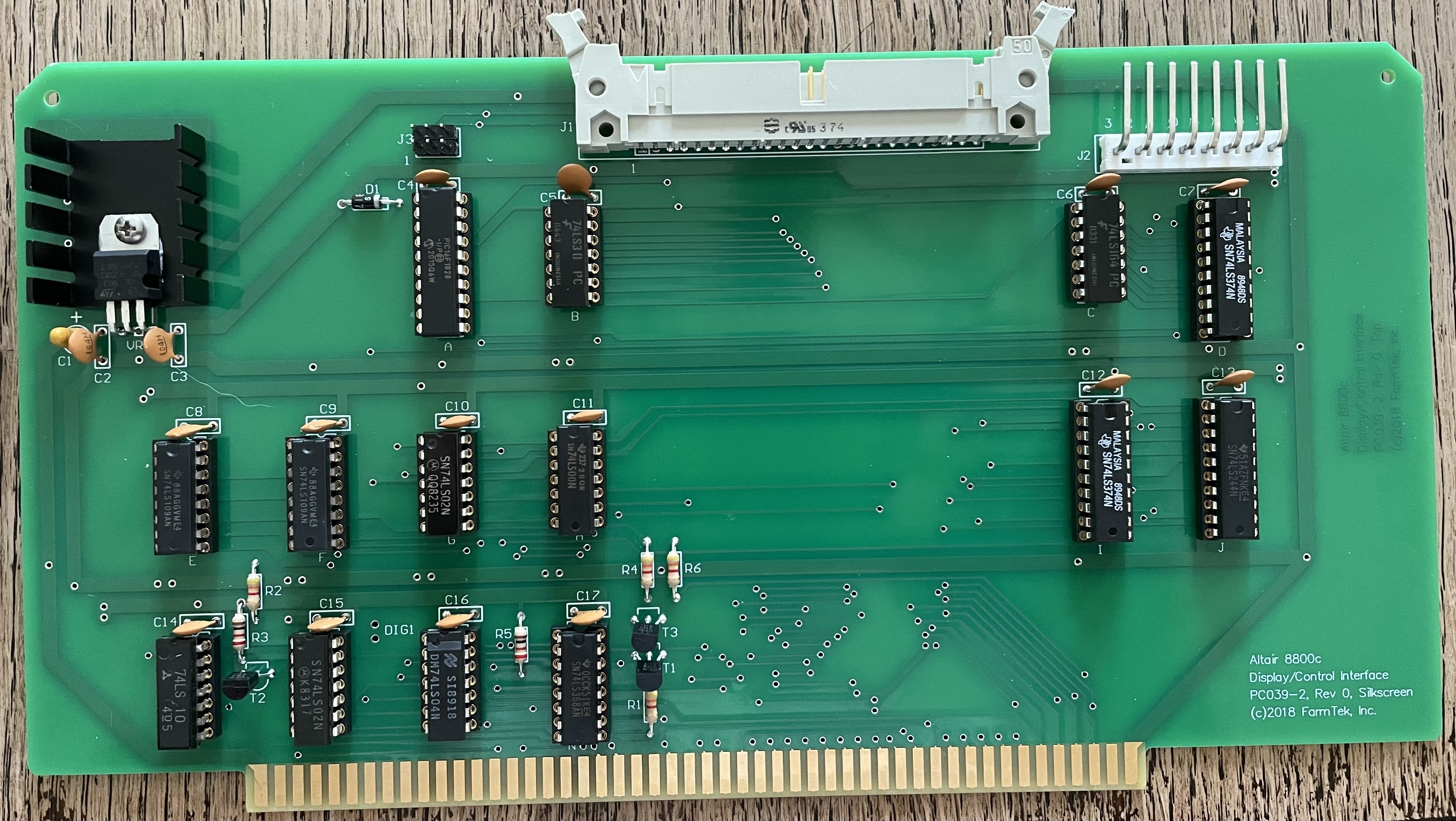

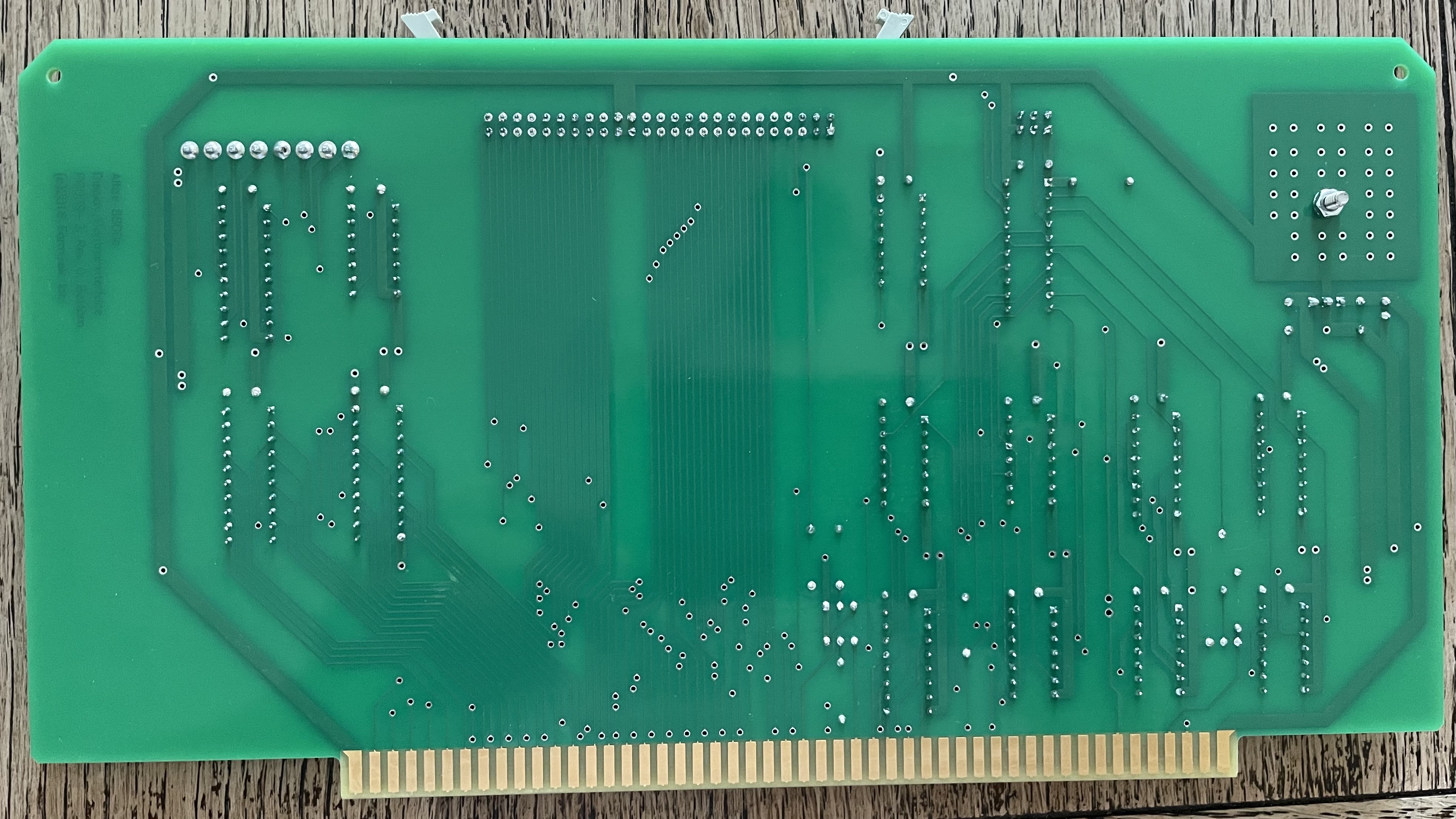

I have completed the display interface board and sharing photos here. Now working on the display board.
I am getting so close! This is such a pleasure to work on. Thanks to those who made it possible.
Sirius
Interface board front Interface board reverse
Sirius

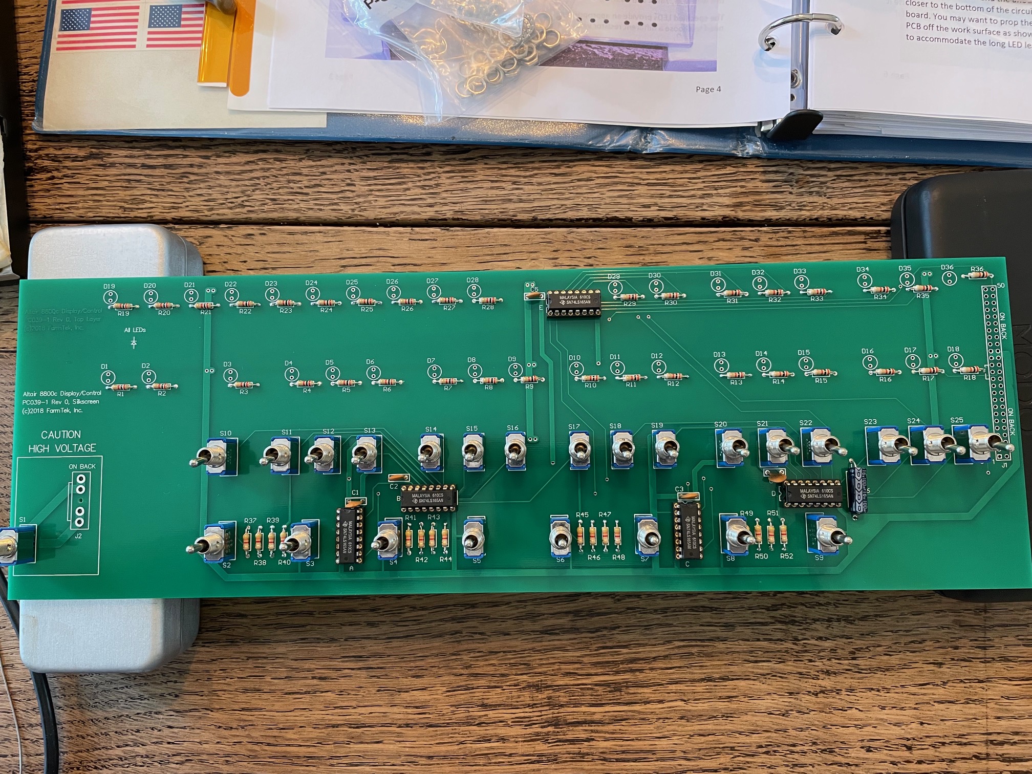

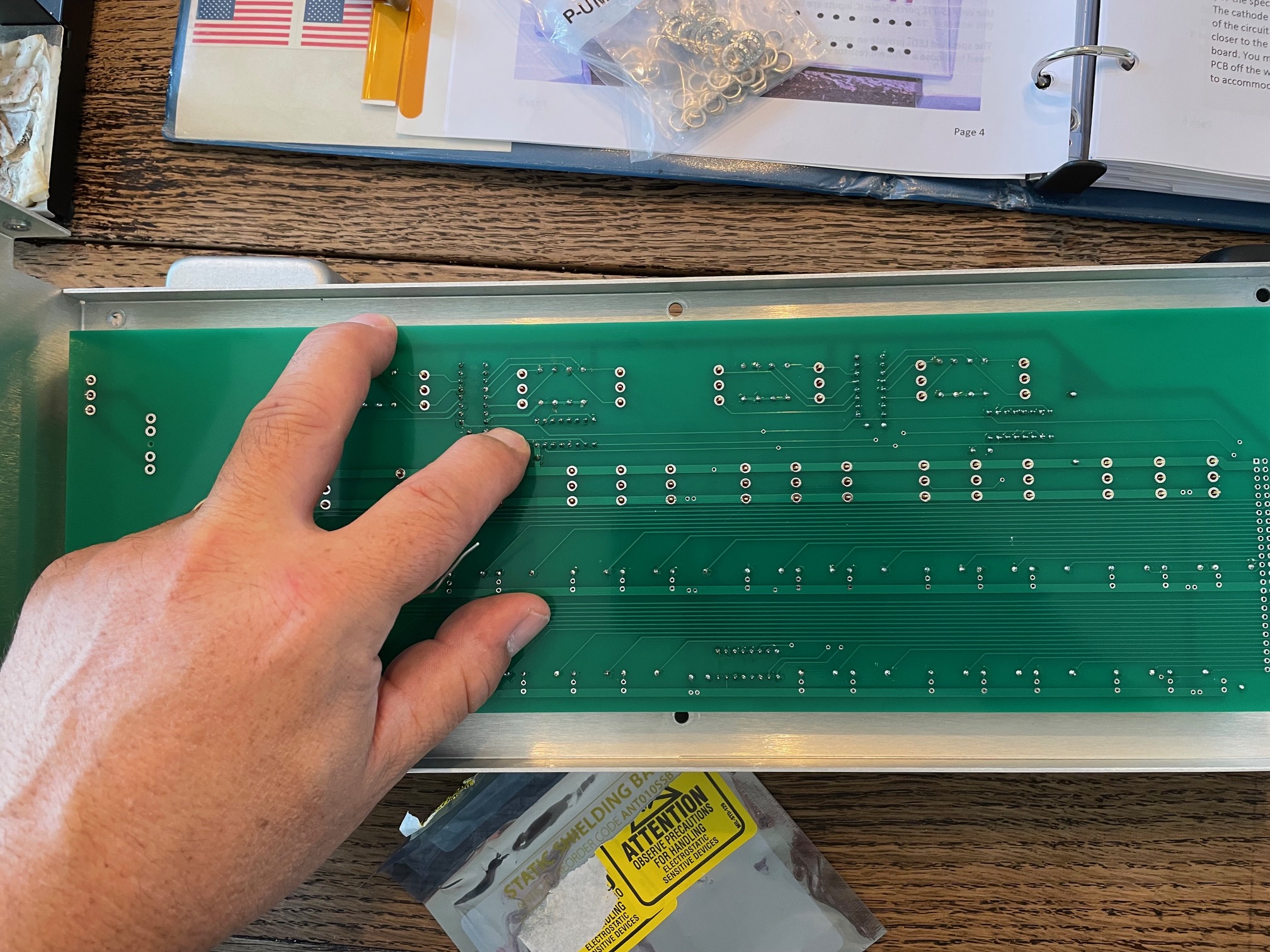

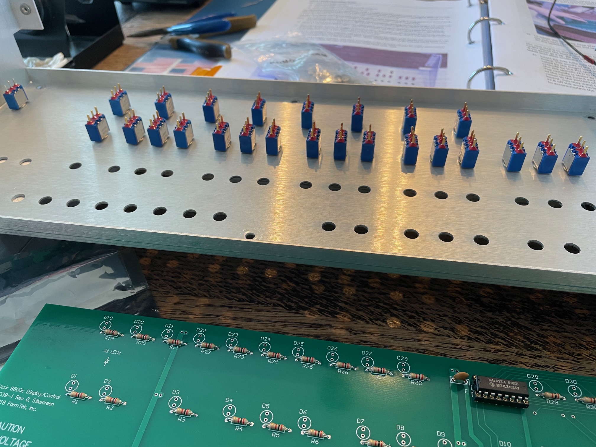

Hi all, I wanted to show you my progress on the display board while waiting for some parts. I’m waiting for the molded connector for the power and so have not installed the LEDs yet — I don’t want them to get all bent up between now and having the final parts installed.
So in preparing for this post I was checking out my photos and I noticed, in the photo, that I got one of the switches backwards! S18. I couldn’t believe it because I checked SO many times before soldering. Obviously, I didn’t check enough.
I’m very disappointed about that. At first I considered leaving it, like I did the one resistor I got “backwards” on the CPU board. I just don’t like the way that looks but I left it.
But this switch .. it will be visible. So I’ve almost convinced myself to solder sucker it out of there and turn it around. Groan. I can’t believe it.
Right now I’m working on mounting the power supplies while I wait for the molded connector for the power on the display board. The one final piece I need for that is the molded female housing for the DC connections to the backplane. I can’t find this 6 position molded housing right now for some reason. Perhaps I’m looking in the wrong place or searching for the wrong thing. I think that is the only remaining final part standing between me and completion.
That, and turning S18 around.

Don’t try to solder suck out the switch. Instead, heat all three pins at the same time as best you can (add some solder to each pin to increase heat transfer) so the switch basically drops out of the holes. Once out, then solder suck the holes clean.
