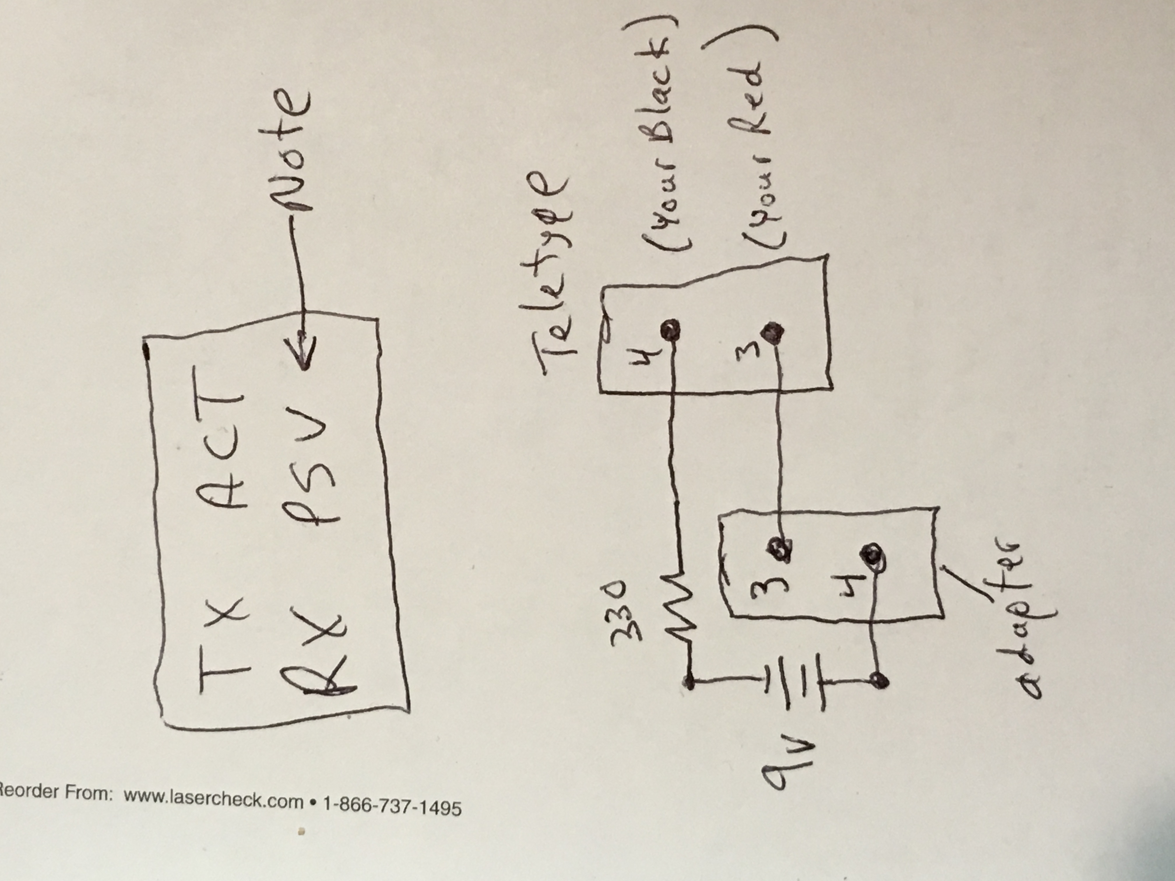

Re: RS-232 to current loop (again)
Try this as an experiment and see if you can get receive working. Use a NEW 9 volt battery, set the receive side to passive (PSV), and change the receive wiring as shown. Transmit data to the teletype is unchanged (still ACT).
You can use a 12 volt supply and a 470 ohm resistor instead if needed.

Mike, I'd be most interested in the plug-in solution to my ongoing current-loop converter woes -- I can wait! I'll try the 9v battery fix on Wednesday when I'm next in the lab (and after my Amazon-sourced supply of resistors and 9v battery connectors has arrived!)
Alas, still no good! (Same fault: TTY can receive from Altair but not transmit to Altair.) I guess I'll bump along with my B+B converter until you've done that super-duper fit+forget solution, Mike. Thanks for the attempts -- seems like the new adapter just isn't behaving right.
Gabriel
Gabriel
