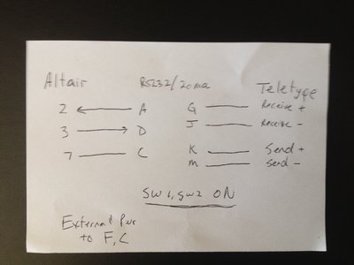

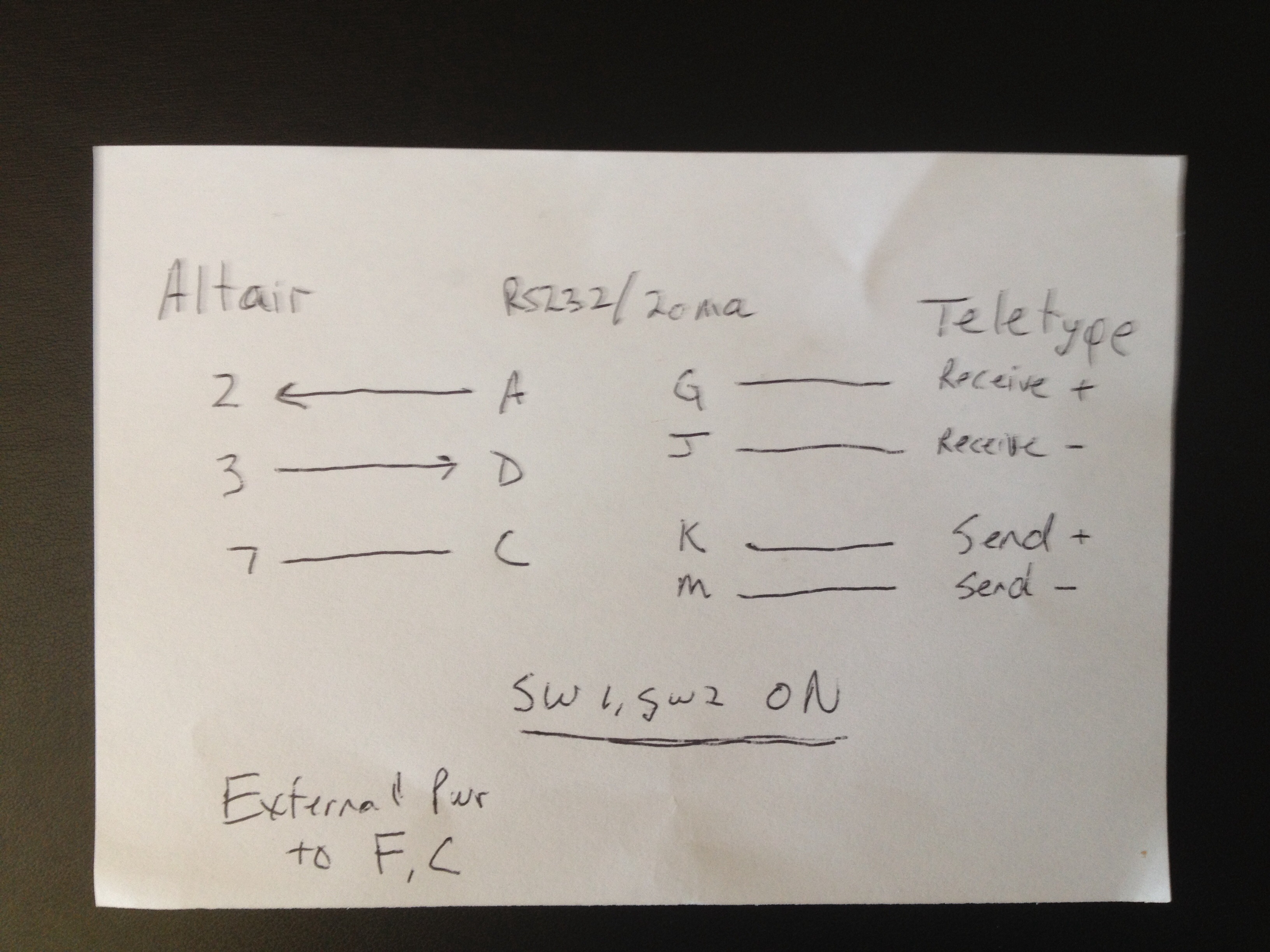

I bought the new converter secondhand on Ebay so there's no manual, but there is a cheat-sheet for the connexions, which I've put a picture of at:
http://gabrielegan.com/scratch/RS232-pic.pdf
If you can make any sense of how the 6 jumper switches should be set for an ASR33, that'd be even more dandy!

I'm not sure what to tell you for sure on this one without seeing a schematic. A Teletype provides no current for either the transmit or receive loop, so power for the loop must come from the outside (e.g., your RS-232 to current loop converter). I see a jumper option for providing power for the transmit loop, but there is not the same option for the receive loop, so this converter may not work for you.
I would assume T+ and T- pins are data out from the converter and data in to the Teletype. Similarly, I'd assume the R+ and R- pins are data in to the converter, data out from the Teletype.
I would apply 12 volts to the loop power input and set the transmit jumpers to "Active Transmit." Set W3-W4 with the "Data Transmit" setting and W5-W6 with the "Data Receive" setting. At this point, the constant chatter on the Teletype should stop and data you send to the Teletype should print. However, I'm not sure that data you type on the Teletype will make it back to your computer unless choosing the "Active Transmit" option and applying power also powers the receive loop.
Keep us posted!
