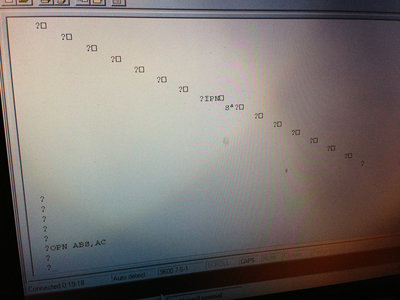

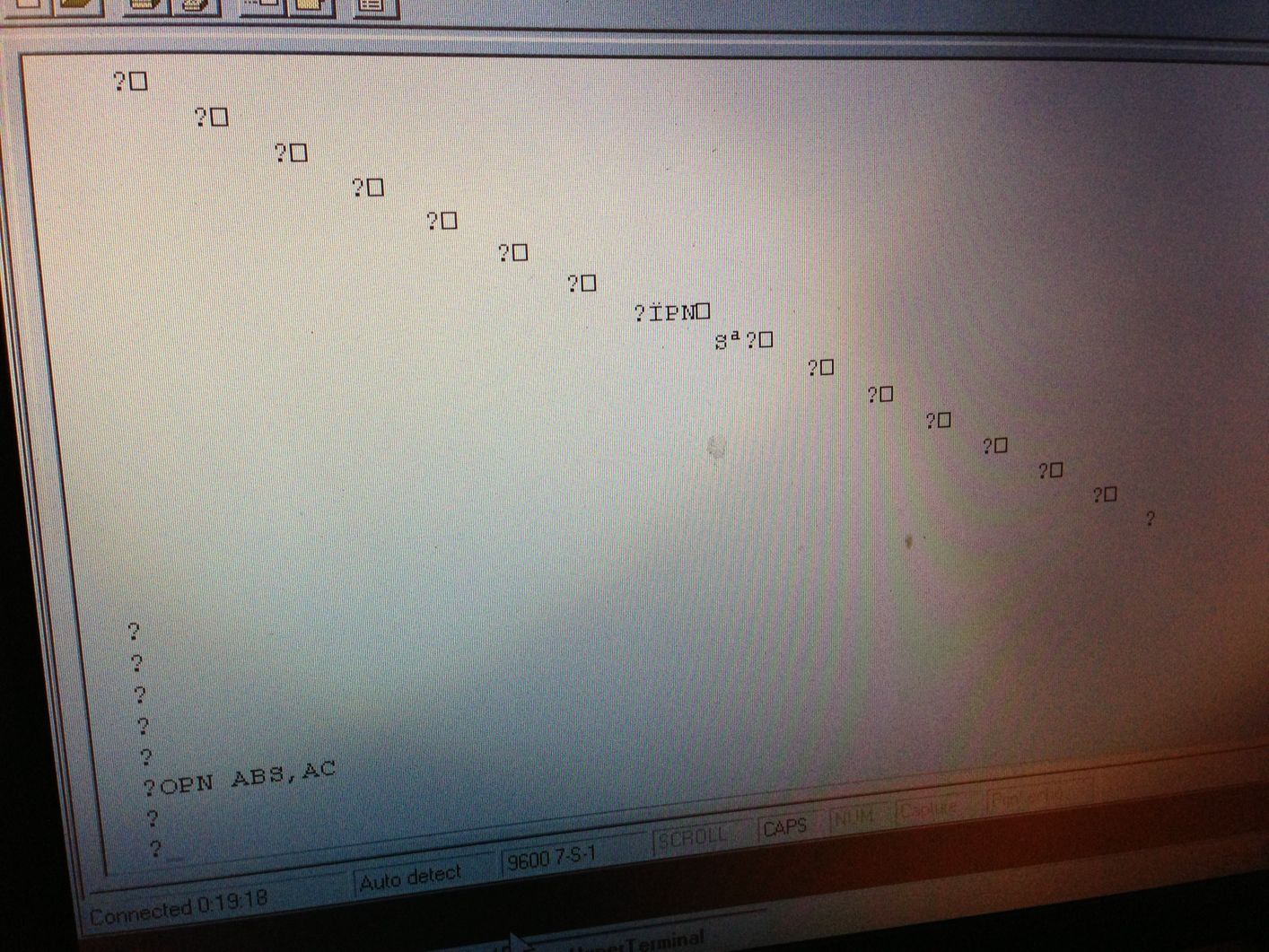

I have attached an image of the output. The first part shows output with A15, A11, A10 and A9 raised with 7-S-1 as I fiddle with the settings. Then you can see good output when I switched to 7-S-2. The very last line shows my final test with A9 down. It didn't work with 7-S-1 or 7-S-2... but I still get a prompt. *shrug*

The setting of "7S1" in TeraTerm effectively makes TeraTerm ignore the parity bit since TeraTerm still displays characters received with a parity error. This is a common trick when using TeraTerm and is required for running 4K and 8K BASIC which use the MSbit of some characters as a flag. In the days of the Teletype, the value of the MSbit didn't make any difference since the Teletype ignored it.
HyperTerm, which I see you're using, is a different story. HyperTerm ignores characters with parity errors. Though not clearly documented, the MITS Programming System II (PS2) transmits characters as 7E1 (i.e., even parity). When you choose "7S1" on HyperTerm, it is ignoring any characters that don't have space parity. That's why the carriage return (parity bit is set from PS2) is ignored by HyperTerm. The line feed is accepted and moves down a line. I can't duplicate what you're seeing with "7S2" working. Did you maybe choose "7E2" by mistake? That would work.
If you're going to use HyperTerm, I'd use 7E1 or 7E2. Note that PS2 ignores received parity, that's why the general solution of 7S1 in TeraTerm works for most any Altair software configuration.
