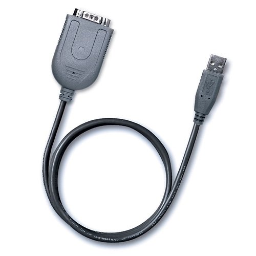

Hi all:
I connected to the Altair 8800 computer. If someone helps, I used the following cables:
DB25M - DB9F Standard.
DB9M - USB: Belkin F5U103v
Software: F5U103 Driver Installer.exe
Details of my system:
Windows 7 Professional 64 Bit.
USB 2.0
TeraTerm terminal
Everything works correctly. When I connect the Altair, the STOP and Left AUX connected switches, display the menu of the Altair 8800 on screen. The cable was purchased at Amazon.
Thanks.
Miguel A. Pastor.
