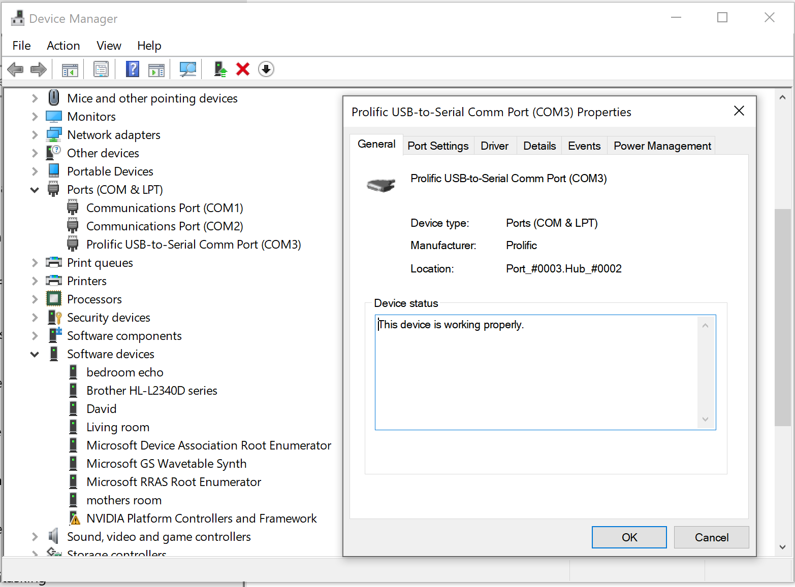

I assume you’re trying to get a USB to serial adapter to work with your PC? This will have nothing to do with the Altair Clone - you can use any USB to serial adapter that will work with your PC, or a PC with a real serial port, or a video terminal or Teletype.
On your PC, look in the device manager under the “Ports COM and LPTl category. Expand that heading and see what devices are present.mis one of the, the USB ago serial adapter? Does it have an error flag icon showing?

Yea I think I am chasing something unrelated to the task...if I look where you pointed I see a usb to serial on com3...
So time to install teraterm point to port 3 and turn on the clone...
