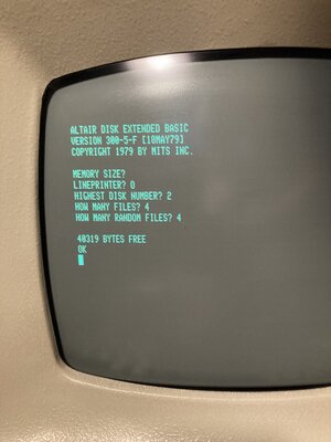

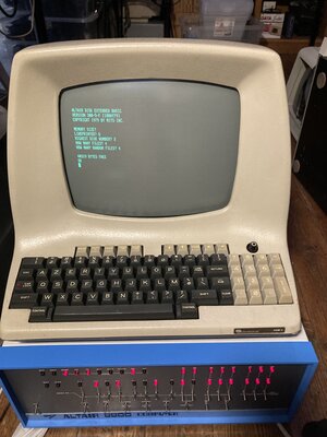

The Altair connects to my computer through a null modem cable, and the terminal connects to my computer with a straight cable. So I used a null modem cable to link them together. Unfortunately I can't manage to display anything on the real terminal. I tried Basic from drive 0 with A15-A12 to 0010 after examining FF00. It works if plugged to my computer, not with the terminal. I tried the SIO Echo program, same thing...

Re: Lear Siegler ADM-5
Your Altair Clone is wired as DCE, the terminal os wired as DTE. Remove the null modem between them.
Post by Ben_Aveline »
I knew I was missing something very obvious...
Thank you Mike
