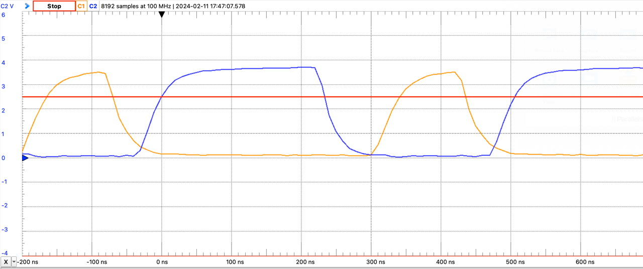

Thanks, I experimented with the clock again and this is as close as I can get what I think is the spec. The waveforms are pretty pathetic looking compared to what I have seen online. I have replaced every component in the circuit and it doesn't get any better. Screen grab below.

The clock looks to be out of spec. The biggest issue the 8080 has is with the timing from the falling edge of phi2 to rising edge of phi1. It needs to be > 70ns, but yours looks less than that. It’s harder to measure without standard time divisions, but yours appears to be around 40-50ns at the midpoint.
Adjust R14 proportionally to reduce the high period of phi2. This increases the phi2 to phi1 time as we need. The high period must remain > 220ns. If more time is needed, decrease phi1 proportionally which will further increase phi2 to phi1 time. Phi1 high must remain > 60ns.

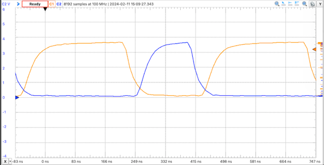

Ok I tried again basing measurements at 2.5v. As I read the spec the measurement for the time between PHI2 and PHI1 is measured from the low threshold on the trailing edge of PHI2 to high on the leading edge of PHI1. If I adjust and measure at 2.5v; PHI2 is 230nS, PHI2 to PHI1 is 107nS and PHI1 is 95nS. This capture is what I have now and should be a little easier to read. I also tried a few variations on either side if these number and, sadly, it is still not working. Thanks.

Clock looks better now. It would have been a problem later anyway, so it’s good to get it right.
