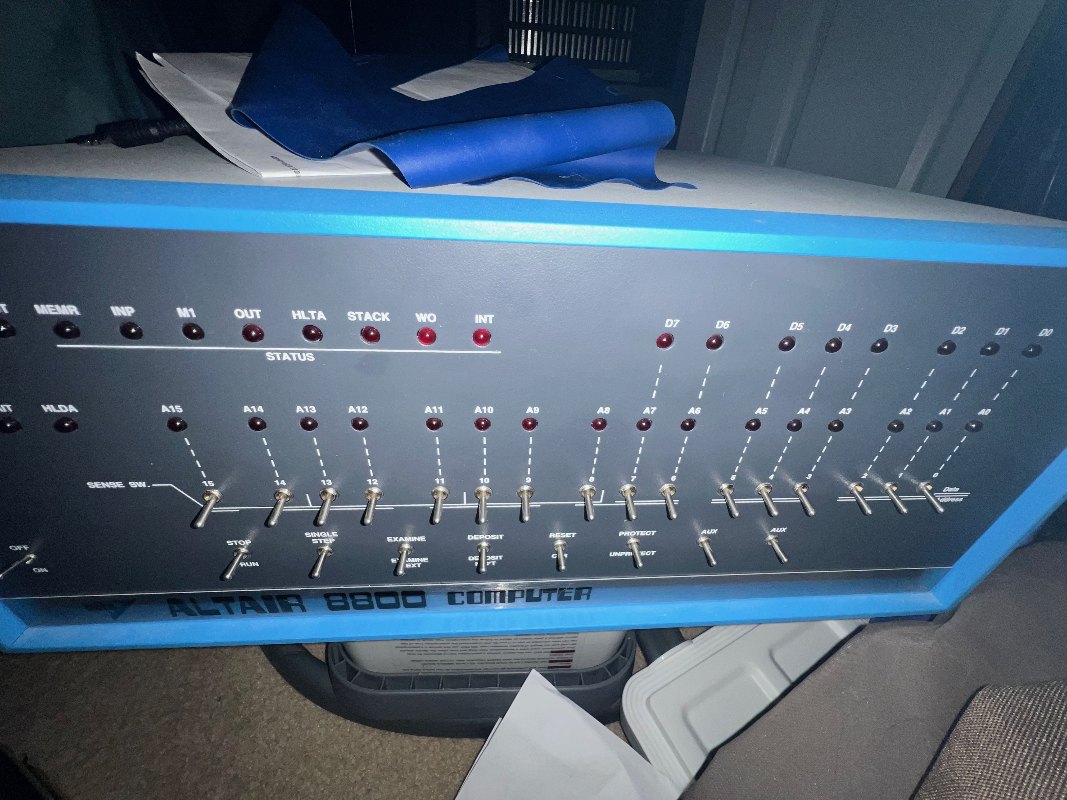

Issue 1) What the heck happened? It is not the fisheye effect. My front panel LEDs appear to retreat into the case toward the center; however, it looks almost flush on the sides. Looking back at the instructions, I think I may have missed the step where I was supposed to put one of those plastic spacers in between the front panel and PCB, to prevent "PCB sagging," but I don’t 100% remember. Also, there are a couple of solder joints that are not making a good connection to the front panel PCB, so the "INTE" LED and "A8" LED have to be jiggled to stay on. I think I fixed one of the LEDs already, back in 2015. I believe it was the "D7" LED.
I will be fixing the LED issues soon. Overall, it might just be easier to take out the front panel, desolder all of the LEDs, buy a whole 36-piece LED set, and redo it properly. That said, I don’t see why I can’t just skip that spacer step and just mount the LEDs loosely until the whole front panel is mounted in that L-Bracket. After all that, I could just push them flush into the front panel and solder each one as I go (hopefully the LEDs flange out far enough to catch). Reduced warping tolerances would be an absolute worst-case scenario for this method. I would like to hear everyone’s input, especially our leader, the good man himself, as well. Feel free, to be honest, I can take criticism. Also, if you have any advice, it would be most appreciated. Overall, my excuse for the butchered soldering job was lack of experience. I will add that I redid most of the joints in 2015, so they look a lot better now than when these were taken.

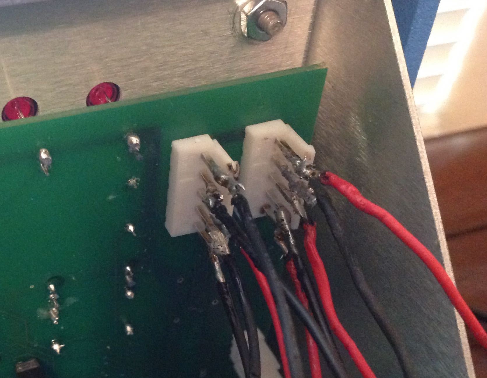

Issue 2) in 2013, my understanding of the RS232 was established to me from the physical connector rather than the protocol standard. I didn’t know that they were separate. This was one of my hardest gremlins to resolve after I finished the kit. I did not have the proper tool to wire together the RS-232 data cables and slot them into their Molex connectors—I didn’t even know there was a proper tool for them until about two years ago on a separate project for my car. I’m not quite sure if I had the wiring correct the first time I had the system set up, but I was definitely having intermittent connection problems due to my terrible “crimp” job.
I don’t know why I thought this was a good idea at the time, but I decided it was better to solder all the male pins straight to the wires (bypassing the Molex connectors) going to the DB-25 connector on the board. In hindsight, alligator clips would have been just fine. Well, this did two things: it fixed the intermittent connection problem to the terminal emulator, but it made those male Molex pins thicker, so if I wanted to go back to the female connector, it would be next to impossible to slip back on. This was the case when I decided to reverse my mistake in 2015. That said, I will be replacing the connectors Male and Female, and possibly purchasing some replacement DB-25 connectors (I think I wired the port up like a Null Modem, when it should have been 1 to 1.

On the connectors:
I would suggest removing excess solder with a solder wick. Buy about five rolls of solder wick and remove all the solder. Get a couple cans of flux remover too, 'cause after you're done desoldering and resoldering, your boards will be a mess. Work on each pin, one at a time, melting the solder and removing the wire. Then remove excess solder from the pin with a solder wick. Alternatively, you might want to use solder wick to remove and replace the whole Molex connector.
Be careful to let the PCB cool after each solder attempt. Do not hold heat to the board longer than about ten seconds at a time. We don't want to weaken the adhesive that holds the copper to the fiberglass. We don't want to damage the board.
After you've cleaned off all the connector pins (or replaced the Molex connectors entirely) then make cable assemblies with connectors and nice fresh wire.

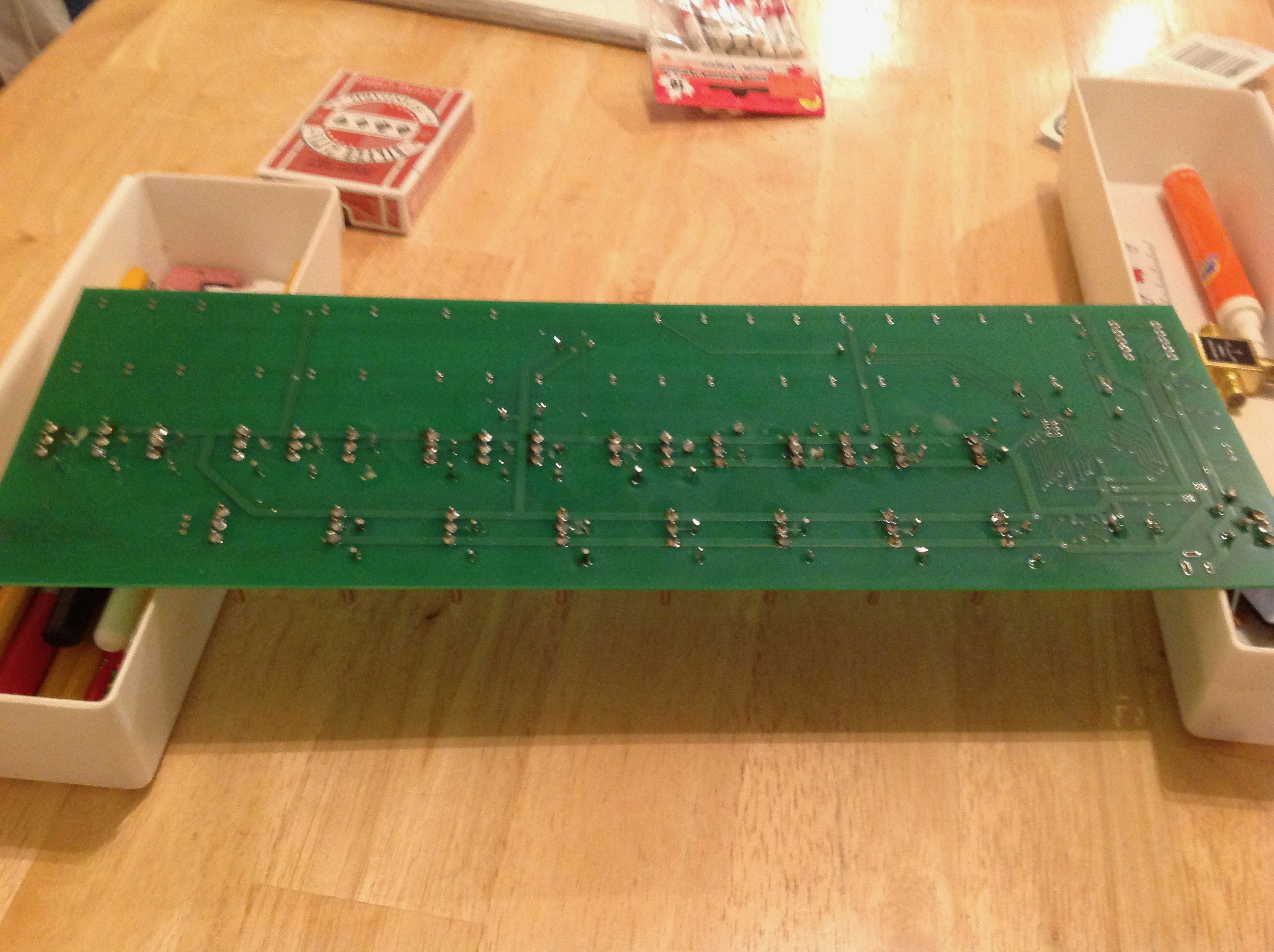

On the PCB warpage:
It's not uncommon for a printed circuit board to warp, especially a long one. So, yeah, the board must be "clamped" as the components are soldered onto it. That's what those spacers do. They hold it in place.
I would suggest desoldering all the LEDs with solder wick. Take your time, simultaneously heat both leads of an LED and pull it out. If you don't have a chisel tip that spans both leads, get one. Best to use a Weller iron with a chisel tip for this process.
Pay attention to LED orientation, which is shown by a flat side. You may be able to reuse some or all of them. But some may have leads cut too short from the original assembly. No problem - LEDs aren't very expensive, so replace 'em if need be.
Once an LED is out, use the solder wick to remove excess solder from the board. That'll make it just like new, and once you've removed all of them, you can re-do the LED installation process, this time with a spacer to help get 'em all at a uniform height.

On the connectors:
On the PCB warpage:

Awesome! Hey Wayne, nice to hear from you again!
I actually picked up a Weller brand new a few years back, I think I have the chisel tip. I found the temperature to be way more consistent than compared to the junk, no name one I bought from a local computer parts store. It lasted about half way through the assembly process and failed. It was hilarious! I had to borrow my dad’s. For some reason, solder wick has never worked properly for me no matter the amount of YouTube tutorials I’ve seen. That said, it is sort of my only option, as my desoldering station’s vacuum is not pulling a vacuum, I’m still working on that right now, but haven't gotten to it yet.
The Molex connectors are never going to be what they used to be, so I am alright with tossing them out for replacements. The pins on the female side are not properly crimped anyway, so It will be easier overall. As for Flux Remover, I’ve heard from friends that Isopropyl alcohol is a good substitute, I assume that would be fine for this situation?
