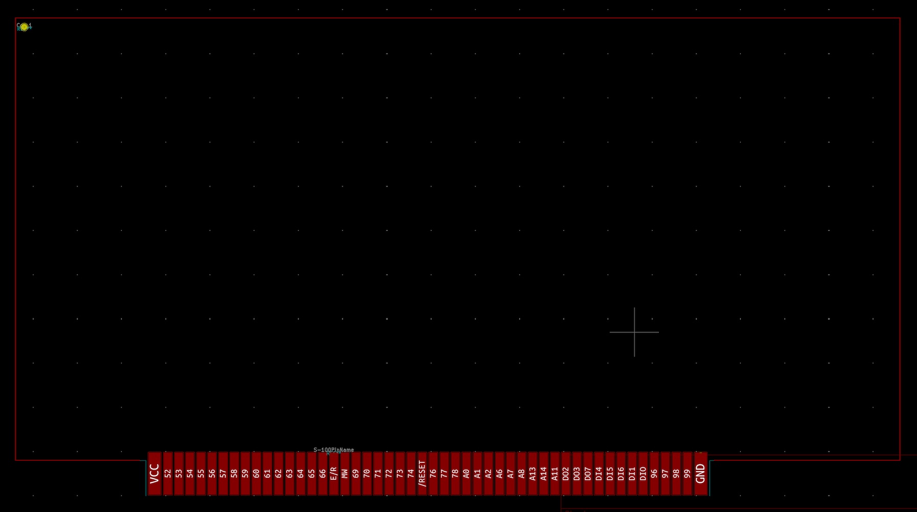

I don't use the KiCad library at all. It is far too large and filled with stuff I never even heard of and will never see, which makes it difficult to find something as simple as an ordinary transistor. I made my own user library gradually over the years to fit my own needs. For my cards, S-100 and S-86, I start with a template with the size of the card outlined and the full pin rows at the bottom filled with labels. Then I fill in the blanks, so to speak, with whatever I am designing.MajorClements wrote:

I also have pre-made templates that have the buffer and driver ICs that are common to many cards already in place. The advantage of this is that that part of the design has long since been tested and I know that everything is correct.
But, as to being new and confusing, it is an art as much as a science. My first products back in the 90s were so laughable that I wouldn't show them to my nerd friends. They had more rework wires than card copper.
But it was, and is, fun.
