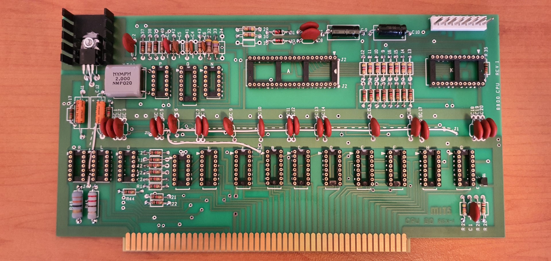

The CPU board is built. I made sure I triple checked every component and connection while building it. Thanks to other users on this forum, I was able to view some high-res pictures of their CPU builds which helped a great deal. Thanks also to Shadowtron Blog Youtube channel for demonstrating the build and providing some good test procedures. Once my build was finished, I followed the same test procedures and all voltages checked out. I then inserted all the chips, plugged it in to my original Altair and what do you know, it works!

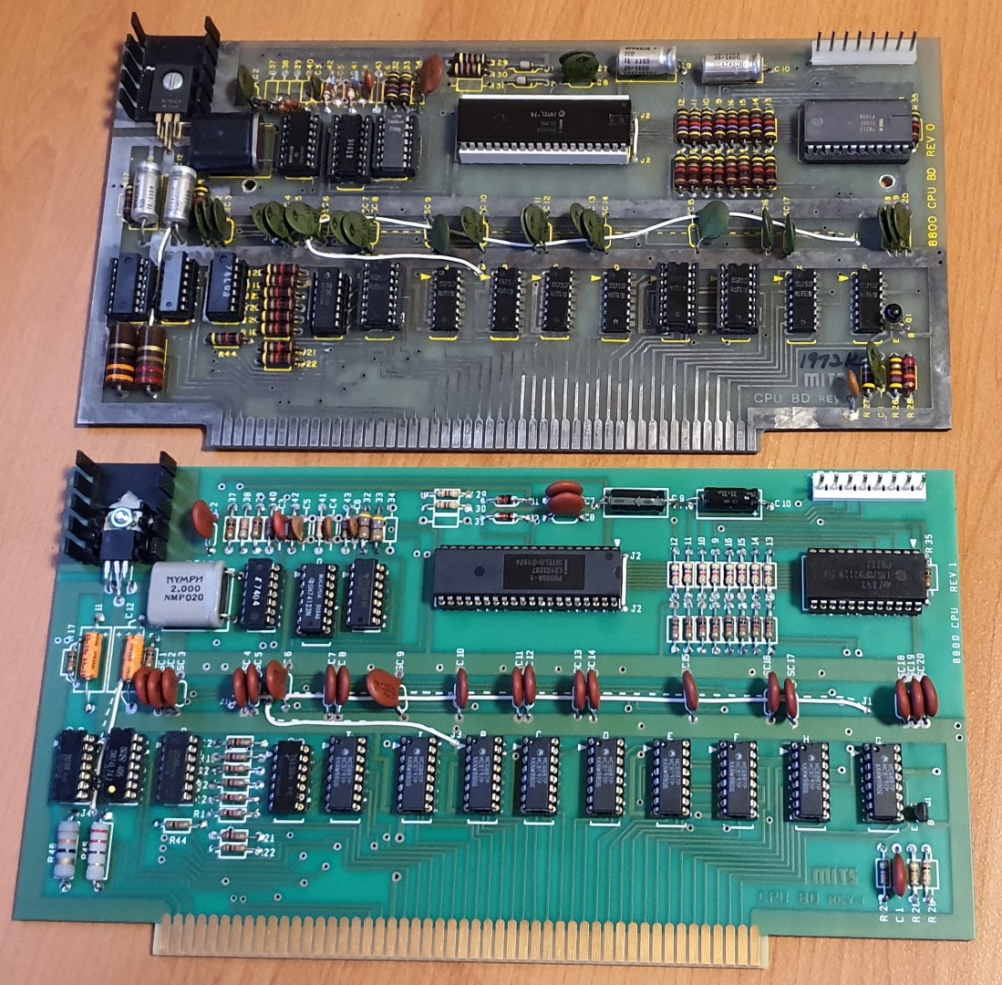

Here's a comparison pic of the reproduction CPU along side the original. I'm amazed that the original CPU board still works. The silver caps are showing signs of leaking. Now that it's out of my machine I'm going to replace them.

Definitely a good idea to replace those old electrolytic capacitors. Tantalums too. Swap 'em all, if they're old. They're really the only high-failure rate components. Other types of caps last forever, but not electrolytics.
