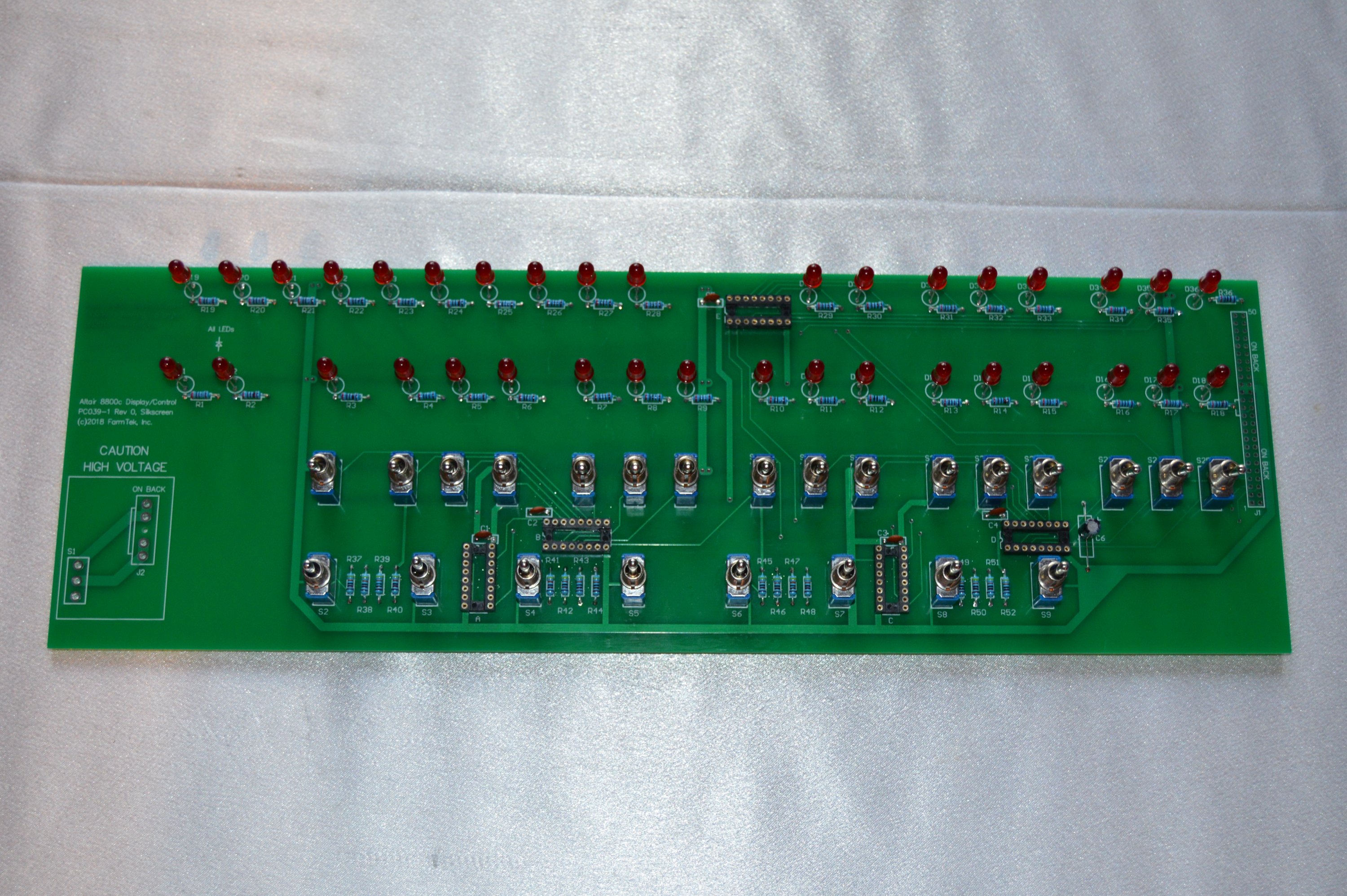

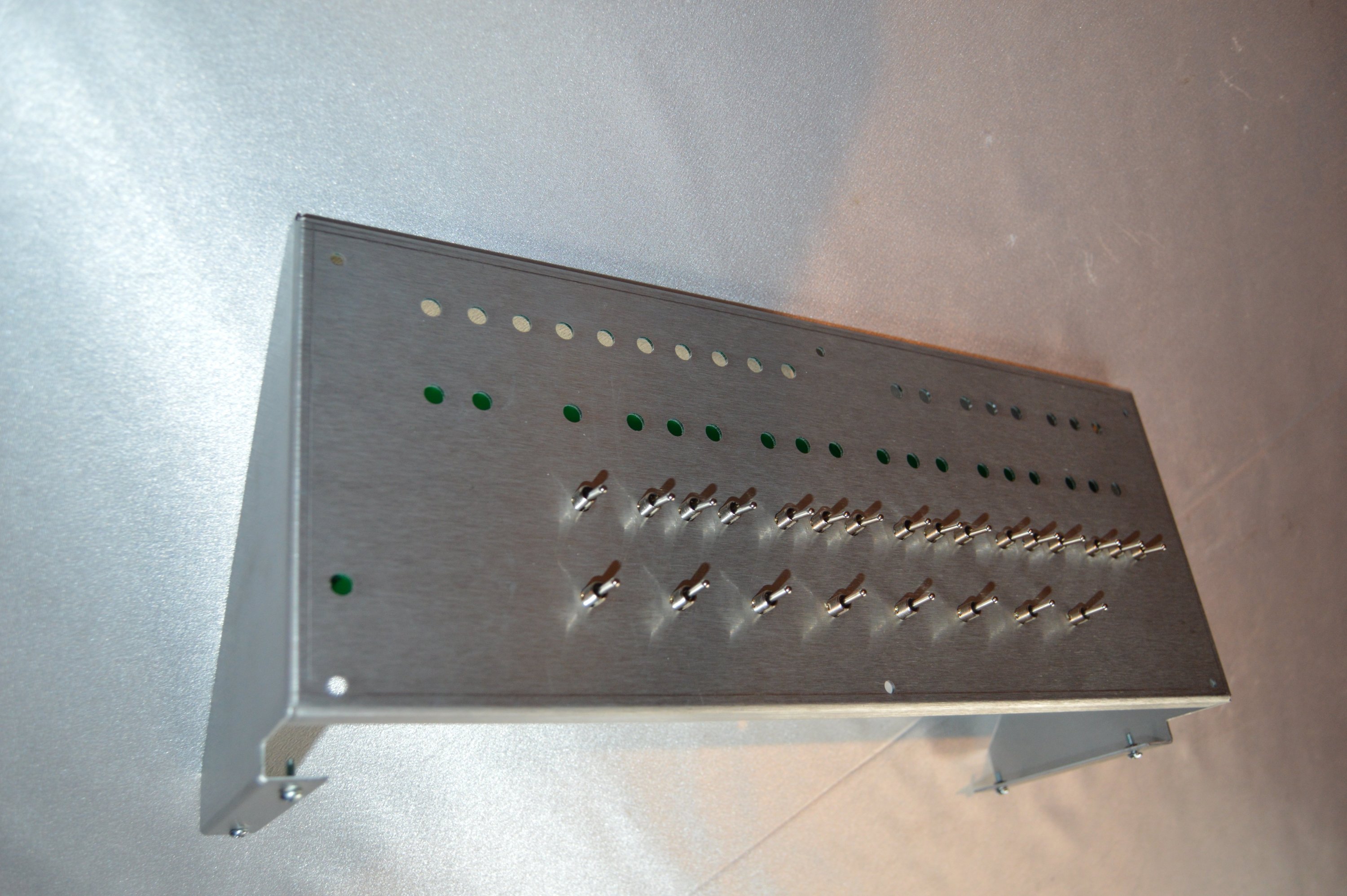

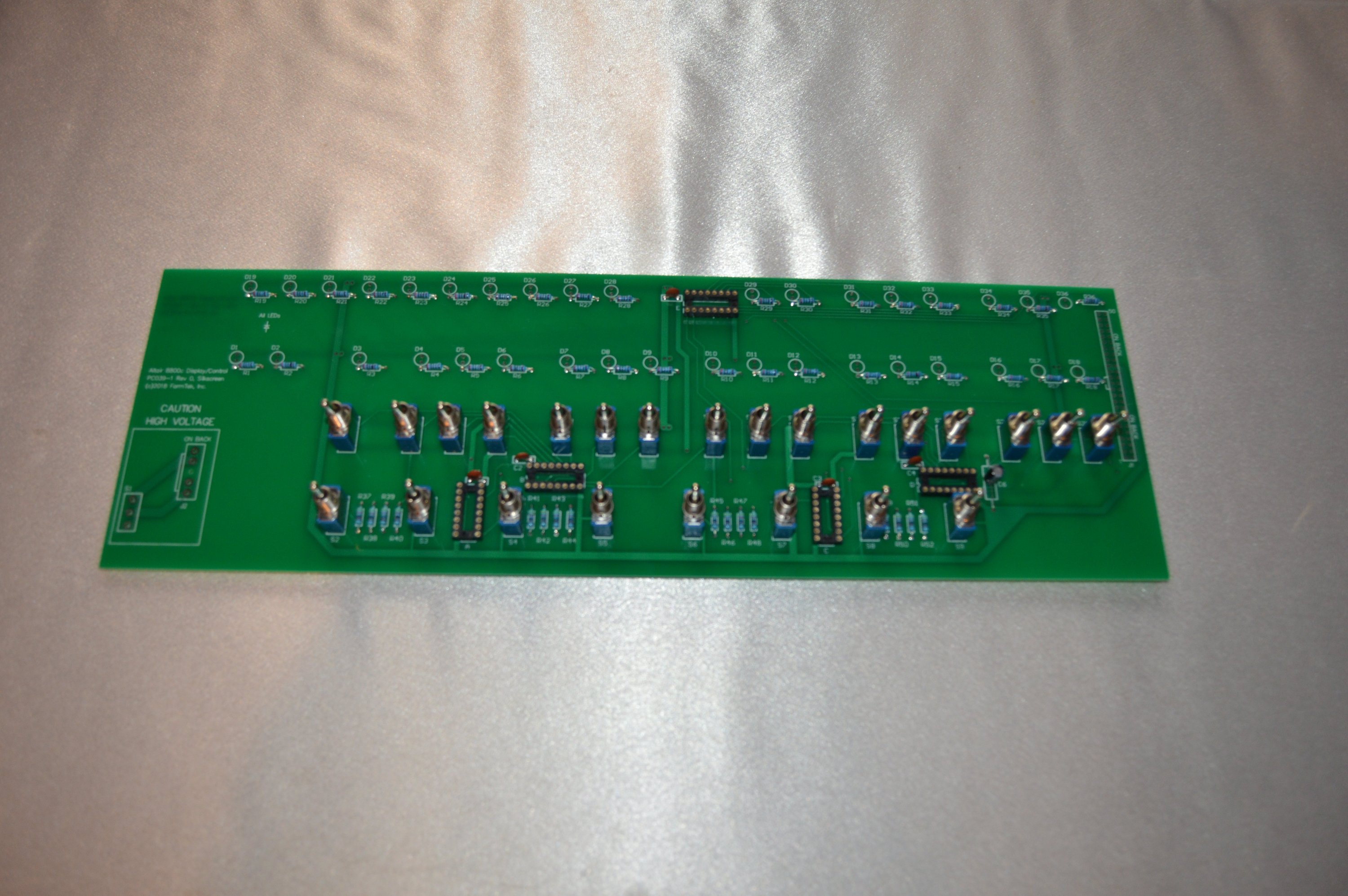

First, the front panel. I soldered the resistors, capacitors and chip sockets onto the front panel board, just as Mike's instructions show. Then I used the front panel mounting bracket as a jig, again, as per the instructions. I used four flux remover spray can lids as supports for the bracket, and set in place all the switches. All the switches except the power switch, that is, because it hasn't arrived yet.
One things I noticed - before soldering - was the switches have a slot in the threads. At first I had oriented all the switches with their stamped part numbers all on the same side. But this made some slots on the top and others on the bottom. So the stamped sides aren't uniform. No big deal, just something I noticed. I looked at Mike's build of my clone and saw that he had arranged all the switches with the slots towards the bottom. Nicely done, and I did the same. It looks better that way.

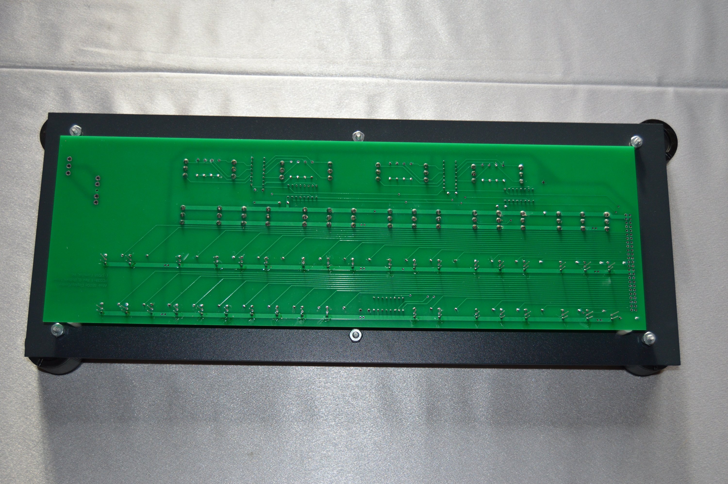

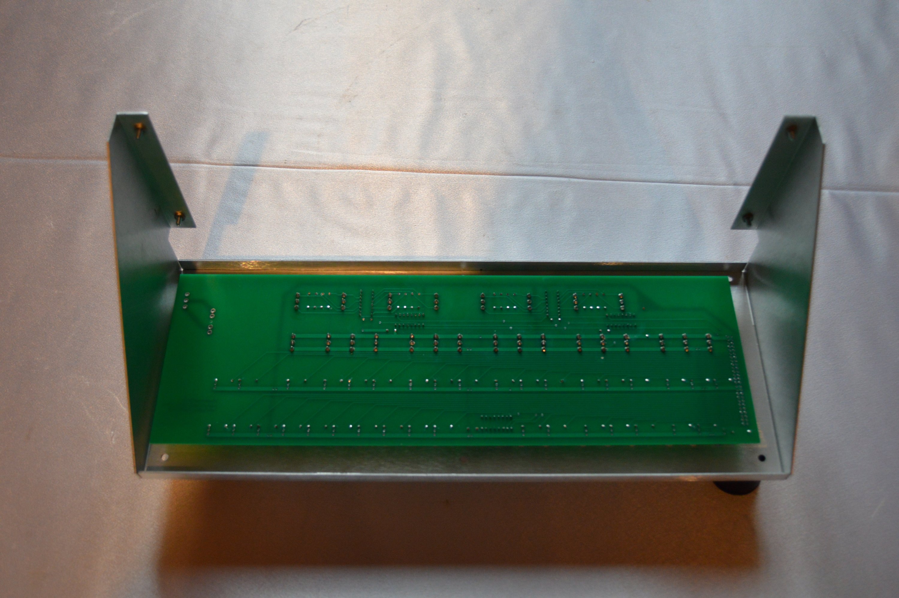

Once I soldered all the switches in place, I flipped over the mounting plate.
Next, I'll add the LEDs. That's for another day.

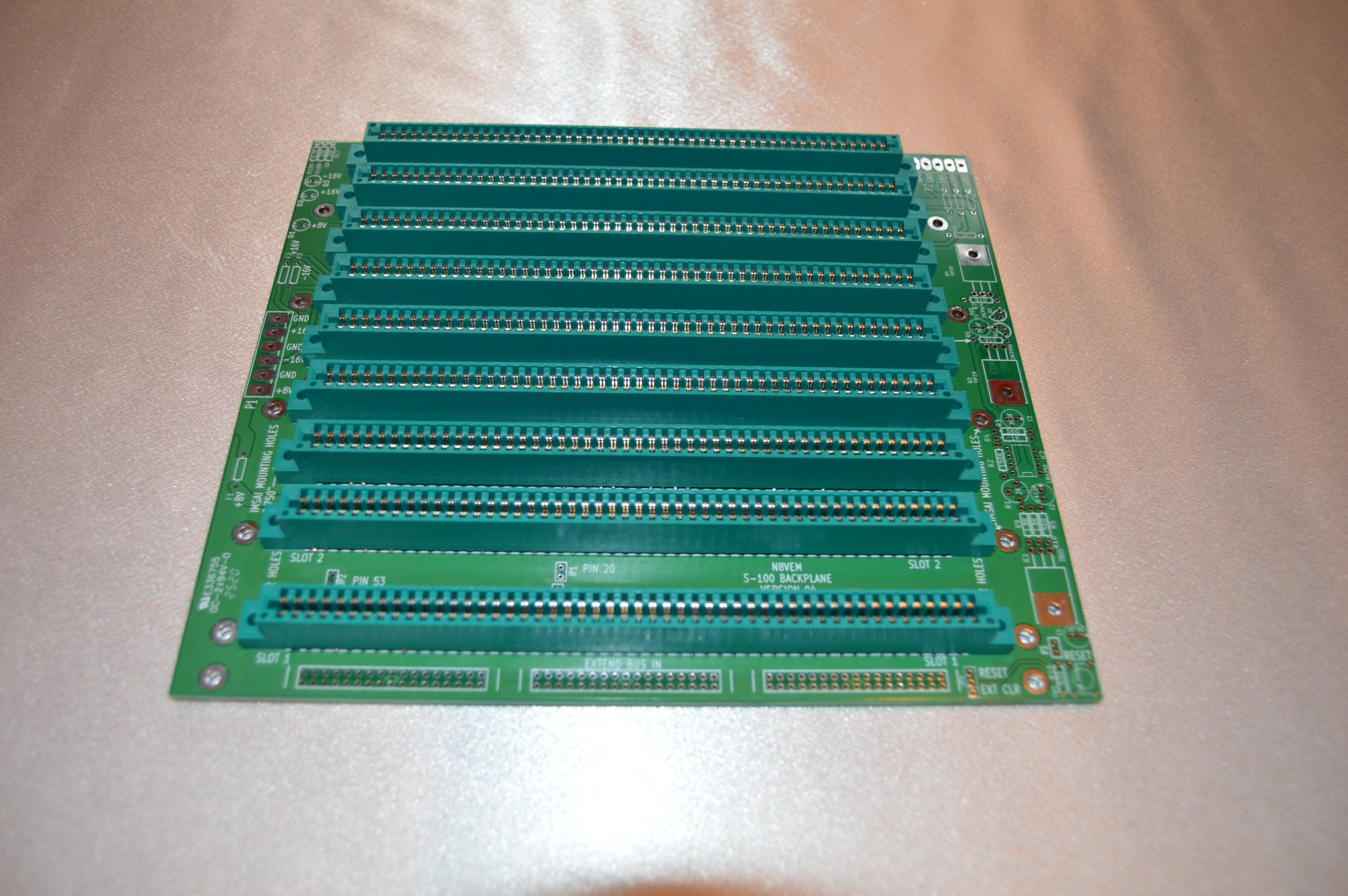

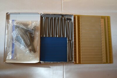

I got the 9-slot backpanel and connectors from Todd Goodman. I also got a few unpopulated S-100 boards from him, but they're projects for a later date. I haven't added any components to the backpanel yet except the edge connectors.

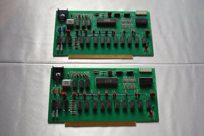

And of course, the processor board. I bought a couple Altair 8800 CPU boards from Gary Kaufman. Only one is needed, of course, but I think it's good to have spare boards because it makes troubleshooting so much easier as time goes by. If something breaks, I can swap boards to find the defective board, and then swap chips to find the defective chip. Just makes maintenance easier.

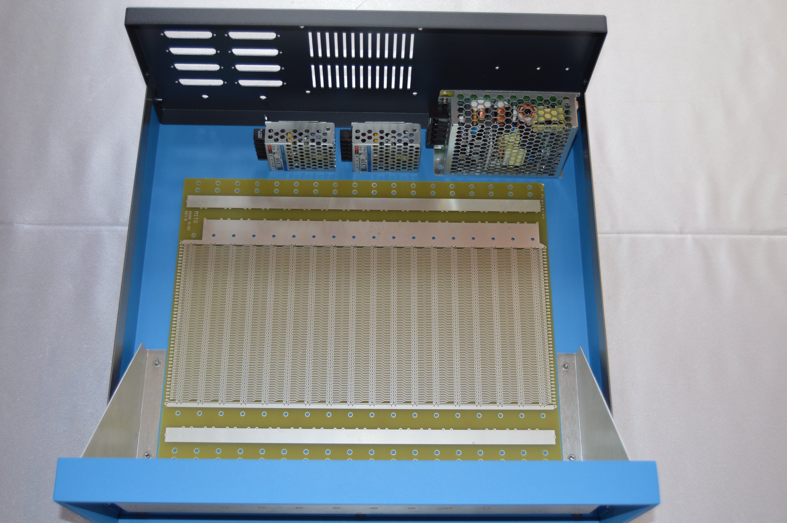

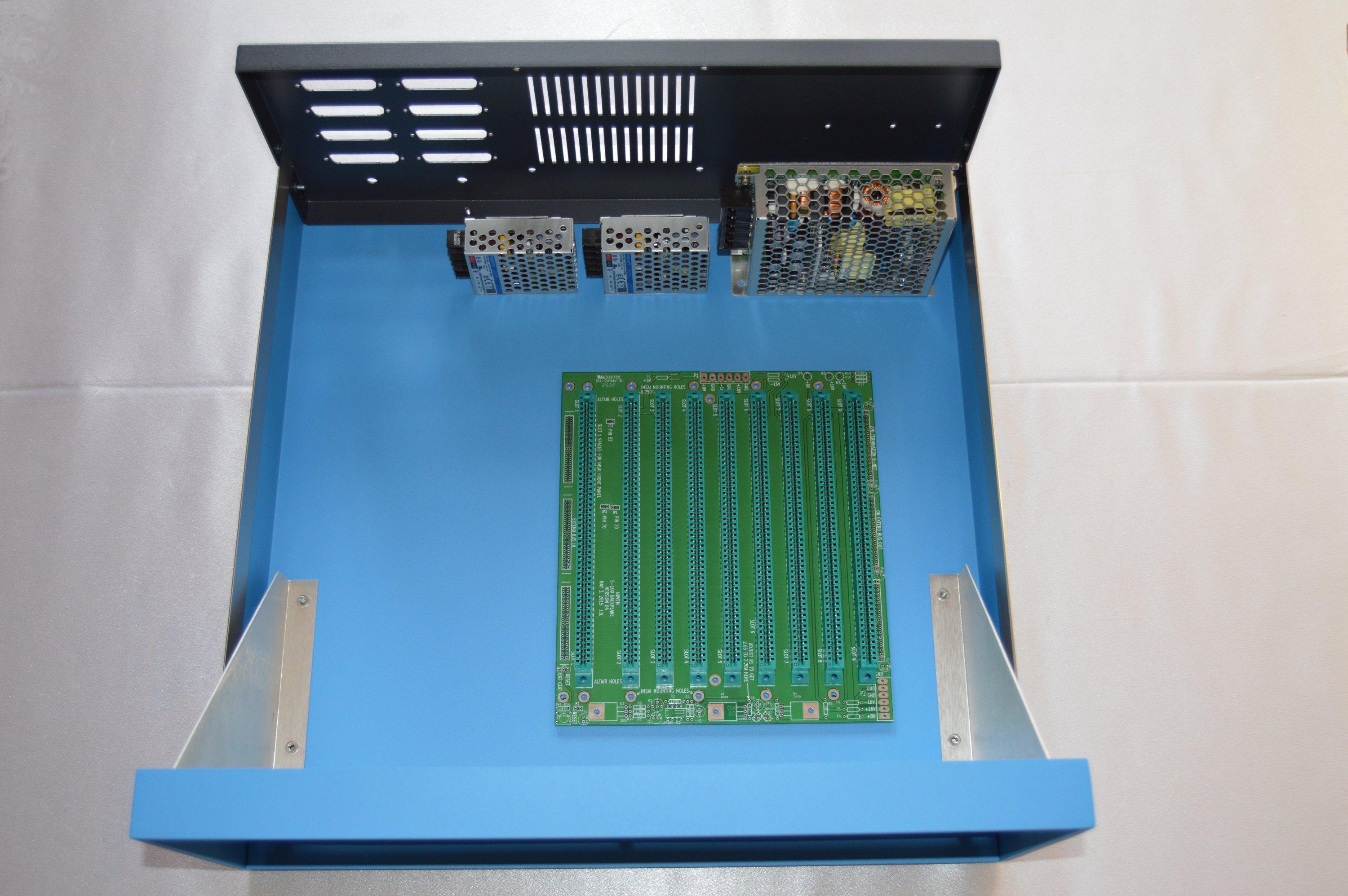

Both appear to fit, but obviously the 18-slot takes up more space. It pretty much covers the whole inside. That's not a bad thing as long as I don't run into unexpected gotchas. Isn't that always the case?!!
Here's the test fit of the 9-slot backplane. Lots of room for that guy.
And here's the test fit with the 18-slot backplane. Pretty much fills the cabinet side-to-side and front-to-back.
Questions for the group:
1. Does my power supply layout look OK to you guys? I think there's enough room for the fan, although I still need to confirm that. I don't really like it blowing over the little 16-volt supplies, as I doubt they'll need the cooling. The 8-volt unit would more likely need the fan. Then again, the shorter 16-volt supplies would allow flow over them and into the card cage. At least the middle boards would get some flow. What do you guys think?
2. This is a dumb question that really falls into the RTFM category, but I don't have a manual or schematic so I'll have to look around and see if I can find one. My question is do those switching supplies tie their chassis ground to any of the output lines, perhaps their negative outputs? I assume not since we're hoping to make +/-16 volts from the little pair of 16-volt units. I'll double-check with a meter, but I'm thinkin' you guys probably already know.
3. Unrelated to layout: I'd like to punch a hole in the cabinet rear panel opposite the DB-25 connectors to fit connector(s) for the disk drive(s). I read the suggestion to run the ribbon cable out the back, sliding it over the rear panel and just under the cabinet top. But what do you guys think about adding a connector or two for disk I/O on the rear panel?
4. Is there anything else you guys can see that might hang me up? Any preferences of backpanels? Any other advice?

Thanks for the photos! I have an 8800c but I was hesitant to order the 18-slot board in case it didn't fit. Now I know it'll work fine.
1. I have my power supplies arranged just like you do and have no problems.
3. I have my disk cable laid over the edge of the back panel. The cover doesn't crimp or otherwise interfere with it.

No, the switching supplies themselves do not tie chassis ground to any of the DC output terminals.

With the modern cards you have (Mike's and Martin's) you certainly don't need the 18 slot MB unless, of course, you intend to try some 1970's cards. The shorter MB will be inherently less trouble electrically speaking.

Thanks for telling me the supply outputs are isolated from chassis ground, Mike. The supplies will be super-easy to install and connect. I like the old transformer rectified and filtered supplies - they're so simple - but I like the light weight of these little switchers.
On the backpanel, I definitely hear you Bill. I was worried about the same thing, and wondered if the signals would be clean enough with resistive termination or if the buss was so long it just had too much reactance to damp. I haven't studied enough to see what kinds of termination are used. Just glancing, it appears some use no termination at all - just whatever loads the boards provide - others add termination. So I'm guessing that big backpanel would probably benefit from a terminator.
Seems like I've seen 270Ω resistors used, both to ground and to +5v, making a voltage-divider that sets an unloaded line to around 2.5v. That would damp both current sources and current sinks. Might try something like that.
Then again, as you've said, there's really no need for 18 slots. Now days you can do everything with four slots leaving as many more open for extras. So I might just use that 9-slot board.

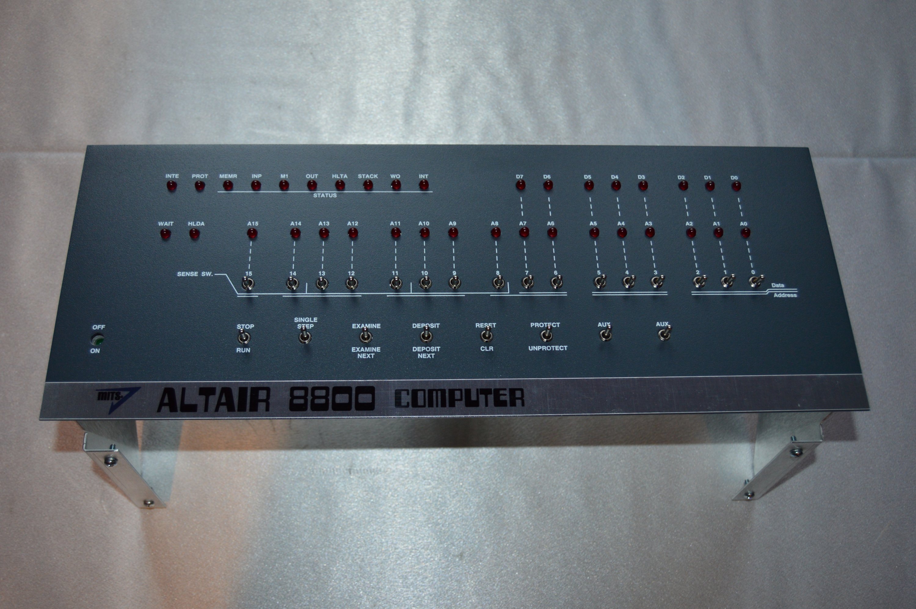

I had a little time this evening, so I decided to solder on the front-panel lights.
I pretty much just followed the directions, which worked beautifully. Inserted all the LEDs and then pushed the front-panel board onto the front face. Then placed the 5/8" spacers to set the spacing and soldered one lead on each LED. That way if I needed to adjust any of 'em, I could do that pretty easily. But all appeared to be sitting just right.
I "hosed off" the board really well with flux remover. I know I still need to solder in a couple of connectors and the power switch, but there's no telling when I'll get around to doing that. I don't even know when I'll get the power switch - It's on backorder. So I wanted to go ahead and clean the board because sometimes flux is harder to remove when it has sat a while.
Now to do the final test-fit of the front-panel board on the chassis mount including the front face. I just "finger tightened" a few of the nuts to see the results. I also wanted to put it all together because it may be a few days before I get back to it, and having it assembled will prevent the LED leads from getting bent.
