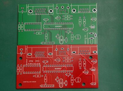

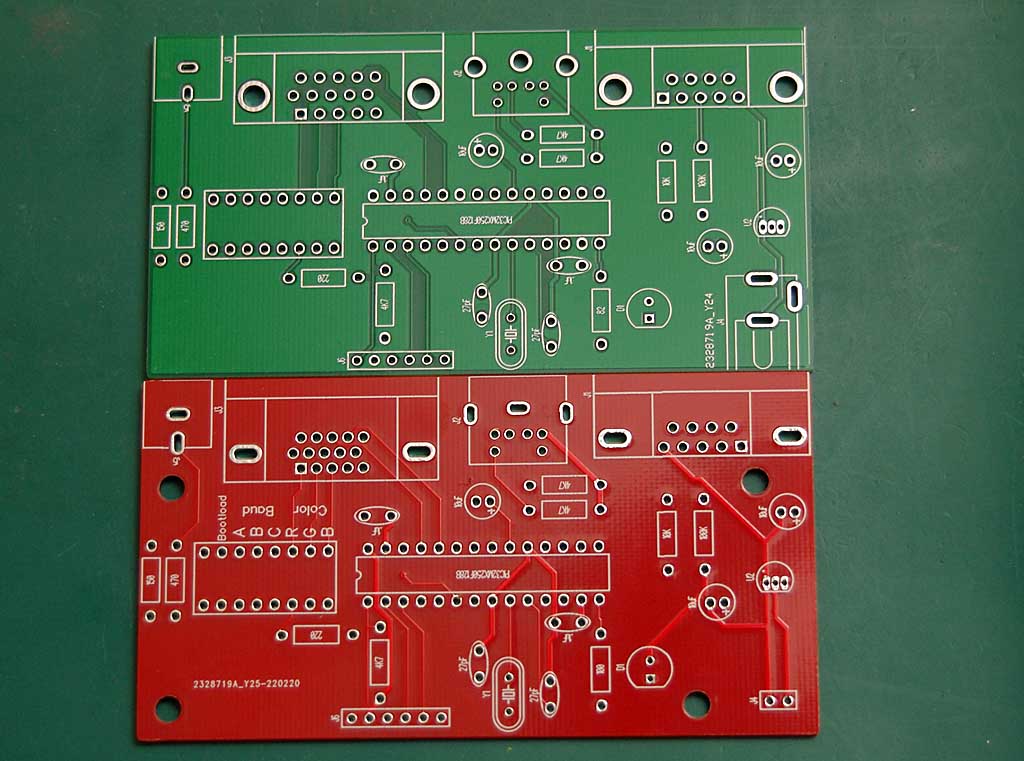

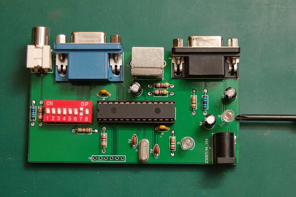

The green board is version 1 and the red board version 2. There will be a version3 at some point.
The changes from version 1 to version 2 are as follows. On the first try I had the com port set up as DCE. However, my 8800C is also set up as DCE so I went with DTE on version2 so I could connect up with a simple strait-through cable. Also I buggered up the VGA and to some extent the PS/2 keyboard connector patterns in the first version so for version 2 I improved all the connector patterns. I also changed from a barrel power connector to a .1” Molex, spiffed up the silk screen a bit, added mounting holes and dropped the copper pours.

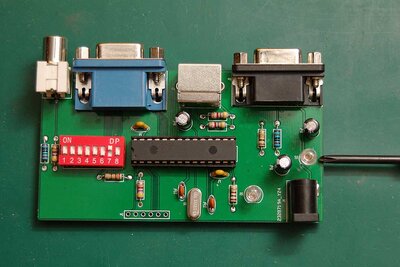

Here is V1 built up. Note the screwdriver pointing to an LED. I used a red LED to drop the 5V input to 3.6V for the PIC chip as I didn’t have any 3.3V regulators knocking around.

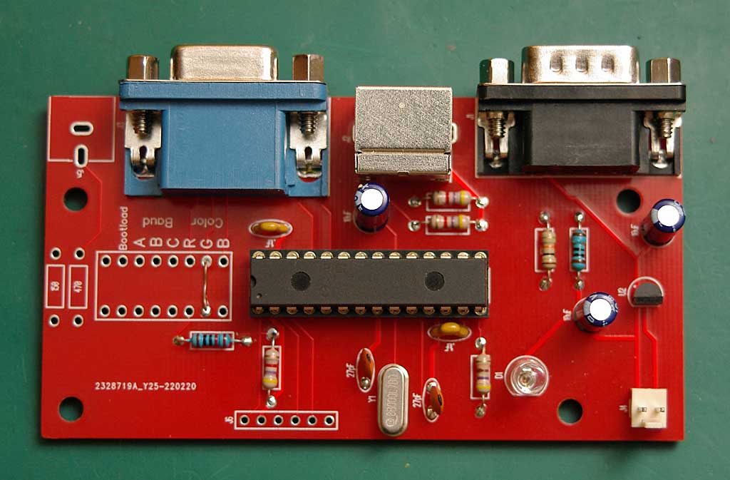

Here is my V2 build. Since this is not the final design I just wired it for green color rather than use a dip switch. This time I had 3.3V regulators.

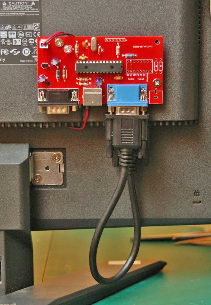

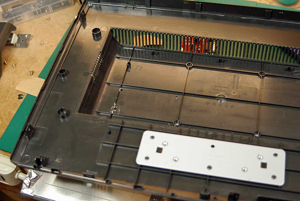

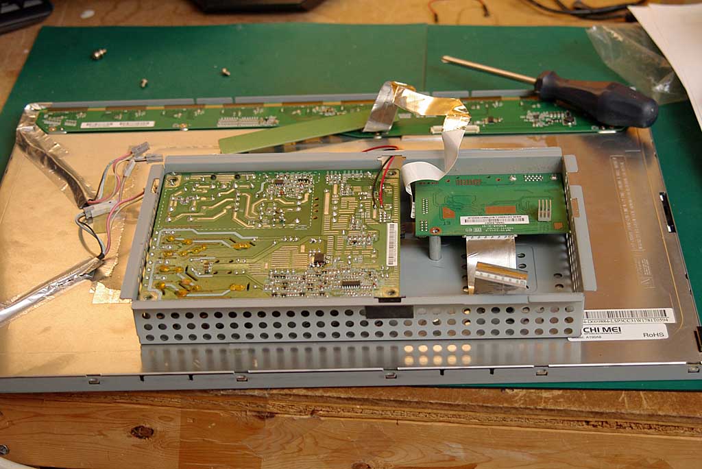

The backs of these monitors usually have some structure moulded into them for strength that leaves lots of space for screws with which to mount the board on the back.
Here it is all ready to go. I used a short (1’) VGA cable to keep things a bit tidier.

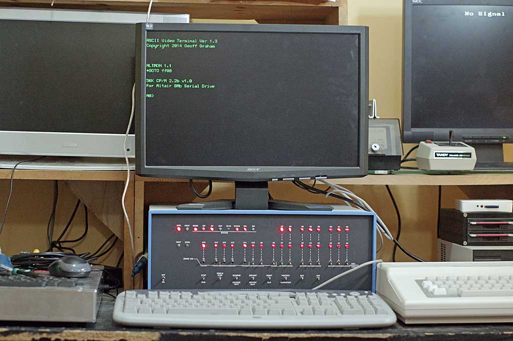

And here it is in use.

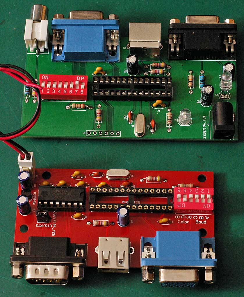

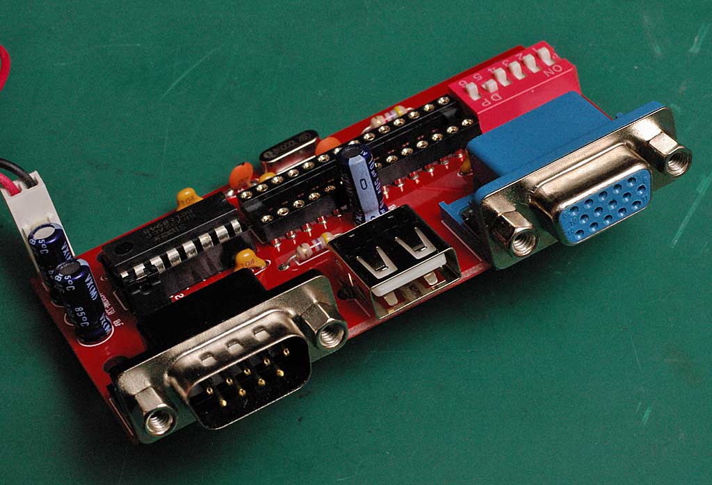

The version 3 boards came in on Friday and I built one up .. only to discover that I misplaced my PIC32MX250f128b chips. Spent all weekend looking for them. Sigh! Anyway, I have some more coming from Digi-Key. I'm sure once they arrive I will be tripping over the ones I misplaced.
So, here is what it looks like:
Of course, at his point in time it is untested.
However some things of note:
It is considerably smaller
It fully supports the RS232 standard
It uses wired USB keyboards which are far more available than the PS/2 style.
There will probably be a V3.1 as I have already discovered little things about this that I'd like to change.
I'll update when I get to test it.
