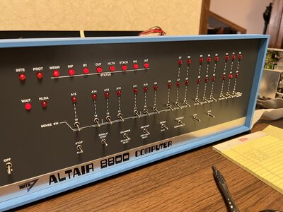

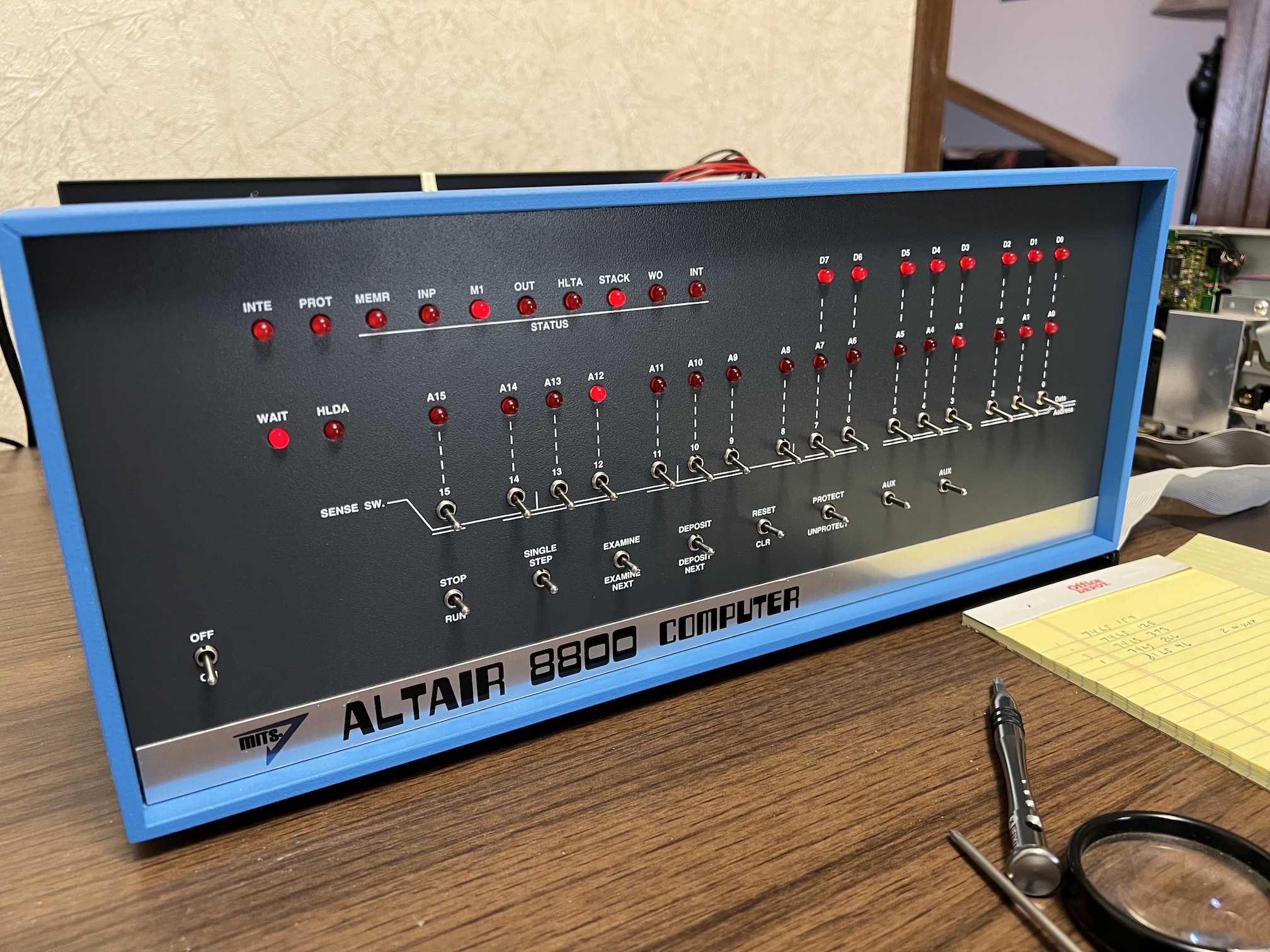

Update. Finally got the chips to reload the Compupro RAM 17 board. I also went back through and resoldered any suspicious looking spots on the 8800 front panel, front panel controller, and 8080 cards. Not much changed as a result. When I turn it on and do a stop/reset I get this:
After waiting 5 minutes or so and repeating the stop/reset, I get this:
D4 seems to be stuck on, also A1 intermittently. I don't know of those bits are actually stuck or not. I can load code into memory, such as as simple add routine. The examine switch works, but clicking it continuously seems to jump around in memory at random. Examine Next seems to work okay. Clicking Single Step seems to light up a lot of address lines, and I can't tell if it's actually going through the program. Run lights up everything but INTE, PROT, WAIT, and HLDA, plus A15 and A14 are flickering.
