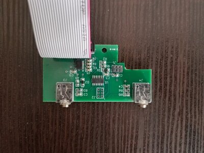

Depending on the motherboard standoffs used, the cassette interface circuit board may need trimmed. Where it needs cut there is no circuitry, and the cassette interface has been tested working after cutting off this piece of its circuit board, like so: Like COM1 and COM2, the ribbon cable for the cassette interface reaches where it needs to go, but it is recommended to extend it.

There's enough room beside each 3.5mm audio jack for the "TAPE PLAY IN" and "TAPE RECORD OUT" stickers, and enough room under the PCI cutouts for the Altair Clone's serial number sticker. The serial number sticker is known to lose its text during transfer, so be careful.

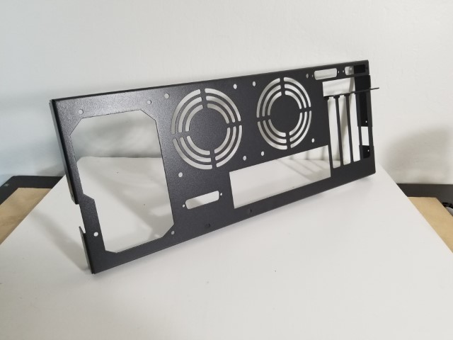

20mm motherboard standoffs MUST be used. This allows room for cable management and, more importantly, leaves room for the Altair cassette interface. It is recommended to use female-on-both-ends standoffs to gain wiggle room during installation.
The ATX power supply is very close to the plate mounting holes on that side. Standard 1/4" #6-32 case screws will fit without touching a power supply.
There are cutouts for two 92mm cooling fans. It was designed to allow installation of an Asetek 645LT AIO liquid cooler in the cooling fan cutout closest to the ATX power supply. (well, it was designed for the discontinued 545LC, they have the same footprint though). A Hardware Labs Black Ice Nemesis 92mm radiator WILL FIT.... if you leave it and the power supply loose and tighten them both down at the same time. They WILL BE TOUCHING. There's one of them installed in one of the photos of the eBay listing.
The PCI cutouts are designed to use the edge of the motherboard as the bottom PCI anchors. So before tightening the motherboard down, ensure there's enough room for the bottom of PCI cards to slide between the plate and the motherboard.
If using a screwdriver, the PCI mounting screws are hard to get to with the DB-25 serial ports in place.

When I designed the plate I had provisioned a 92mm Asetek 545LC all-in-one liquid cooler to fit in one of the fan cutouts.
In December 2018, Asetek discontinued the 545LC. I was not happy. I purchased a Hardware Labs Black Ice Nemesis 92mm radiator and it does "fit", but mounting a pump and reservoir really started to get cramped.
UPDATE 7/24/19: Asetek has released the followup to the 545LC, the 645LT. It is the same size as the 545LC and fits on the backplate with a 2nd fan next to it with no issue.
So there are (at least) two options for liquid cooling with the backplate. Hardware Labs Black Ice Nemesis or an Asetek 645LT or possibly (UNTESTED) Alphacool NexXxoS XT45.
