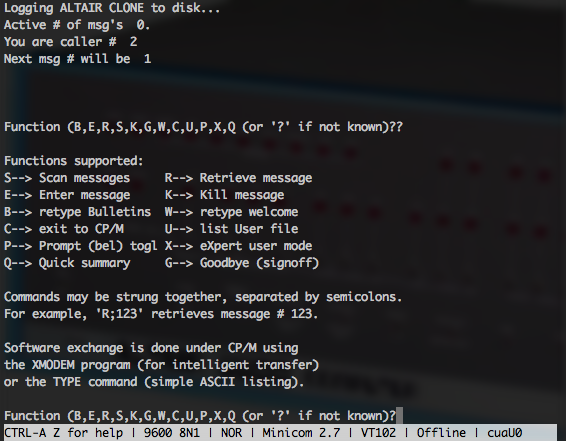

Hi all,
I had a bit of time on my hands so I wanted to see about getting a BBS running on the Altair Clone. RBBS seemed like the perfect choice since it is written in BASIC, and was designed to work with CP/M. I haven't done too much testing yet, but this seems to run as expected.
Be sure to check out the comments at the start of the source code to configure to your liking.
RBBS BBS running on the Altair Clone;
Next step, when I have time is to make this work over telnet.

Mike Douglas ported the BYE.ASM code to use a 2SIO port 2 with CTS Enabled. BYE.COM plus XMODEM.COM form a simple Remote CP/M (RCP/M).
I set up Telnet access and have a simple message system based in MINI-RBBS.
I downloaded the code for RBBS and will get set up to compile it. Adding RBBS to my RCP/M turns the system into a BBS
