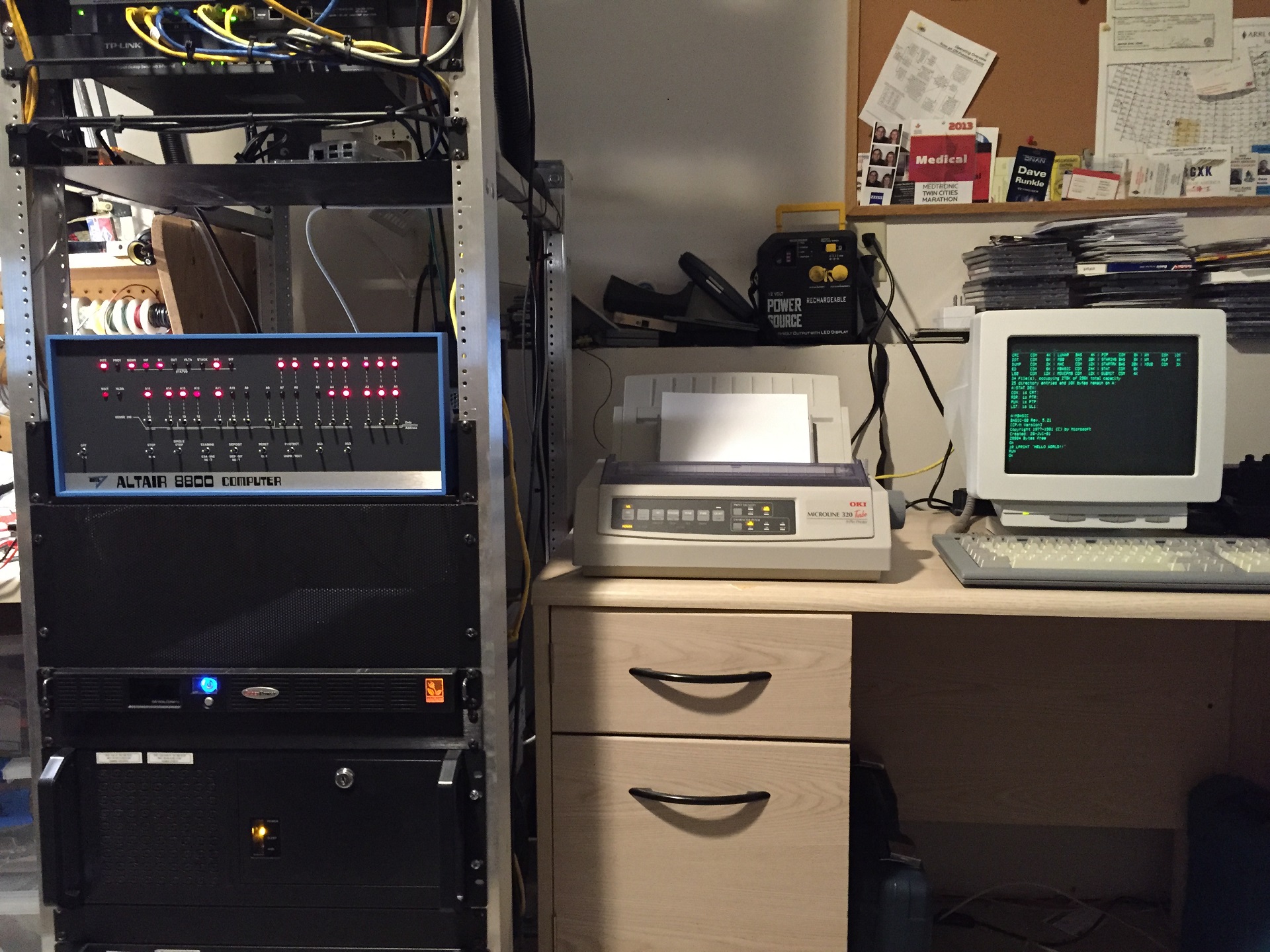

Thanks for the quick reply. I'm now up and printing over here. And more importantly, I have learned some new things.
My Altair CP/M 2.2B has been patched to have the correct IOBYTE set at boot up and a "virtual disk" has been saved.
Here is a pic of my setup now. Thanks again!
