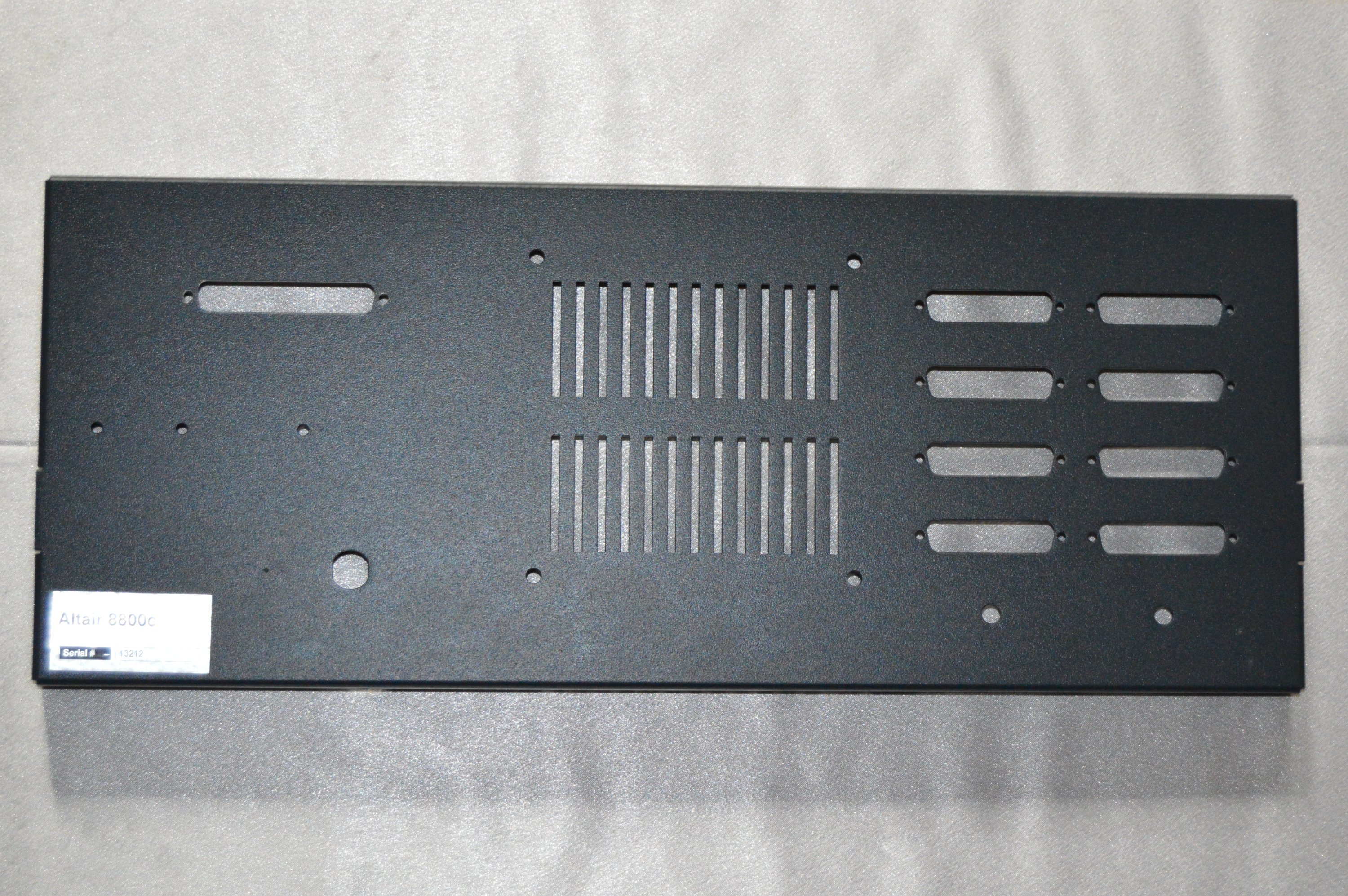

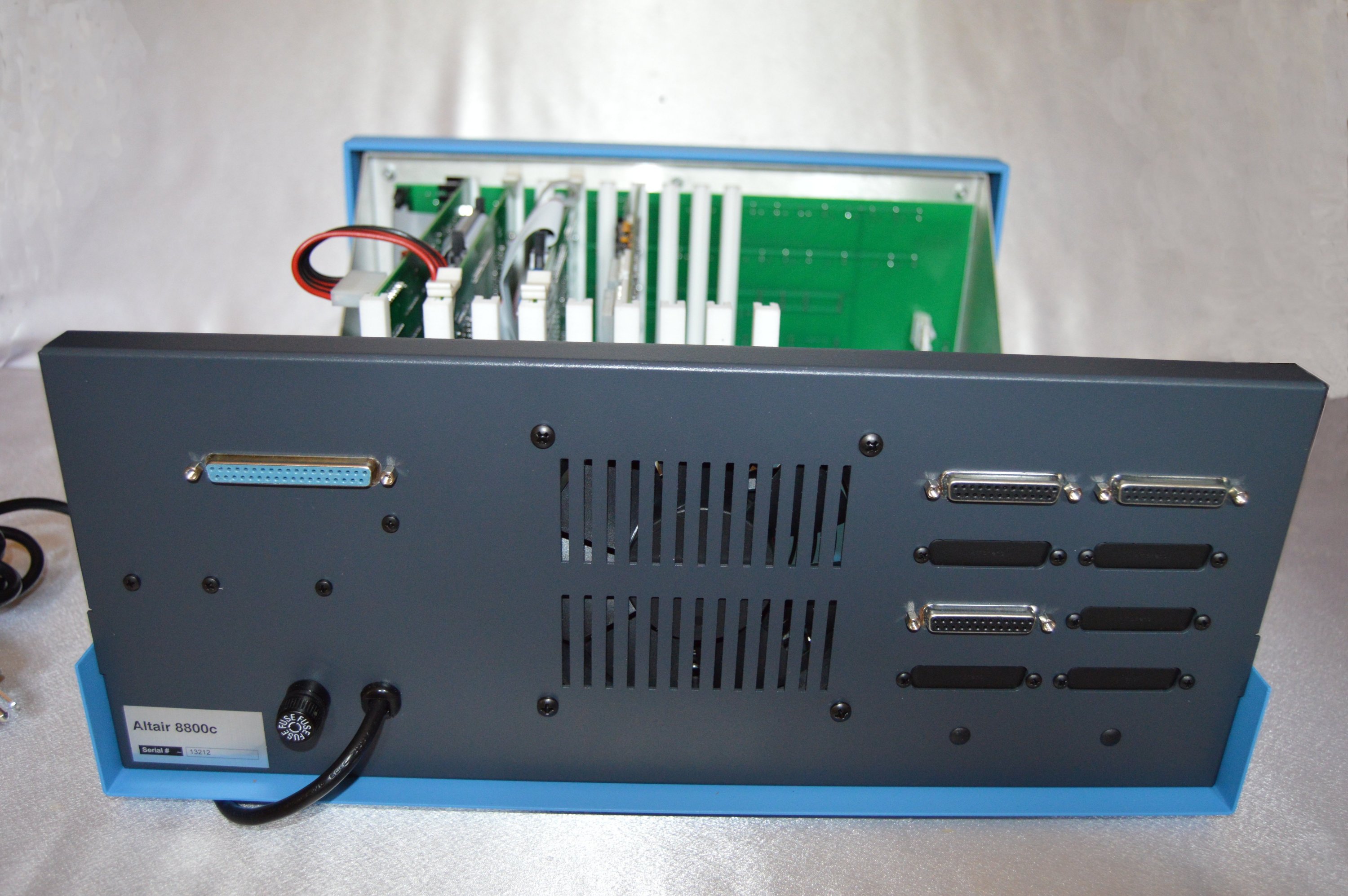

Here's the panel with the DB-37 cutout. I later drilled a 1/2" hole right beside the power cord for the fuse holder, and a 1/8" hole to mount the FDC+ diskette interface daughter board.
Rear panel with DB-37 diskette connector cutout
Ideal Specialty would have been happy to cut those holes for me too - and they could have cut the D-shaped hole for the fuse holder - but that didn't matter to me as much as getting the DB-37 cutout right. I knew I could drill round holes well enough. In fact, if you look closely at the photo of the panel above, you can see that I had already used a punch to mark the place where I was getting ready to drill the 1/2" hole for the fuse holder.

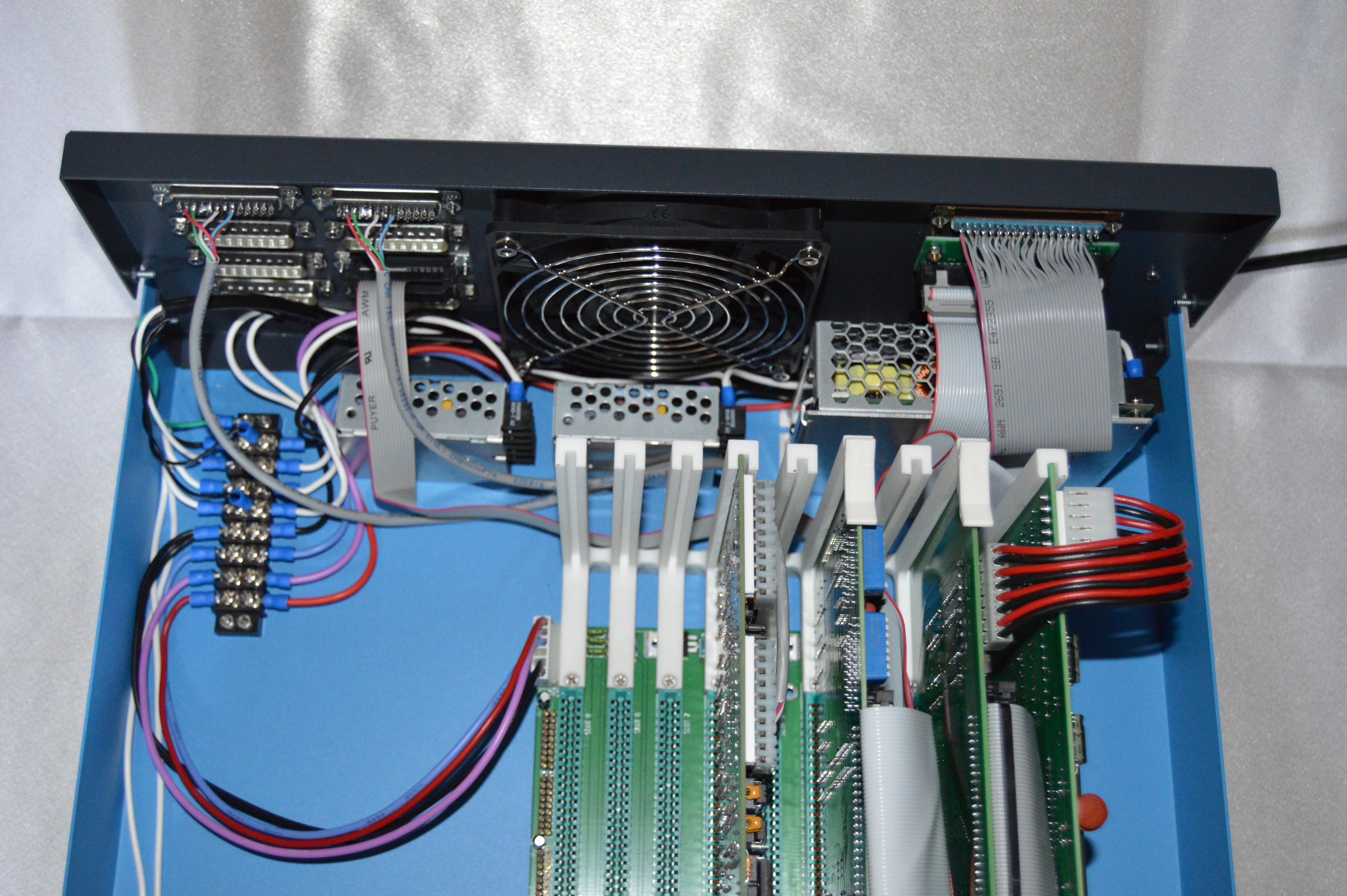

Internal wiring is nice and clean. The ribbon cables fold nicely to run between the slots and through the card cage, out to the connectors. The FDC ribbon cable connects to the 50-pin-to-34-pin daughterboard, which is mounted just below the DB-37. The DB-37 is connected to the 34-pin IDC too, straight through. It could have been done with a ribbon-crimp style connection - which I did on the 34-pin side - but I soldered the 37-pin connector.
Internal cables
Internal cables
You can't really see it, but I've attached the FDC+ serial connection too. When looking at the system from the rear, the top two DB-25 connectors are the 88-2SIOJP ports. And the DB-25 that's on the third row down is the FDC serial connection. All the rest of the DB-25 holes are plugged.

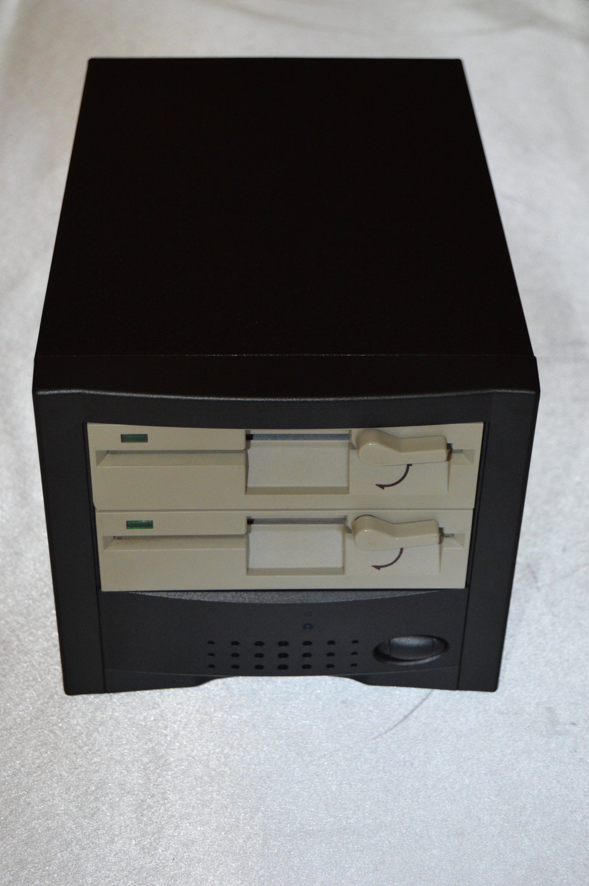

I mounted my diskette drives in a case shown in the "Floppy Drive Enclosure" thread. There are other good options, but this case worked nicely for me.
Diskette drive
Diskette drive
I considered masking the drives and painting them black to match the case. I could have masked the select-indicator LED and the electronics and applied an adhesion promoter and paint. Might still do it. But I noticed that the early low-density drives were usually black and the later high-density drives were usually tan. I remember that color shift, but didn't really pay attention to the fact that it tracked with the density shift. Not that it really matters, but it pushed me towards leaving the drives alone. Besides, I had bigger fish to fry. The drives looked fine.

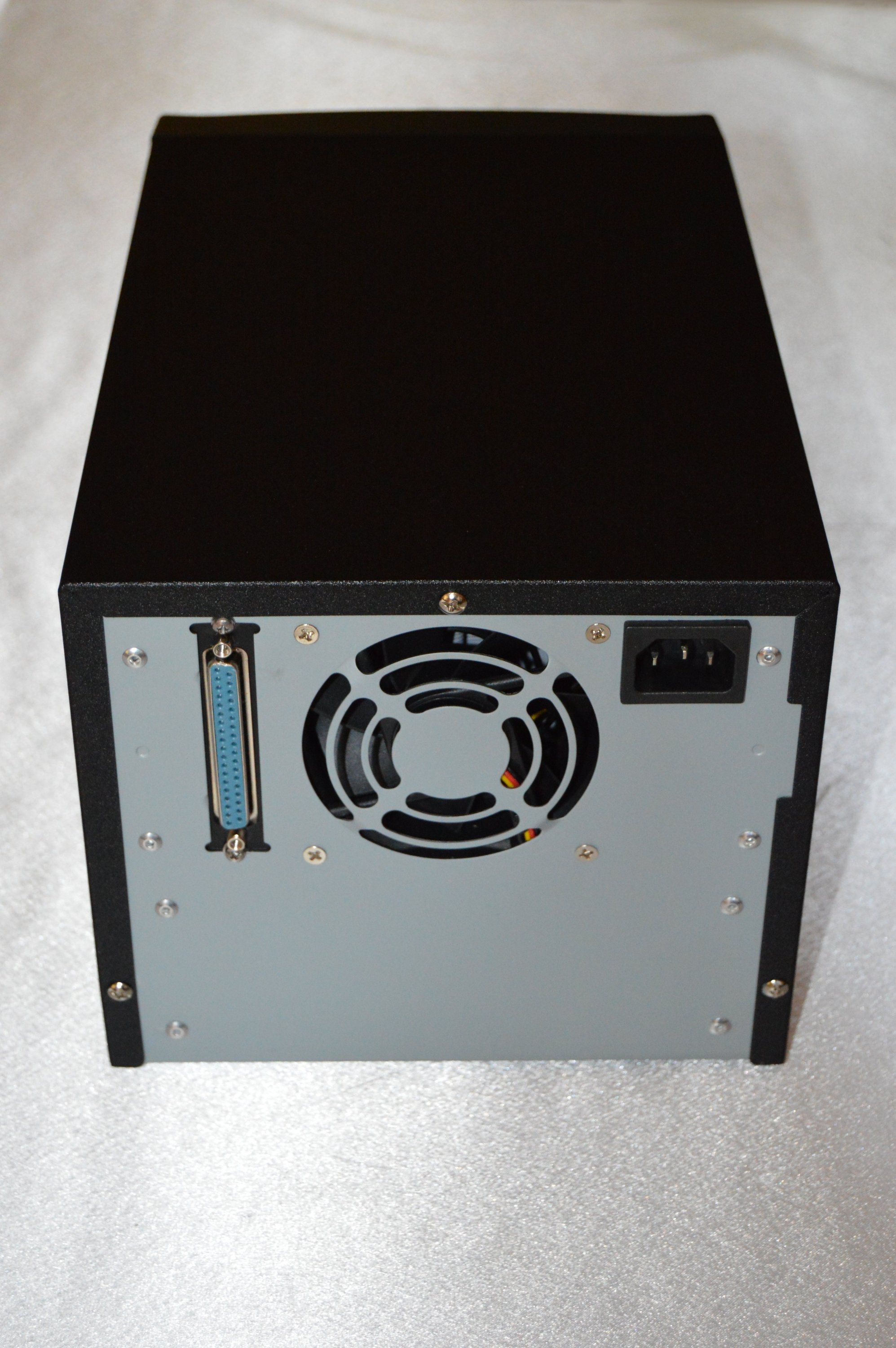

Rear panel of drive cabinet

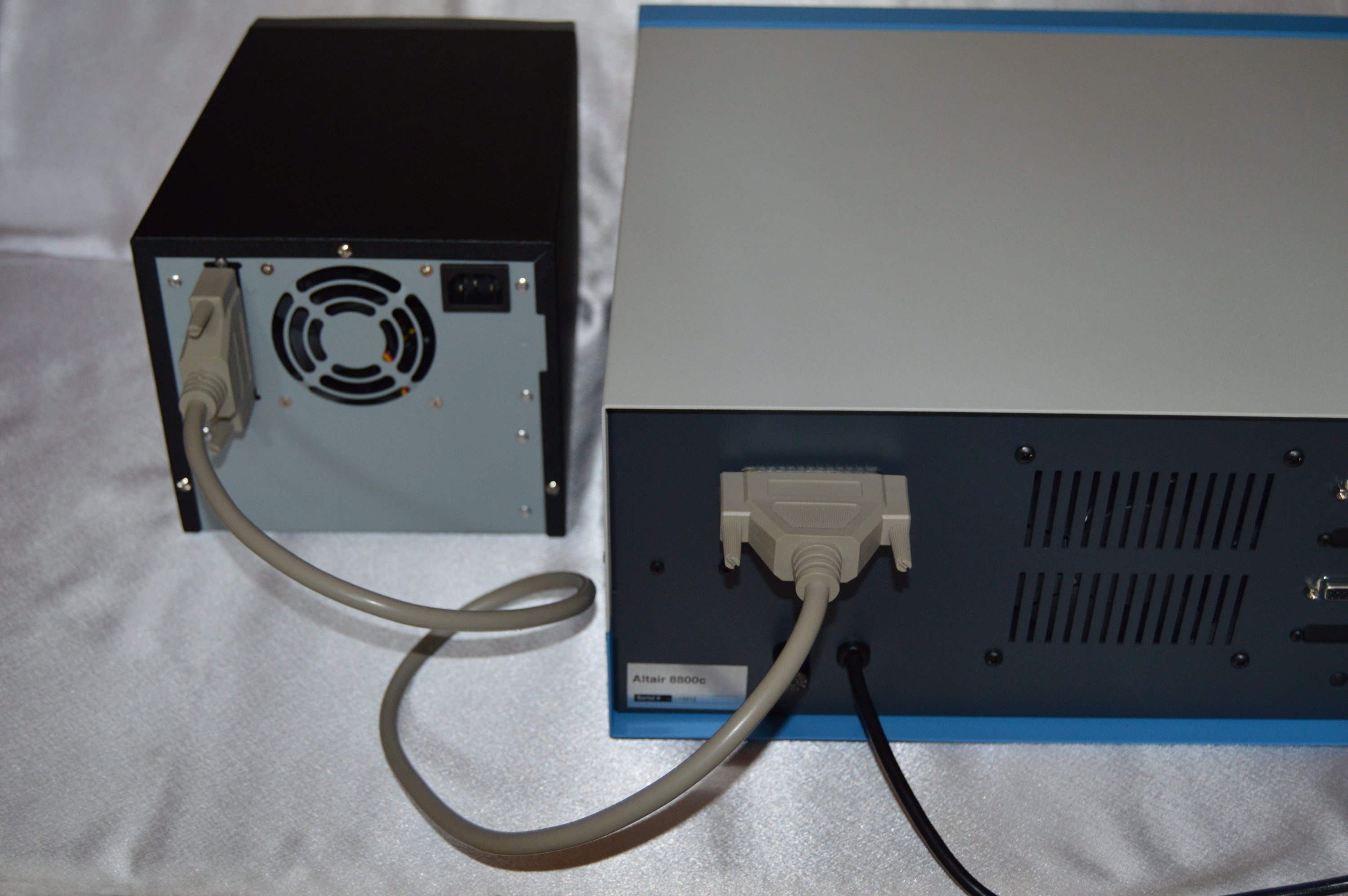

Here's why I really went through all this. I wanted to have DB-37 connectors between the CPU and the diskette cabinet.
CPU and diskette drive connected
The connector cable is a three-foot DB-37 straight-through cable. They are still readily available, as are five-foot variants.

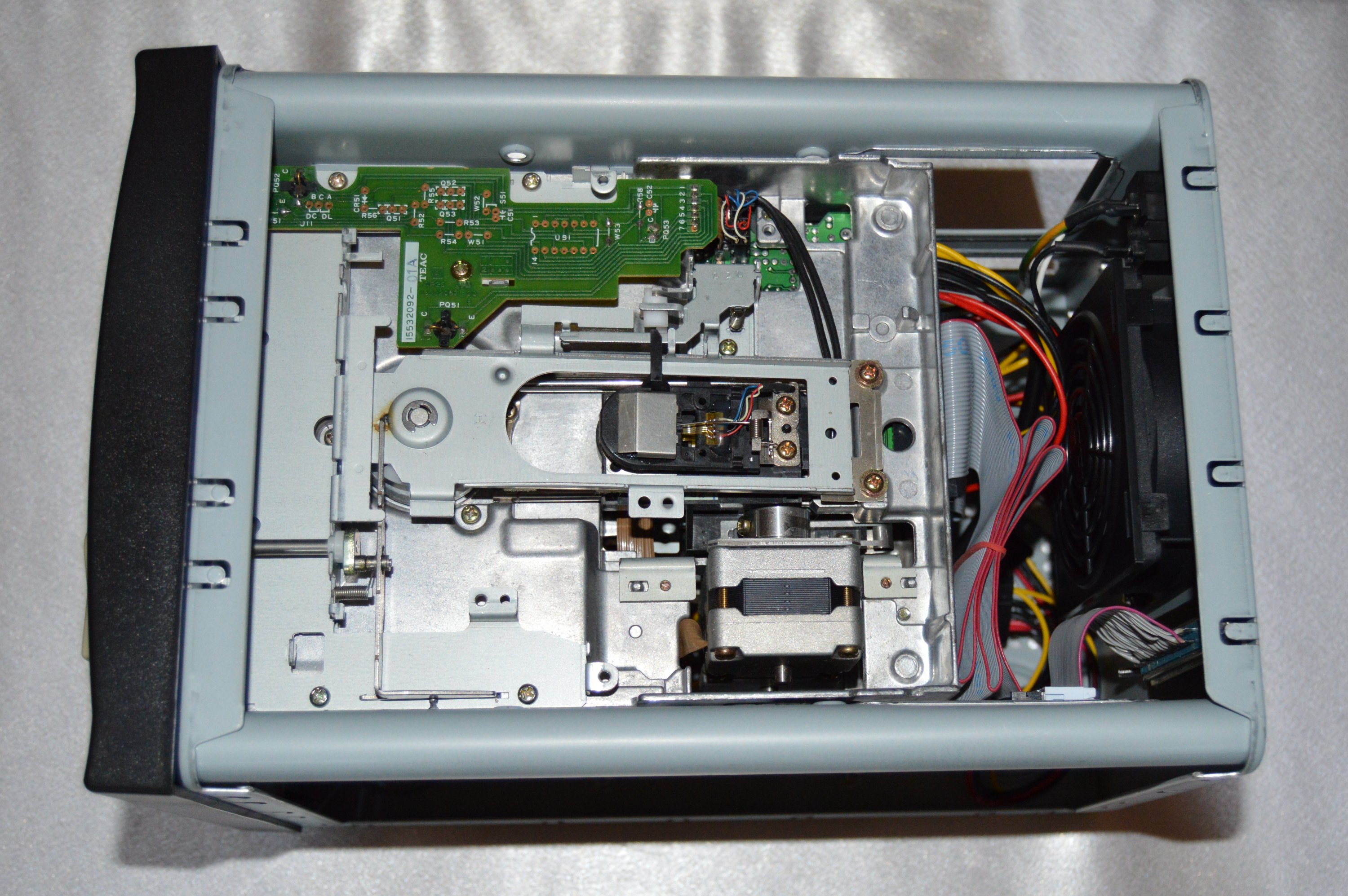

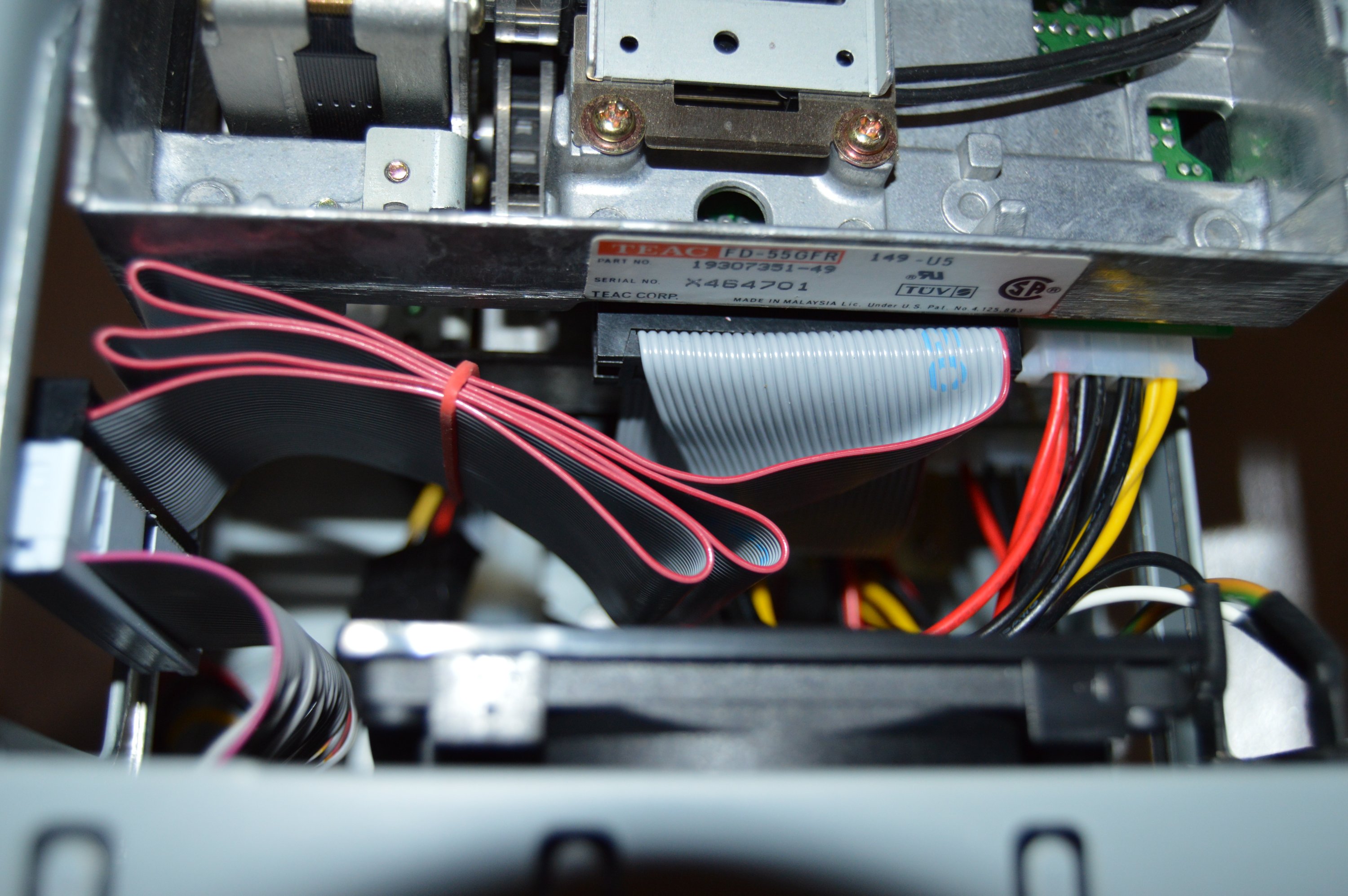

Here's the internal data cabling of the diskette drive cabinet:
Diskette drive cabinet open, showing wiring

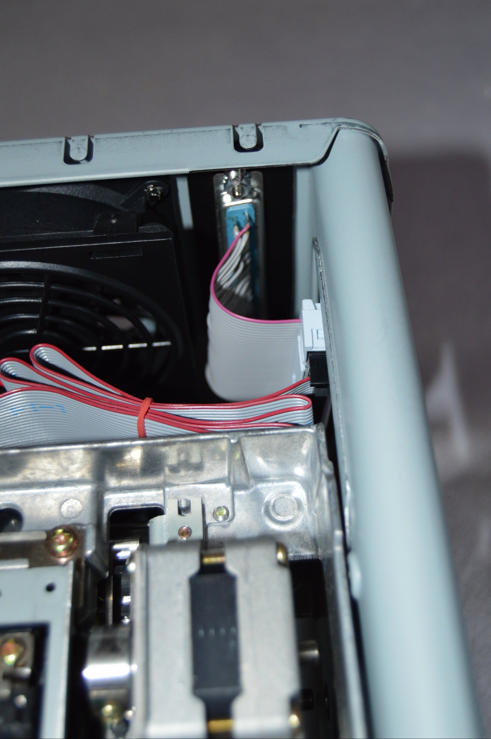

The cable is a straight connection - none of that PC-era twisted cable stuff - and it runs to a 34-pin IDC connector. That connects to a short 34-pin-to-DB37 cable. Could have been done with a single cable too.
Close-up of the internal data cable
Close-up of the DB-37 connector

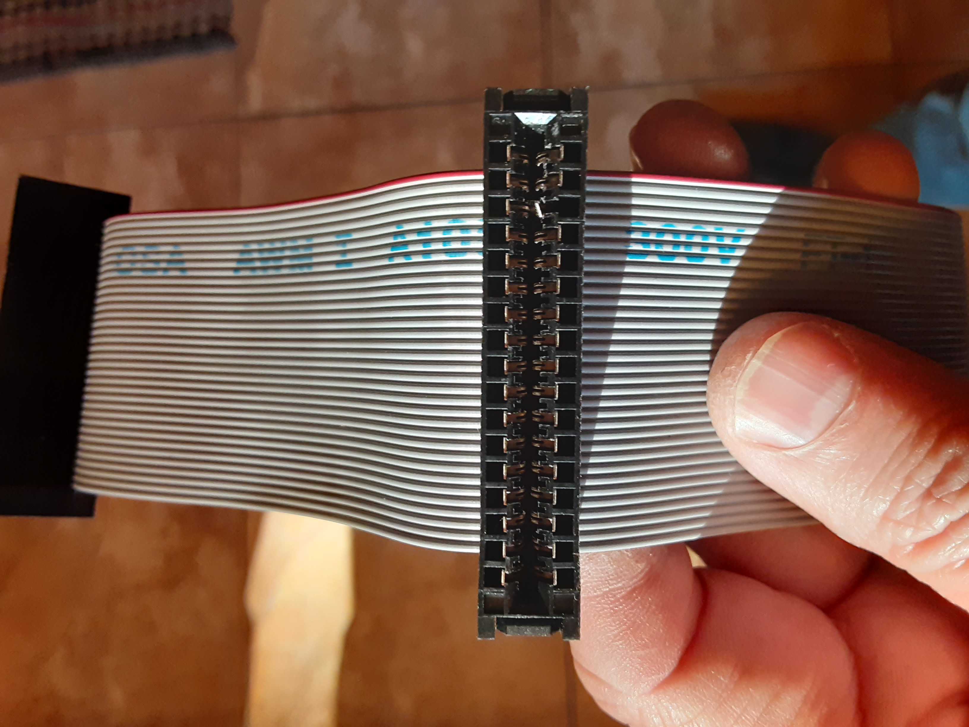

I pulled out all the cables. I'd show you a photo, but I've hit my attachment quota. But what it was is the edge connector for one of the drives had a finger that was mangled, and touching an adjacent finger. That was the whole problem, all this time!
How in the world had I missed that?!!

First was the disk drive interface cable problem I mentioned above. Easy enough to resolve once I discovered this:
Damaged edge connector
Somehow I had mangled that cable end, which obviously made the drive non-functional. But after I replaced it, the system was good as gold. In the end, I had about five feet of cable run between the FDC+ card and the diskette drives. Works just fine at that distance.
