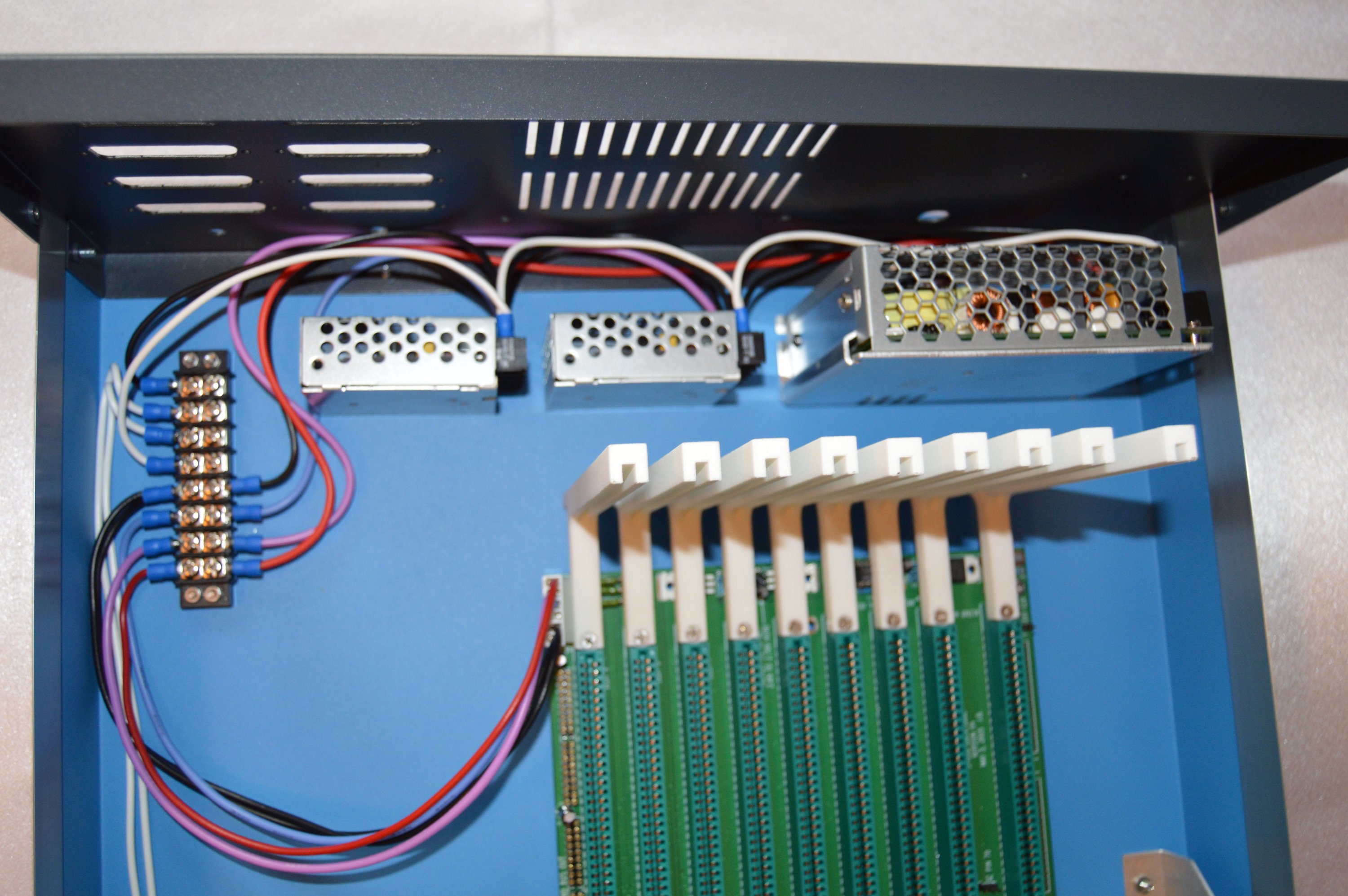

For power distribution, I had intended to use a pair of 4-position barrier strips, to keep the AC section away from the DC section. But I decided to go with a single 8-position strip.
The DC side is simple:
5. Black Ground
6. Blue -16v
7. Violet +16v
8. Red +8
AC is like this:
1. AC neutral
2. AC line
3. fused line
4. switched line
So the AC power line comes into 1 & 2. The (3A) fuse is connected between 2 & 3. And the power switch is connected between 3 & 4. So the AC line run to the power supplies comes from the #4 lug. AC neutral is connected to #1 and switched AC line is #4.
The DC section is just straight through - The output from each supply is connected to its respective lug on one side of the barrier strip, and then the other side is connected to wires going to the backpanel. For the 9-slotter, it goes to the PS connector. For the 18-slot backpanel, it goes through some inline fuses and then onto hard-wired soldered connections on the board.
For both the 9-slot and the 18-slot boards, I used a 10 amp fuse on the 8v line, and 1 amp fuses on the +/-16 volt lines. The 9-slot board is done with (socketed) picofuses and the 18-slotter is done with inline fuses.
I have not fully wired-up either system, and I haven't mounted anything on their rear panels either. I did put the fan on the 18-slotter, just to test fit and see how it looked. But it was just finger tight and came out right after clicking the photos. I'm leaving them bare because I intend to send both rear panels to a machine shop in Tulsa to have DB-37 holes punched in them. That's how I'll connect the disk drives.

Re: Altair 8800c build thread
Your builds are looking really good! The fuses never hurt, but the outputs from the switching power supplies are very well self-protected.
Yeah, I know those supplies will crowbar and protect themselves. But I thought fuses would be cool too.

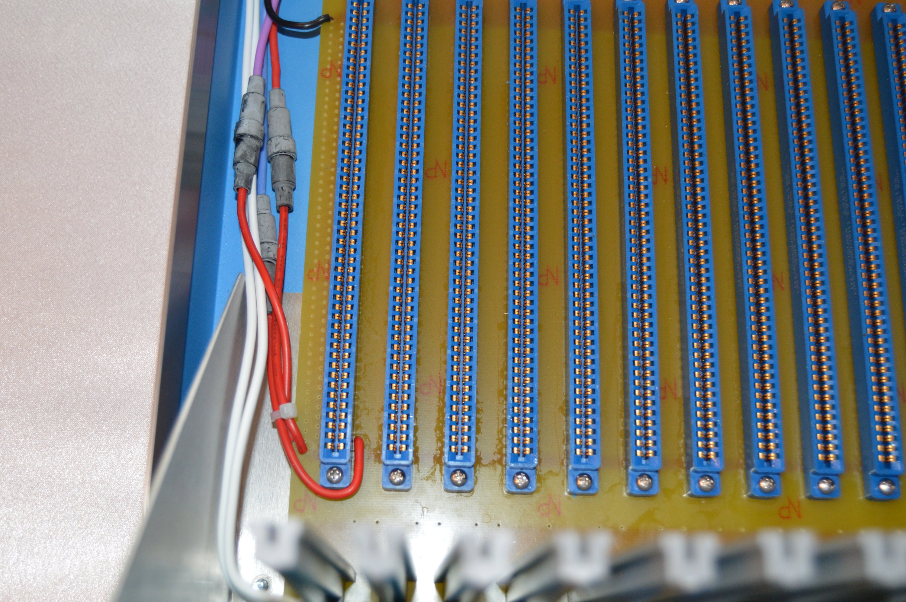

Strange, I have board position sensitivity on my system to.
Do you have power going to both edges of the backplane (near slot 1 and slot 9 or 18)? If not there could be a voltage drop that affects boards in the slots farthest from the power connections.Wayne Parham wrote:I have a little more progress to report.
You know, I haven't looked at the traces on the 9-slot board. So I don't know. I'll check it tomorrow. It's the board from s100computers.com, and power is connected through a Molex connector.
But in that computer, the power connector is nearest to slot 9, and when the system is finicky - when the rev. H 88-2SOIJP board is installed - I have cards installed in slots 1 - 4. It doesn't work if I space 'em out every couple slots.
I did see the original Altairs had power run as you've described on the 18-slot backplane. I have one of those too, but I haven't started focusing on it yet. I've put all my energy into the 9-slot version for now.
