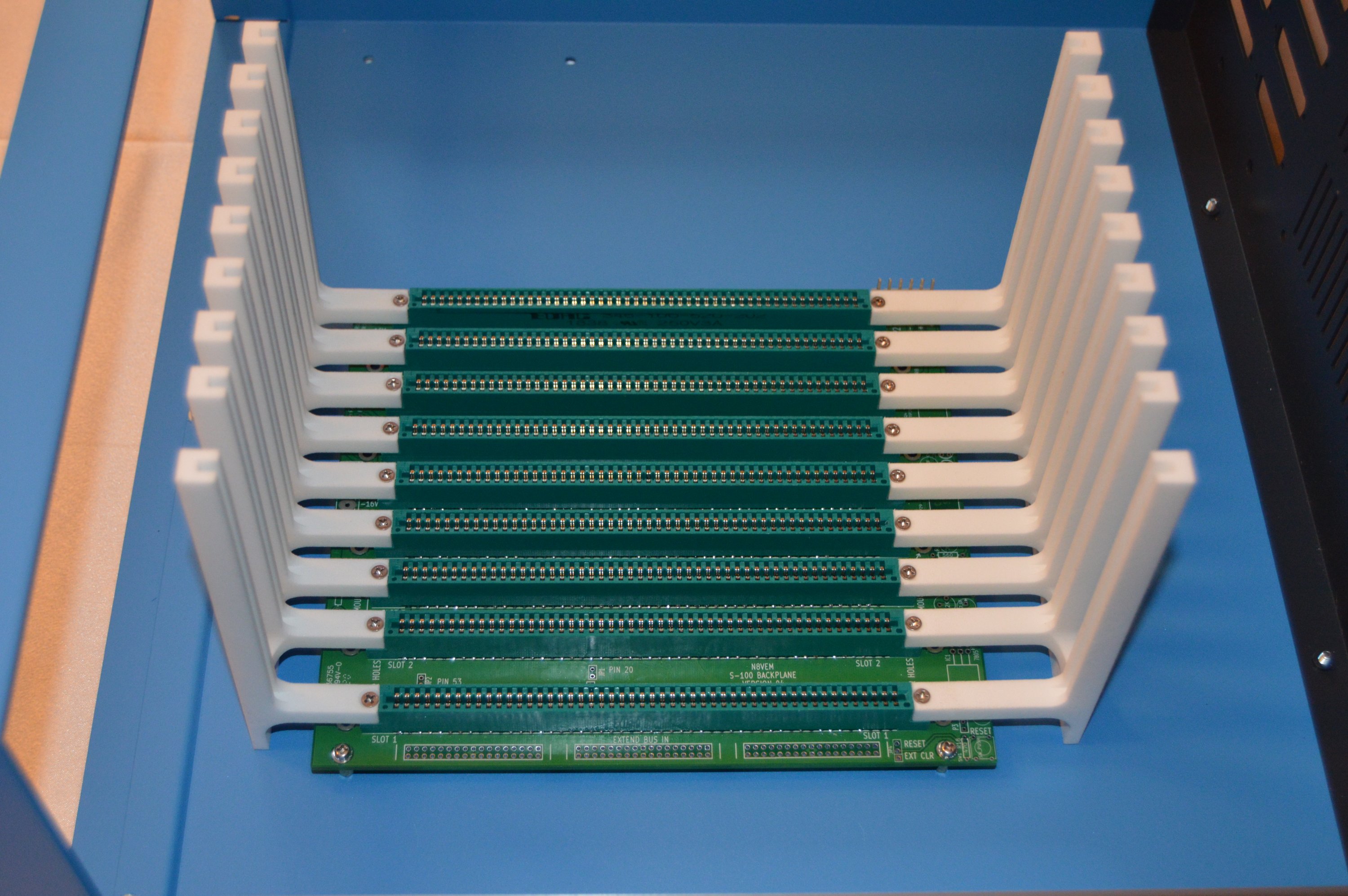

So far, I've concerned myself mostly with electrical construction. I've built the circuit boards, and I've hooked things up in a big pile on my desk. But I haven't done much yet in terms of physical layout and mounting. I've positioned the backpanel and the power supplies in the cabinet to get an idea where I would place things, but that's about it.
This weekend, I spent a little time working through the hardware mounting requirements for the backpanel and card cage. I wanted to find out what kinds of hardware - screws, nuts and standoffs - were required to mount them in the cabinet.
See the 3D Printing Service thread for details. I've included a list of the exact hardware needed. It also shows exactly where to put each of the spacers and nuts.

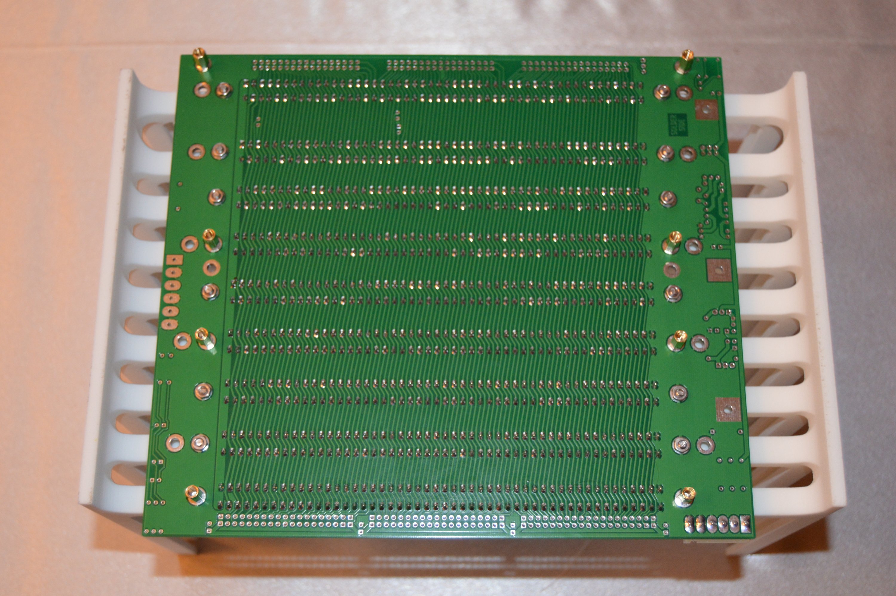

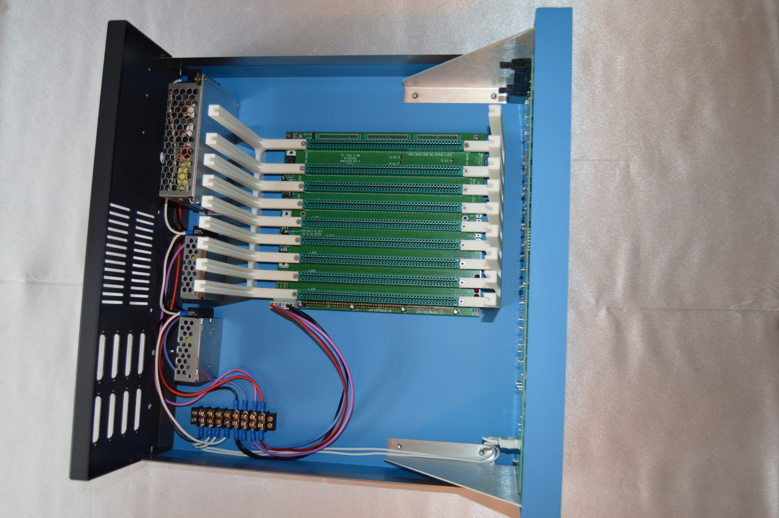

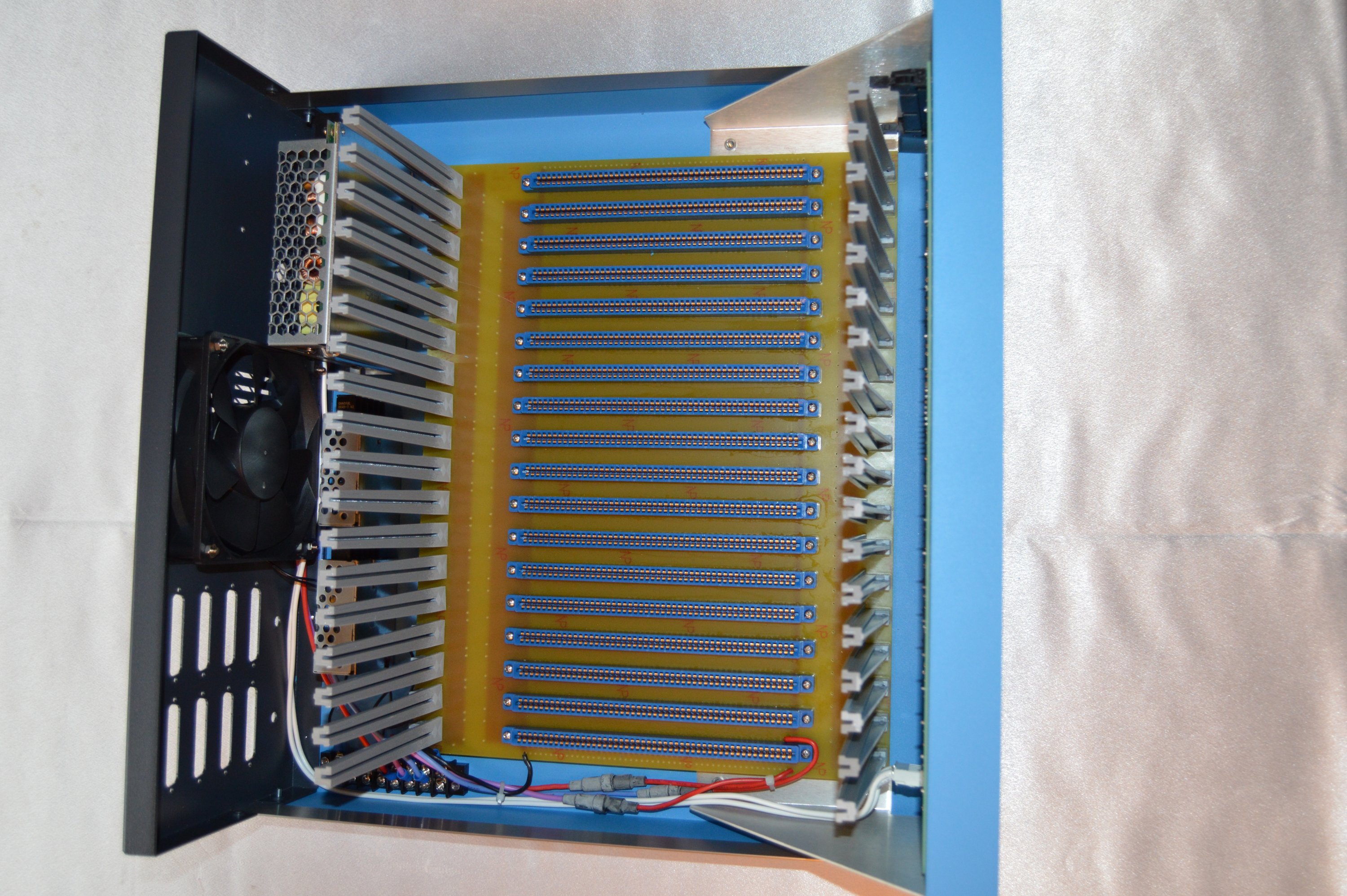

I've begun mounting the backpanels in my systems, and wiring everything up. I have two systems, one with a 9-slot backpanel and the other with an 18-slot backpanel. I chose to place the power supplies the same position in both cabinets, and also to distribute power in the same way, using an 8-position barrier strip.
As you might guess, the 18-slot version is much heavier. Not only does it have more mounting hardware - (36) M3x10 threaded spacers, (36) M3x6 screws on bottom and (36) M3x12 screws on top - but it also has (36) card guides. And probably none of that adds as much weight as the board itself, which is 3.2mm thick. So it's a heavy board.
But not having a huge AC transformer keeps it much lighter than the original.
