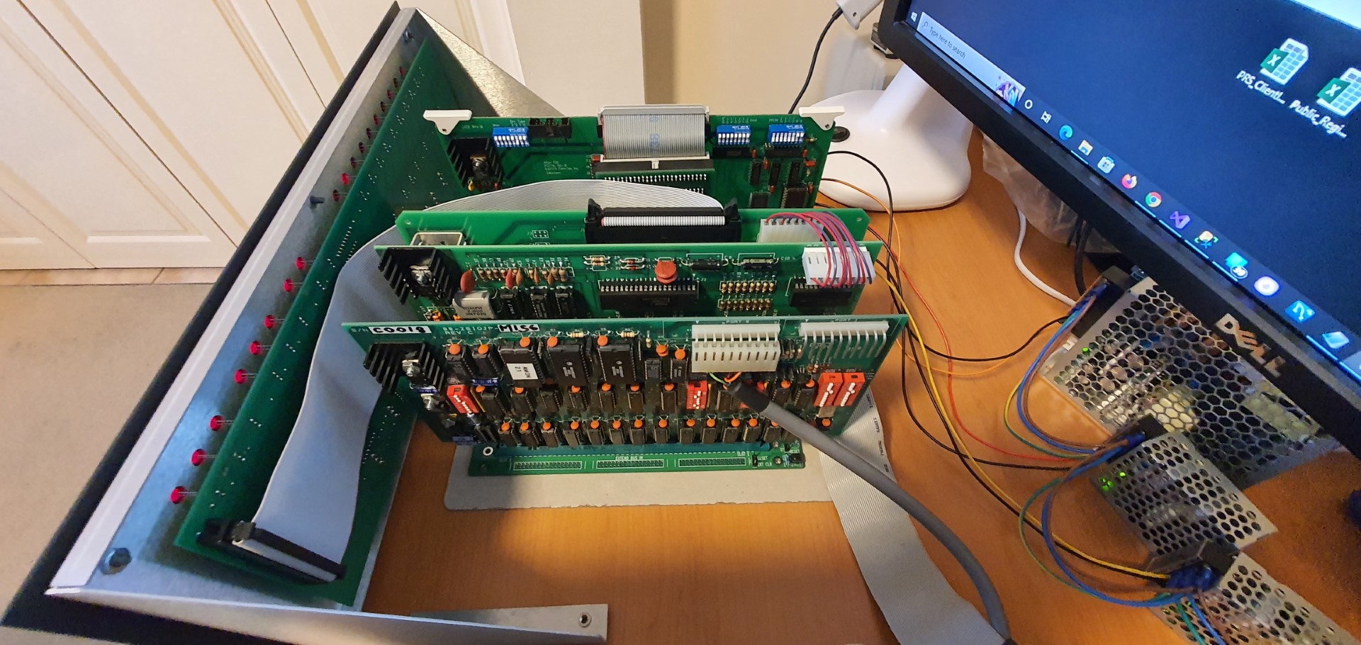

The issue I was having with the 882SIOJP is a little more interesting. I've found that it has issues depending on which slot it's in. It seems that if it's positioned after the CPU and Front Panel Interface it has issues. But if I position it in slot 1 it works fine. So, I currently have a fully working 8800C, with all new boards. The slot configuration that works is:
1: 882SIOJP
2: empty
3: CPU
4: Front Panel Interface
5, 6, 7, 8: empty
9: FDC+
I don't think it really matters which slot the FDC+ is in. I tried it in several different slots and it seemed to work consistently. Not so with the 882SIOJP. I tried that in the centre and it worked a little better, but not perfect. It seems to only work perfectly if positioned before the CPU.
It'd be interesting to work out why different slot position have an effect on it? This isn't an issue in my original Altair.

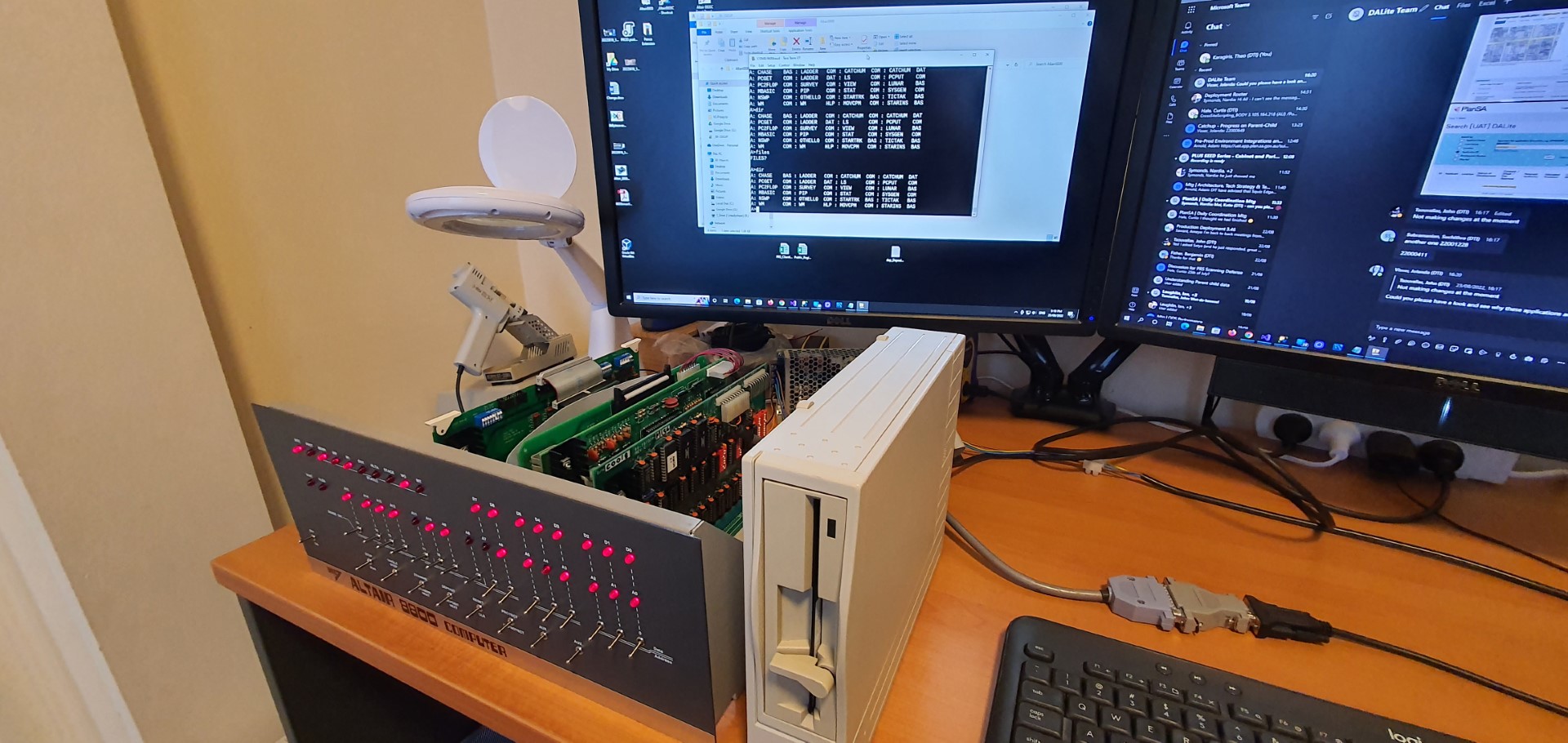

Running CP/M
Running CP/M
8800C working configuration
