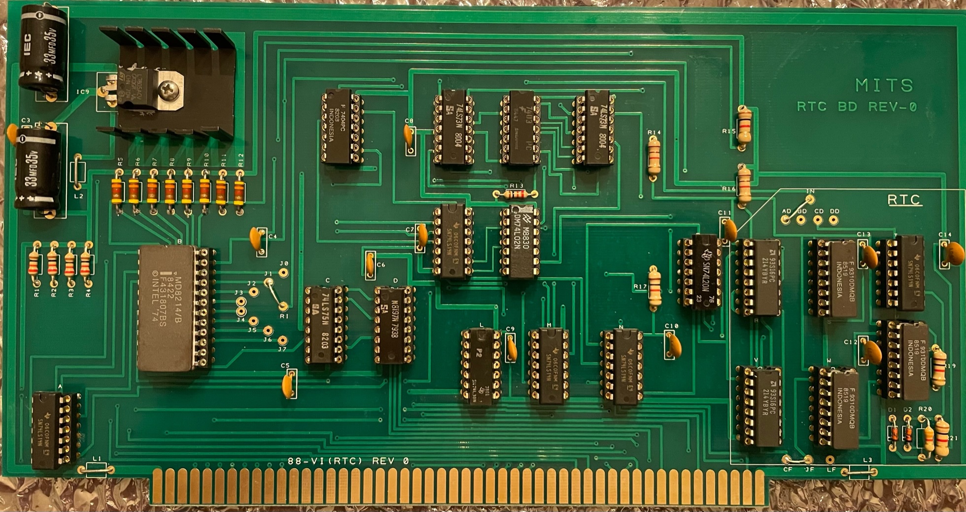

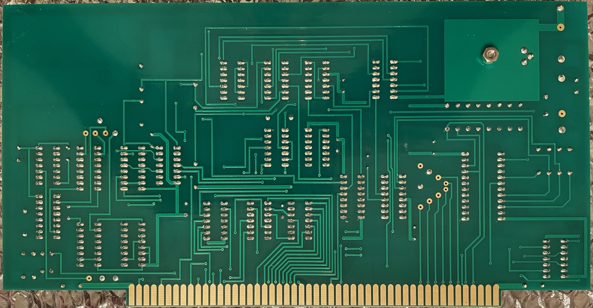

And to all, I’ve just completed this 88-VI(RTC) board from one of the bare reproduction boards available from JM Precision Components in the UK. Finding all the parts was like going on a journey, but not too bad at all and kind of fun.
I’m hoping to get Timesharing BASIC going with it.

And I can now report I did in fact get Timesharing BASIC 1.1 running successfully with some input from Mike. He pointed out I needed to change the RTC division jumper from “AD” to “CD” to divide the 10 kHz signal from CF to provide a 100 Hz clock which works. This allows me to run TS BASIC on the 8800x which is very enjoyable.

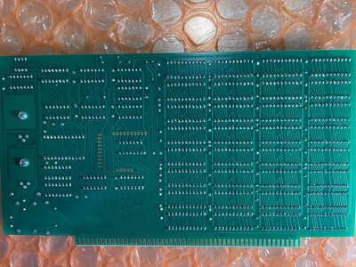

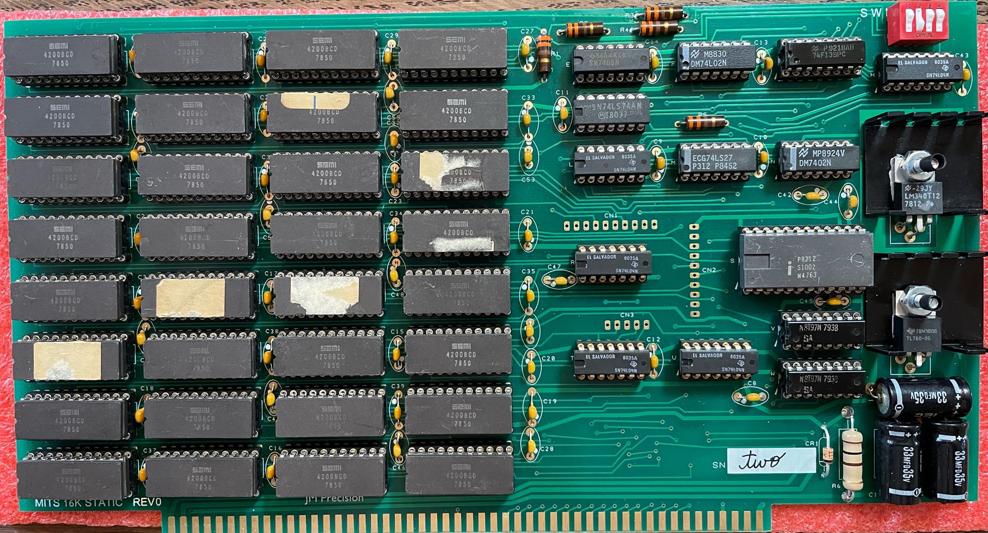

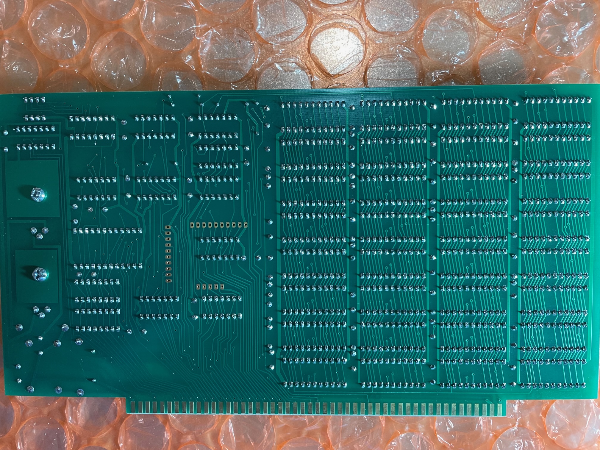

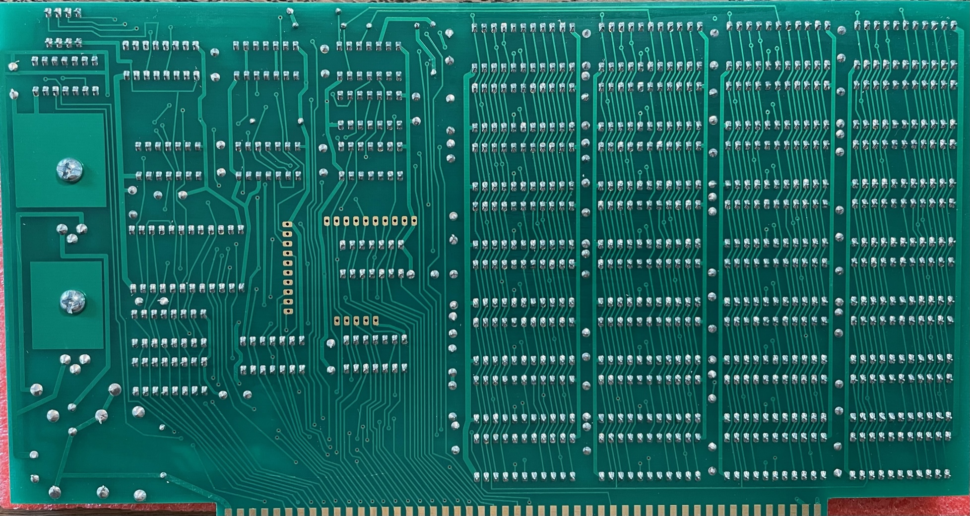

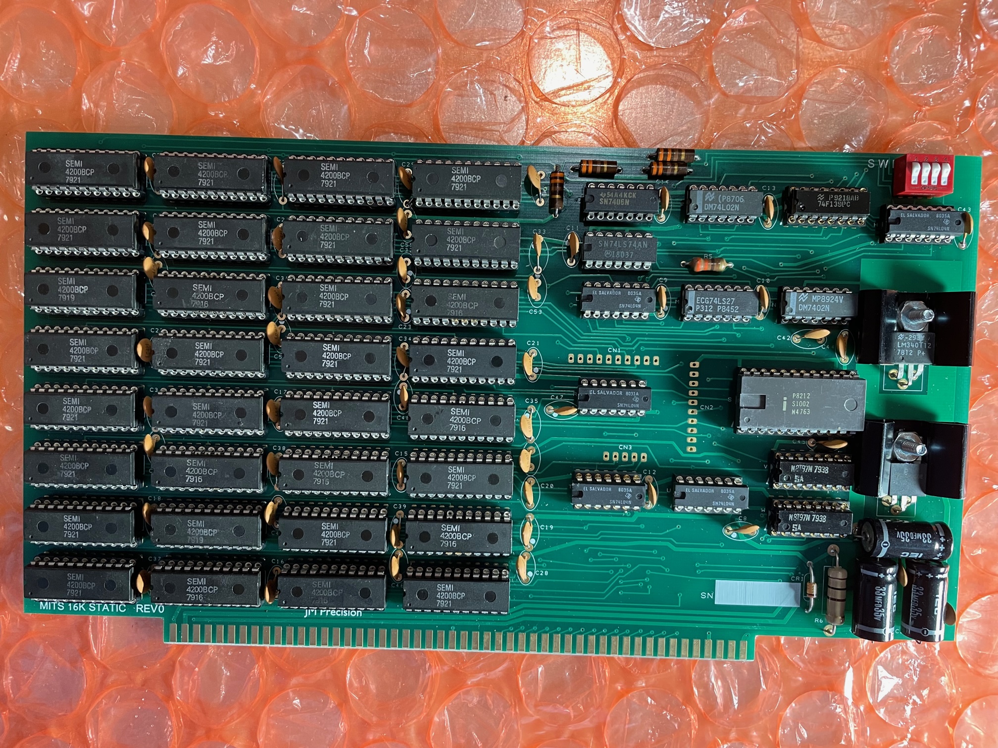

Since then, I’ve now completed building up one of JM Precision’s reproduction 88-16MCS memory boards. This was an ultra fun build and I ended up with only one bad 4200 chip. The memory test at 046 allowed me to recognize it was in bank “C”, and then I swapped out chips in “C” until I found it. I also could have examined the bit patterns of the failing data and identified the exact chip in “C”, but I did not do that.
I am beginning now a build of a second one of these.
Here are photos of the completed one.

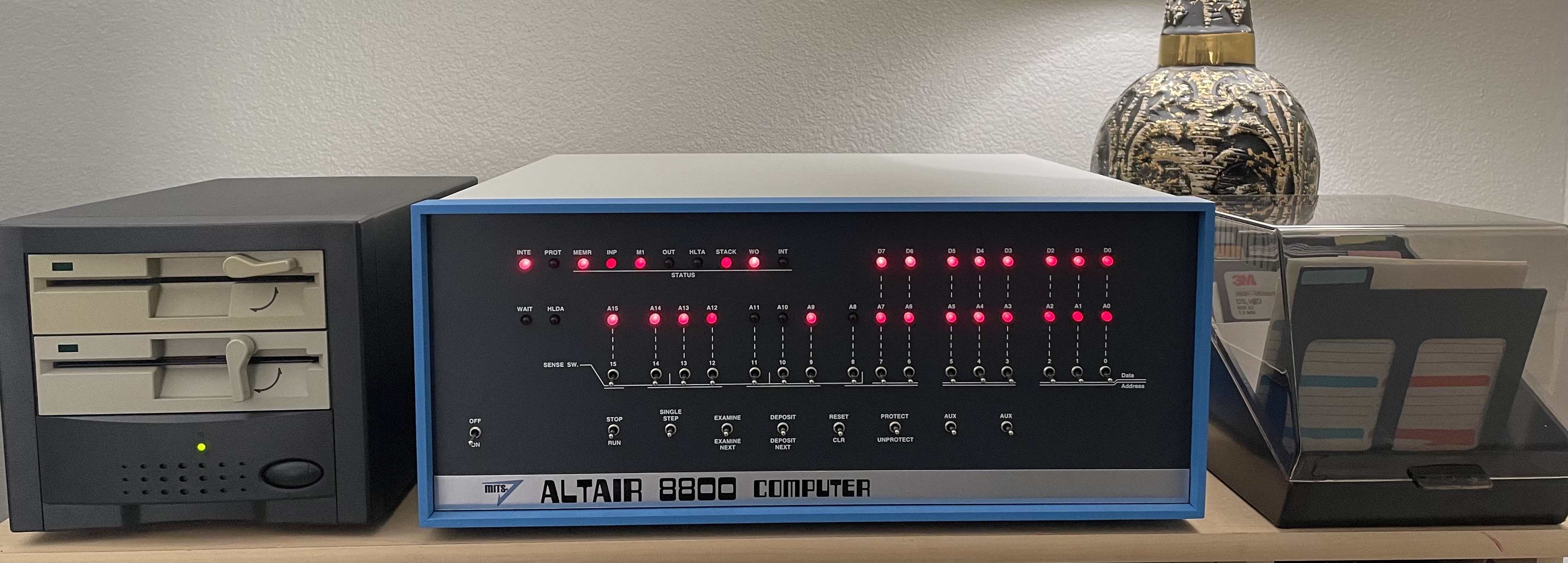

Here is a current operating photo.

What software are you using for a memory test of the 88-16MCS? What do you estimate for the parts cost of a single 16K memory board? I think an original 16K board would be $300 on eBay. That makes the FDC+ 64K a bargain.

Hi Tom,virtualaltair wrote:What software are you using for a memory test of the 88-16MCS? What do you estimate for the parts cost of a single 16K memory board? I think an original 16K board would be $300 on eBay. That makes the FDC+ 64K a bargain.
I used the memory test located at 046Q on the 8800c. There is firmware on the front panel microcontroller that has a few small programs you can deposit with setting an address and depressing AUX Left. The memory test is one of them. This AUX Left behavior is of course a modern addition and as such can be enabled or disabled as desired.
I also have AMON in PROM which has a memory test too. It runs quite a few passes and then returns to the AMON prompt, whereas the (version of the) one I have on the front panel runs passes continuously until you reset the machine.
Both let you choose start end endpoints.

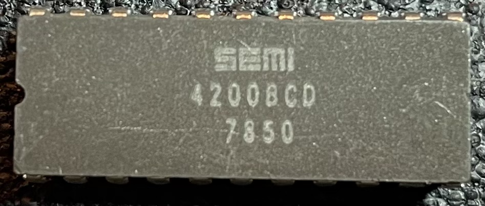

The parts and board weren’t too much, and I had many of the parts already. The style of sockets I chose are kind of high, but the real expense was the 4200 chips. I need a minimum of 5 more and I can fully populate a third board! If anyone has 5 or so to sell please PM me :)
I just finished board number two and miraculously, this one ran the first time with zero errors! No bad RAM at all!
