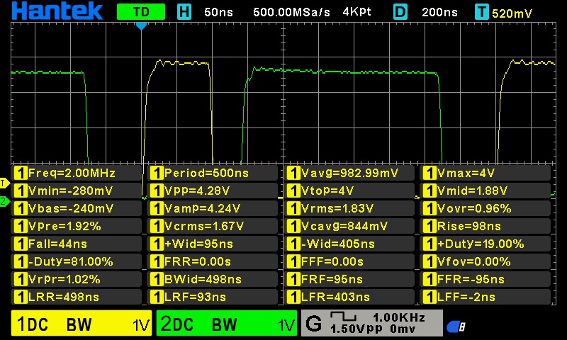

Okay, I swapped an 8.2k in for R41. Here's the result:
Phi1 + phi2
Phi1 + phi2
Also the measurements

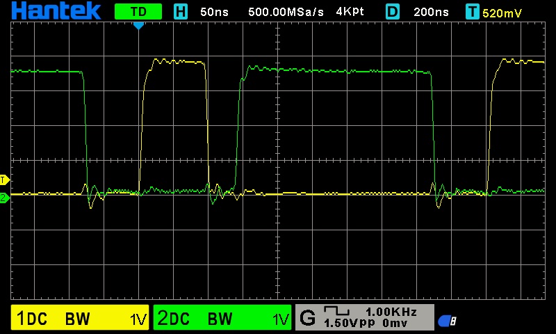

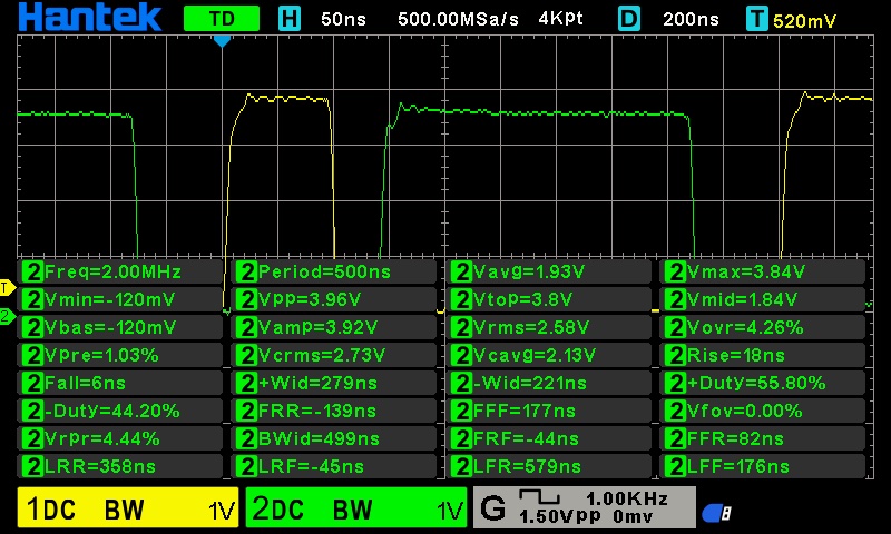

Phi2:
Phi2 measurements
Phi2 measurements
Maybe phi2 is a bit long, too?

Ok, that looks great on phi1 and got us up to the minimum phi2 to phi1 timing. Now let’s shorten phi2 a bit to get some headroom. I’d use a 5.6K for R42. That should get phi2 down to just below 250ns and gain us about 30ns of headroom.
