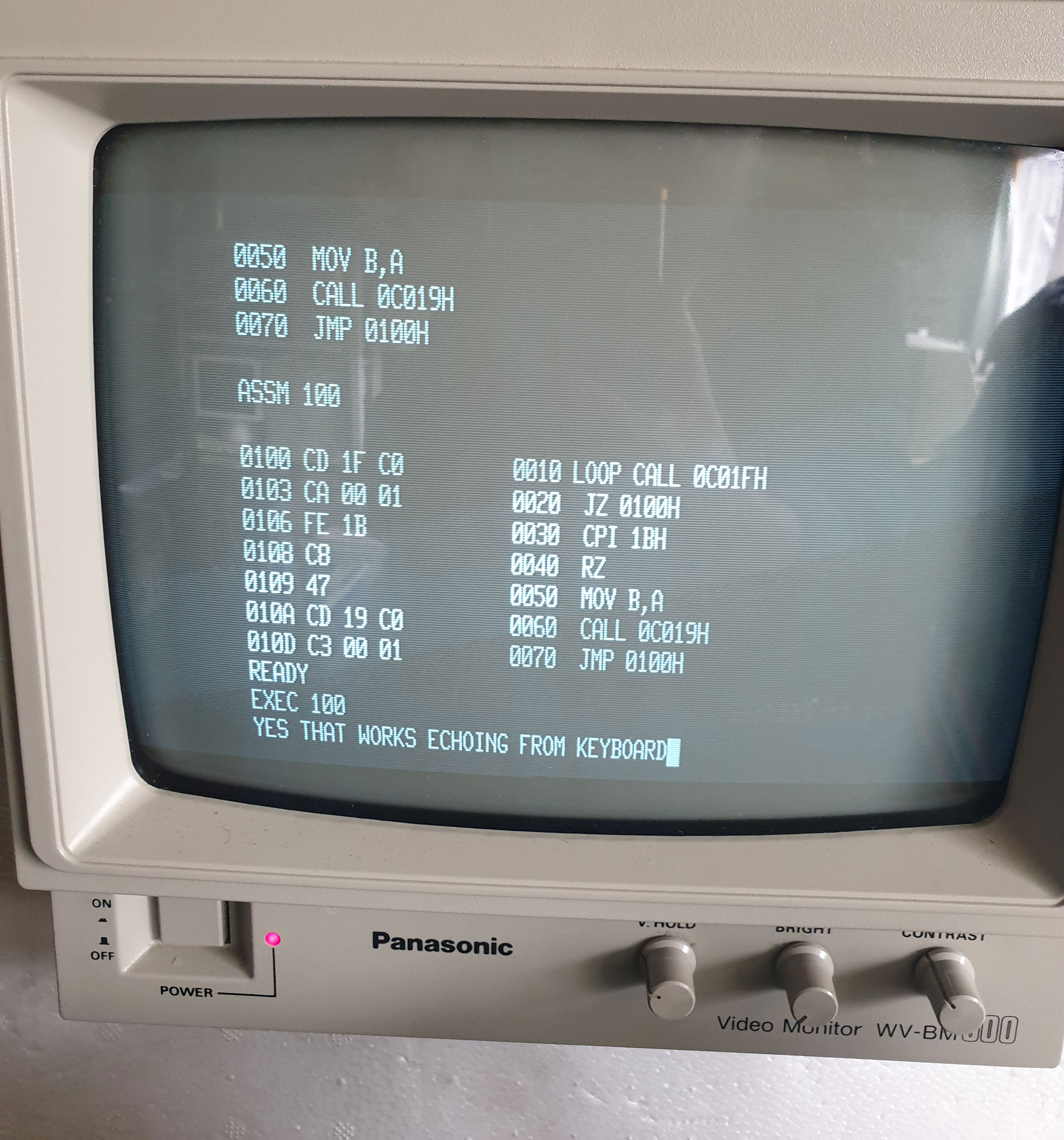

Yes code worked fine echoing everything from my ASCII keyboard to the VDM-1. On one line then writes over it. Is this correct.?

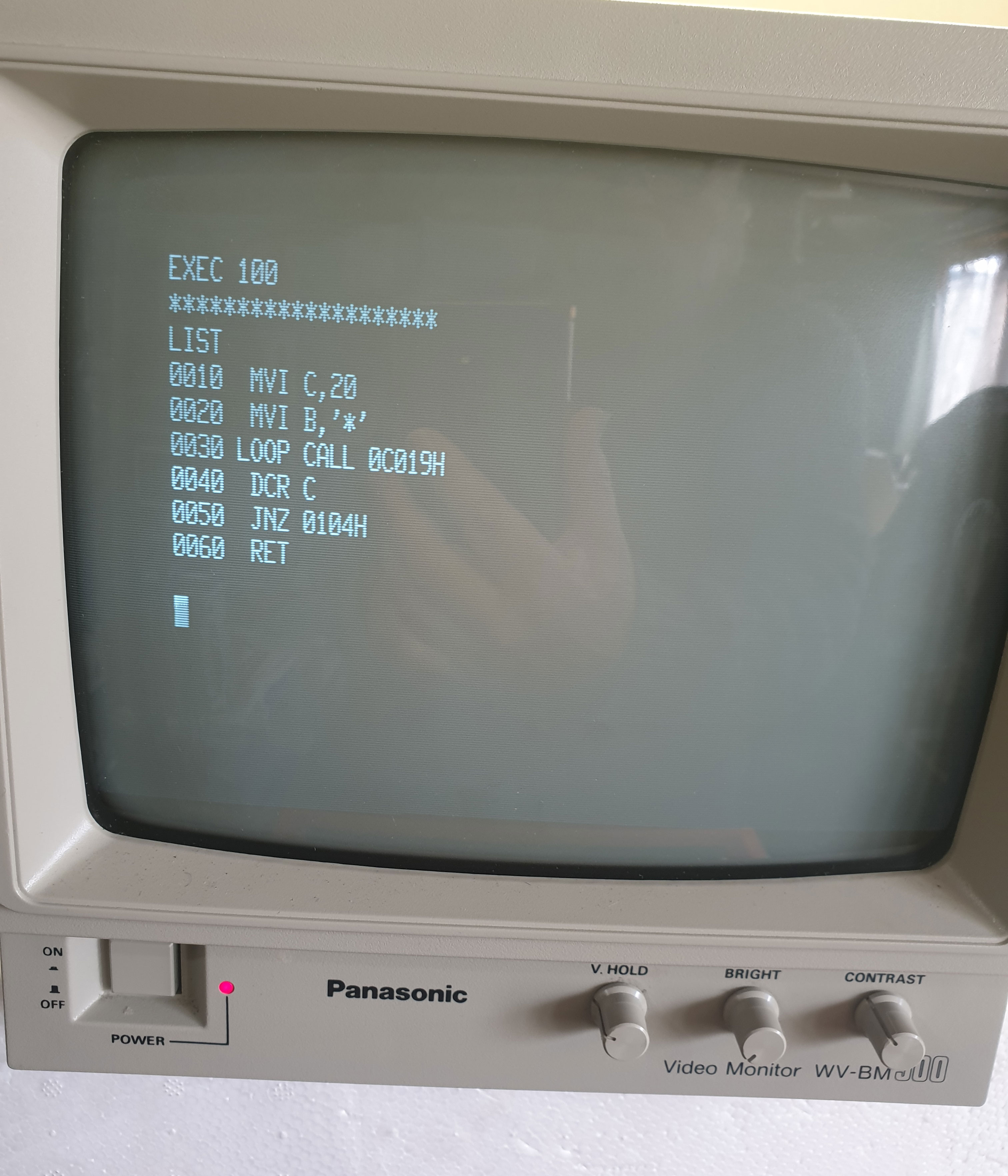

Still not sure why when I type from teraterm to the 3P+S over serial port that ALS-8 seems to not like my LABEL(LOOP) has a "U" error. But if I put the address of the loop in the code it runs fine. The manual says for a Label to just have one space is this correct.? And for the Opcode two spaces. Perhaps my serial setup is not quite right yet.?
Is there away to patch the ALS-8 source code so it comes from the ASCII keyboard port to VDM-1.? At the moment from CUTER i'm using the ASCII keyboard to enter (E024) to EXEC ALS-8 and it switches to the serial port. Perhaps that might solve the LABEL program.

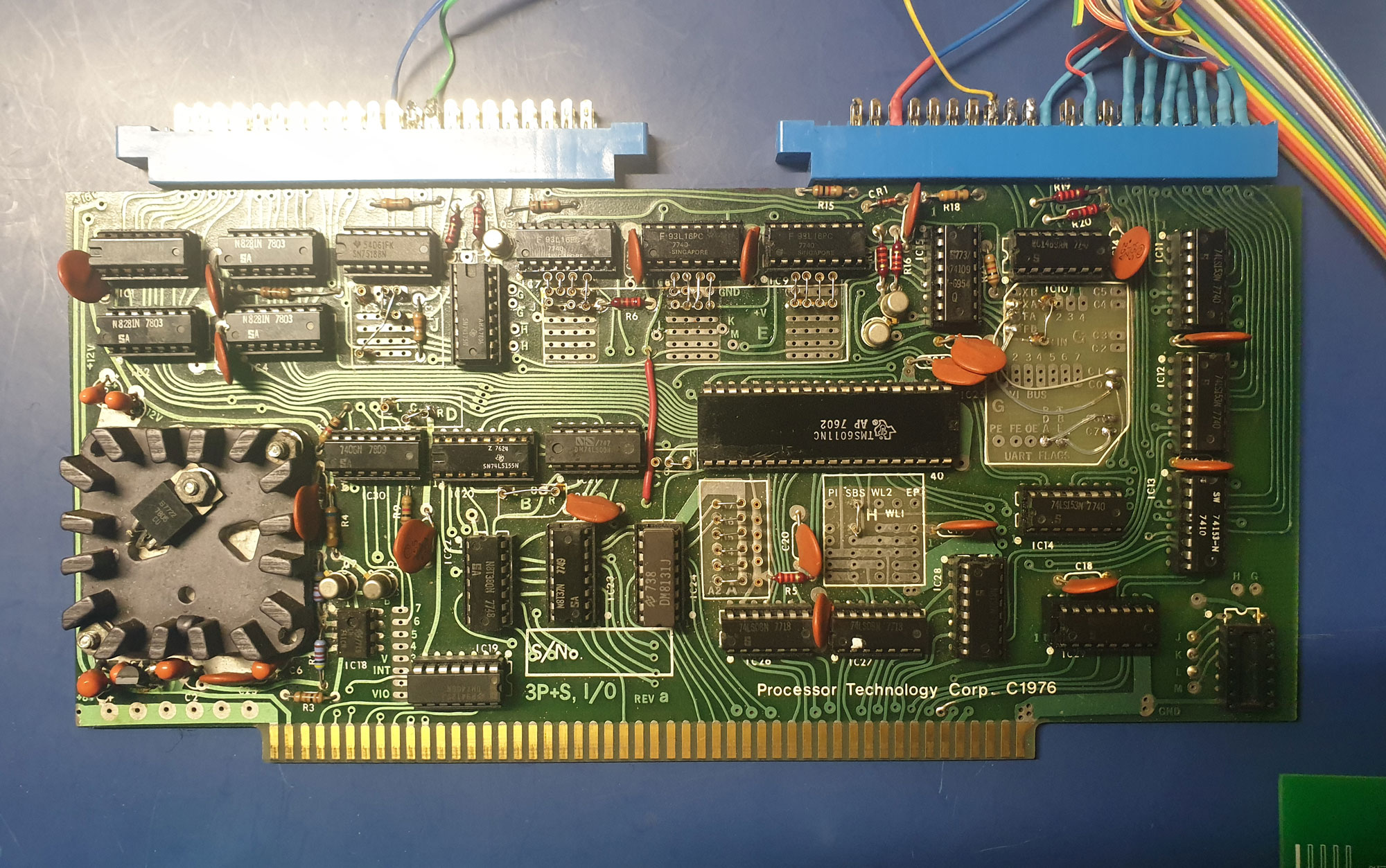

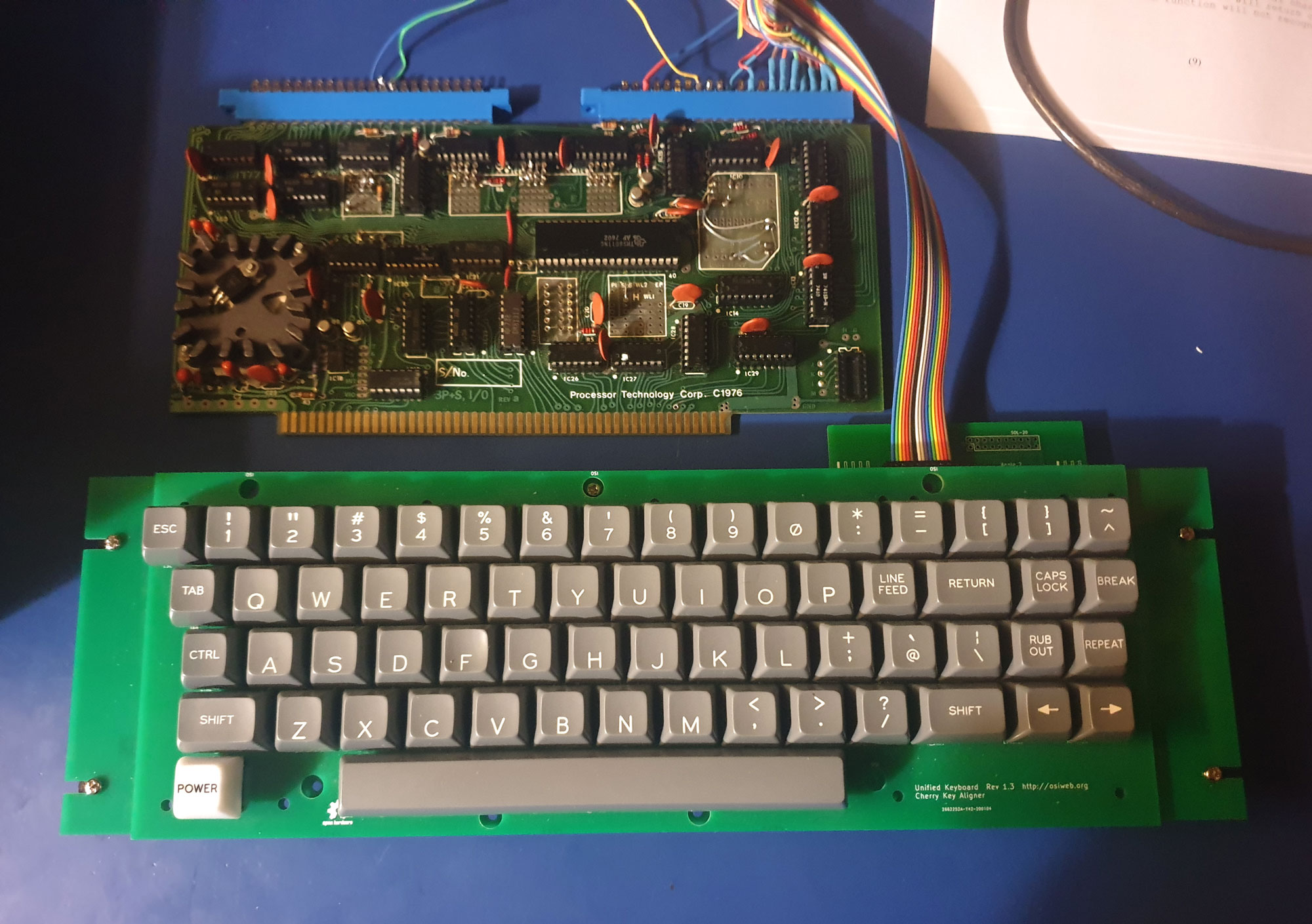

I followed the SubSystem B manual. Jumpering 3P+S for Keyboard Console and RS232-C Serial interface
. This is the parallel ASCII keyboard I made up. Although I have got one of Dave's Sol-20 keyboard replacements as well to add to the mix once I learn how to drive this system.

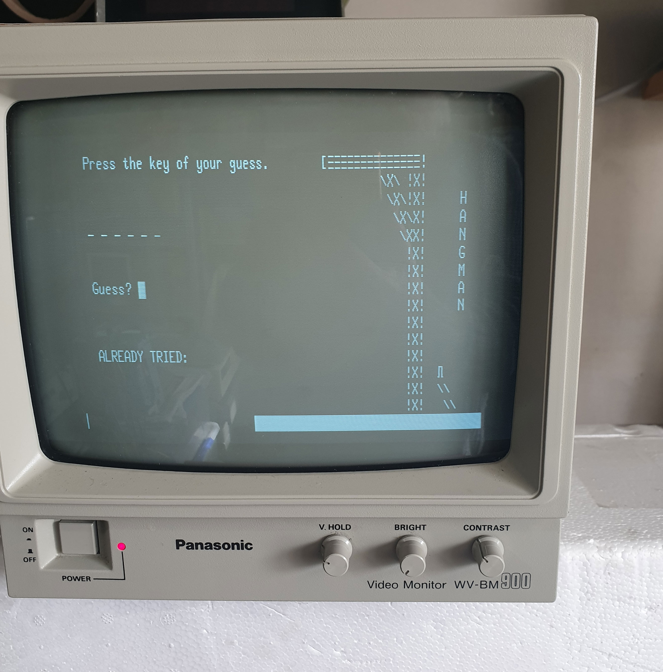

Made the EPROM you attached - PROM version of ALS8 patched to work with CUTER (or SOLOS) for console I/Oand can confirm it works fine, thank you very much.
I can jump straight into ALS-8 from CUTER and using my Parallel ASCII keyboard connected to the 3P+S board. I've being playing with ALS-8 this morning. Still have the problem of ALS-8 not seeing the "LABEL" statement, I've been using your example from the web video. Do you have any thoughts on this?.
I also tried using Solace emulator on my Windows 10 PC and typed it into ALS-8 just to be sure I'm doing it right and that works as expected like your video demo. So something strange there.

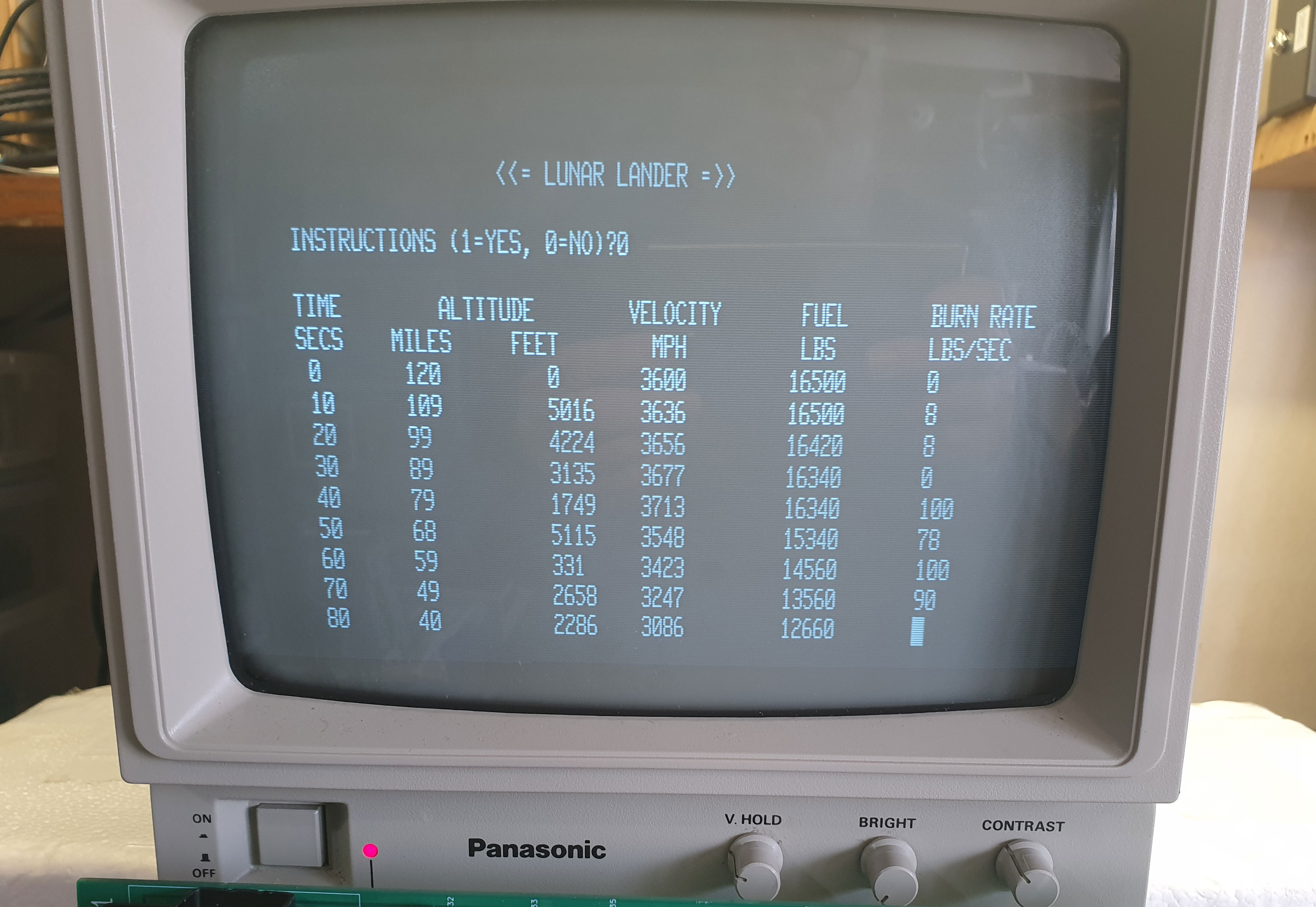

I then transferred over BASIC5 over the serial port to the system plus transferred over lunar and this game did work fine. Although I still need to adjust Character and line delay, as I had a couple of errors. I'm using Tera Term what are you recommended setups for this program. I'm at 9600BAUD 8N1. Lunar working fine. ALS-8 working and you example if I don't use the LABEL statement
