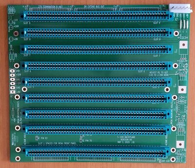

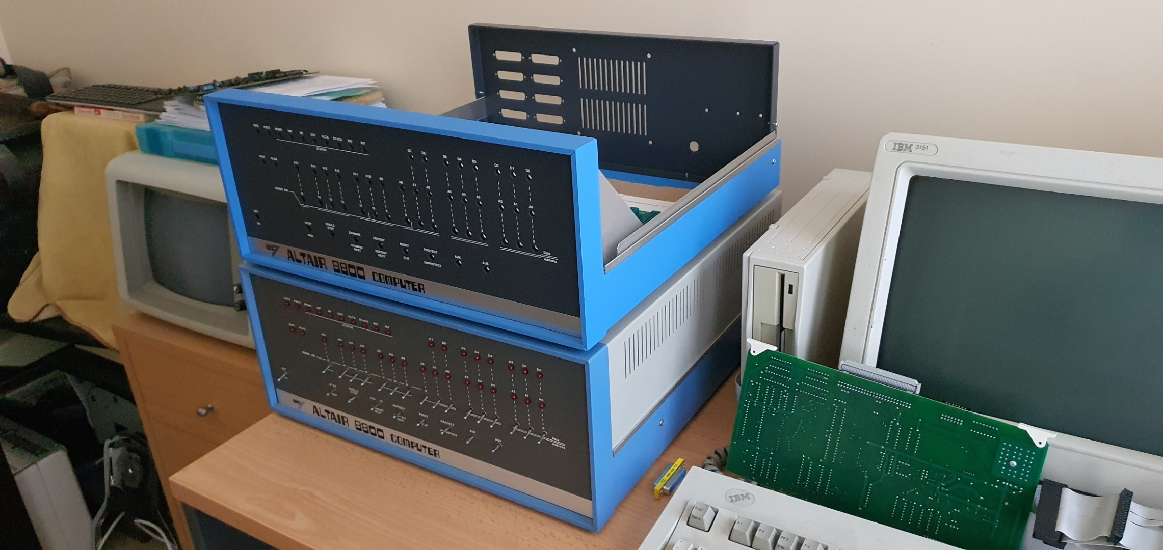

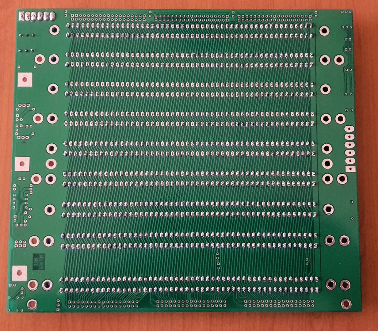

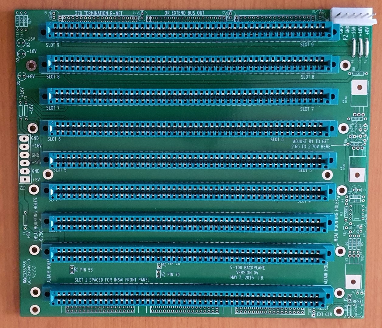

The only parts I'm still waiting to arrive are the case and front panel boards, and they're on the way. While waiting, I put together the nine slot backplane and power supply wiring. Everything tests well, I've got the correct voltages going to the correct pins. I'm getting 7.61v, 15.12v and -15.12 on respective pins.
LED's arrived they look great. They have a deep red look, I held them up to the original machine and they're a perfect match.
Here are some updated pics.
