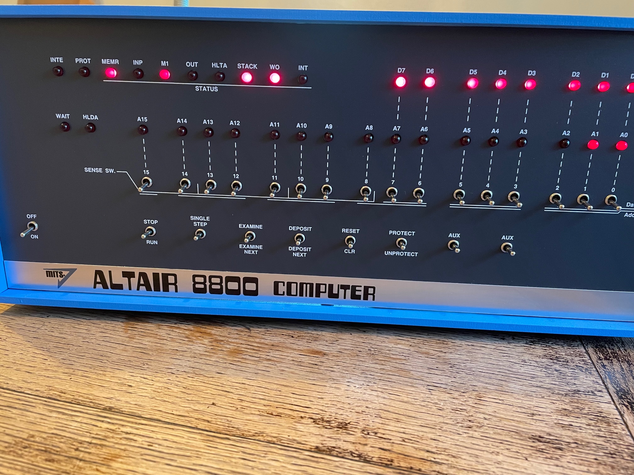

It’s working!
More pictures soon, I still have the power cord temp’d in and stuff like that. But it’s absolutely working.
At first it appeared it was NOT working, until I figured out I installed one of the IDC 50 connectors on the flat cable backwards. Hint: don’t do that. It won’t work.
After fixing that I was so happy to see it accept a reset. I keyed in my first program:
C3 00 00
Runs like a champ! This photo is of that program running now.
Thank you to everyone who helped. I’ll post more photos soon. BillO, that rework station made turning that switch around a snap.
This is just a quick post with more to follow soon and appropriate thanks to Mike, and to others who produced boards and those of you who helped me here.
Regards,
Sirius
8800c sn 13219 running
