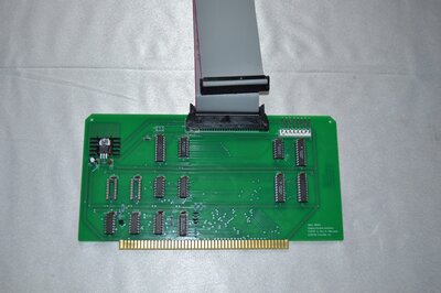

I had a little time this week, so I built the front-panel interface board:
I'm waiting on 74LS109 flip-flop chips. But other than that, the interface board is done.
I'm also waiting on the power switch and on 74LS165 shift-registers for the front-panel board. When the shift-registers arrive, I'll probably start assembly, wiring power directly rather than through the power switch. That way I can get stuff running now. Then later - when the power switch arrives - I'll solder it on and assemble everything properly.

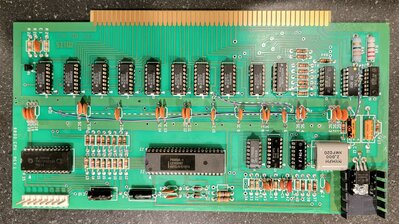

I assembled my board today, took a solid 6 hours. I appreciate your tip to pay attention to the parts kit BOM. There were some helpful explanations there that made the build go pretty easy. Gary's assembly manual was also very good.

Do you have R45 and R46 reversed?Curto wrote:Thanks, I got my board from Gary and bought the same parts kit from tpkirkp. Being my first venture into Altair land I thought it would be nice to buy an assembled and tested CPU as a known good troubleshooting aid.
