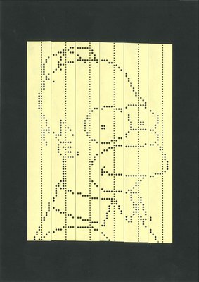

Just would like to share with you some of my paper tape punch artwork!
Hope you like.

Here's the basic program. It includes a very basic!!! decimal to binary convertor to enable the image to be "printed" to the screen as an option from punching to tape via ACR port.
It's a bit slow anyone have any suggestions on a little speed improvement would be appreciated.
It also has a very basic wait loop in the form a for/next loop to allow my DSI 2400 to keep up with ALTAIR 8800.
What would be nicer would be the WAIT command I think but can't get to grips with it?

To wait for the ACR port to be ready for the next character, the code needs to wait until bit 7 of port 6 is zero (active low logic). Use this WAIT command before the OUT command:
42 WAIT 6,128,255
You can then delete statements 50 and 55.
The 255 (0xFF) is XOR'd with the port 6 status register. This inverts every bit so that zeros are now ones and vice-versa. The 128 (0x80) is then AND'd with the XOR result to isolate and test bit 7 for 1. This indicates the port is ready to accept another character.
42 WAIT 6,128,255

Made my own Homer artwork using a Teletype connected to the ACR port (6/7) and the WAIT command added. Worked great! Post source for the other artwork when you have a chance.
Thanks!
Thanks!

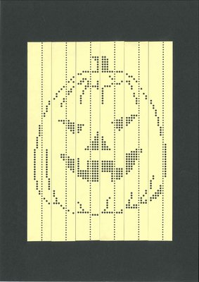

Here's one for the upcoming holidays!

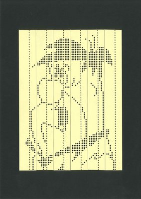

Have a try with this one as a companion to Hommer!
See what you think.
In my own setup with a DSI NC2400 I add 28 nulls to the end of data set before the end of data code 999, which allows the tape to punch to a point where you can just rip off the tape without fear of not having enough tape out or wasting too much tape.
You'll have to calculate how many nulls for your own machine.
See what you think.
