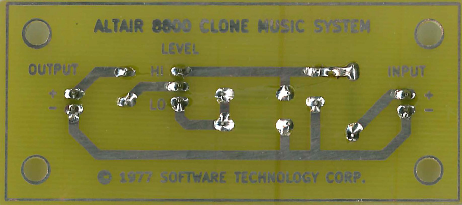

Just thought you might like to see my efforts at a music system board.
Can't test it out as only just ordered my Altair 8800 clone ;-)
Sound Board
Sound Board
