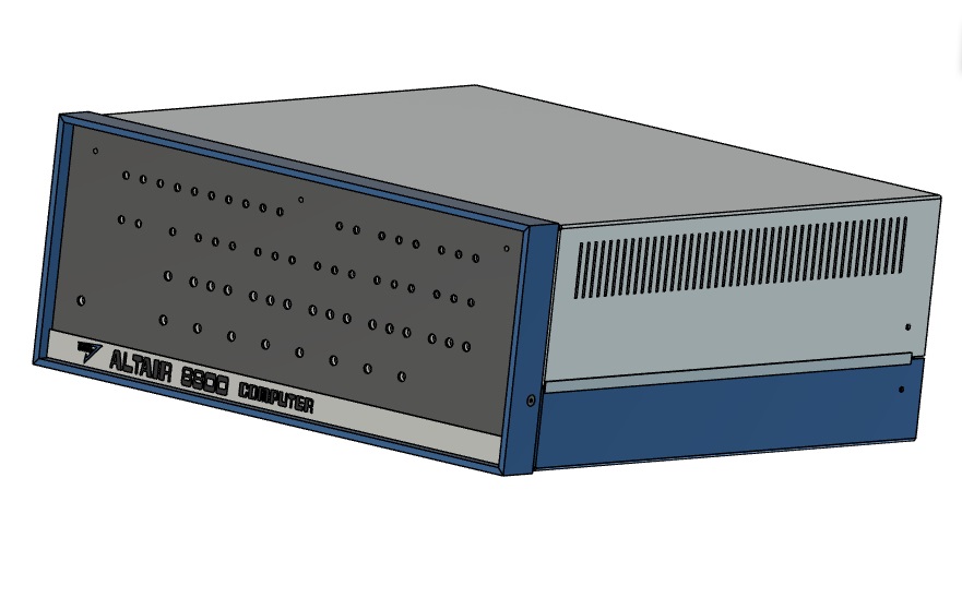

Here is a fairly faithful model of the Altair 8800c case....
Altair 8800C Case v53.zip
STEP File of Altair 8800C Case
(565.8 KiB) Downloaded 1660 times
