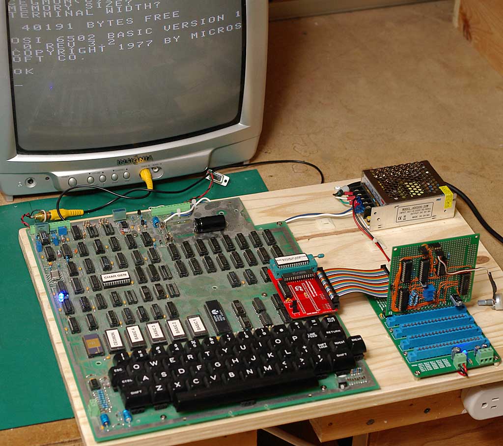

Here is the bus adapted to the OSI C1P/600 Superboard:

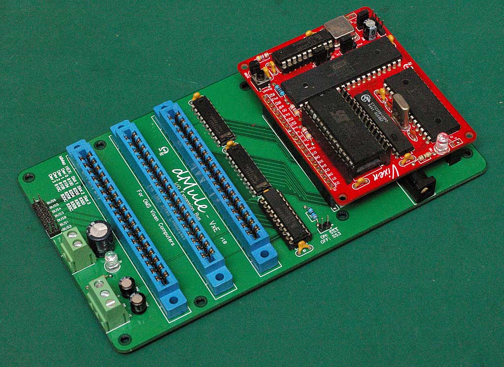

Here it is adapted for the Vixen. An SBC using the 6502 and designed along the lines of the Arduino and other such plug-in controllers:

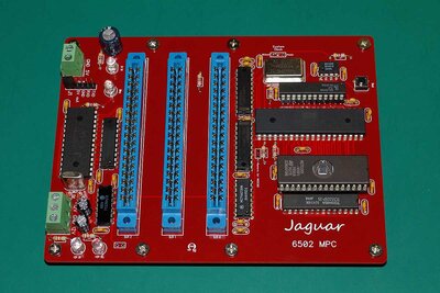

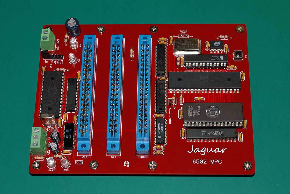

And here it is incorporated into the expandable Jaguar:
With a few minor exceptions (mostly speed related - the OSI runs at 1MHz the Vixen/Jaguar can run up to 16MHz), any I/O card designed for one machine should work in the others.
