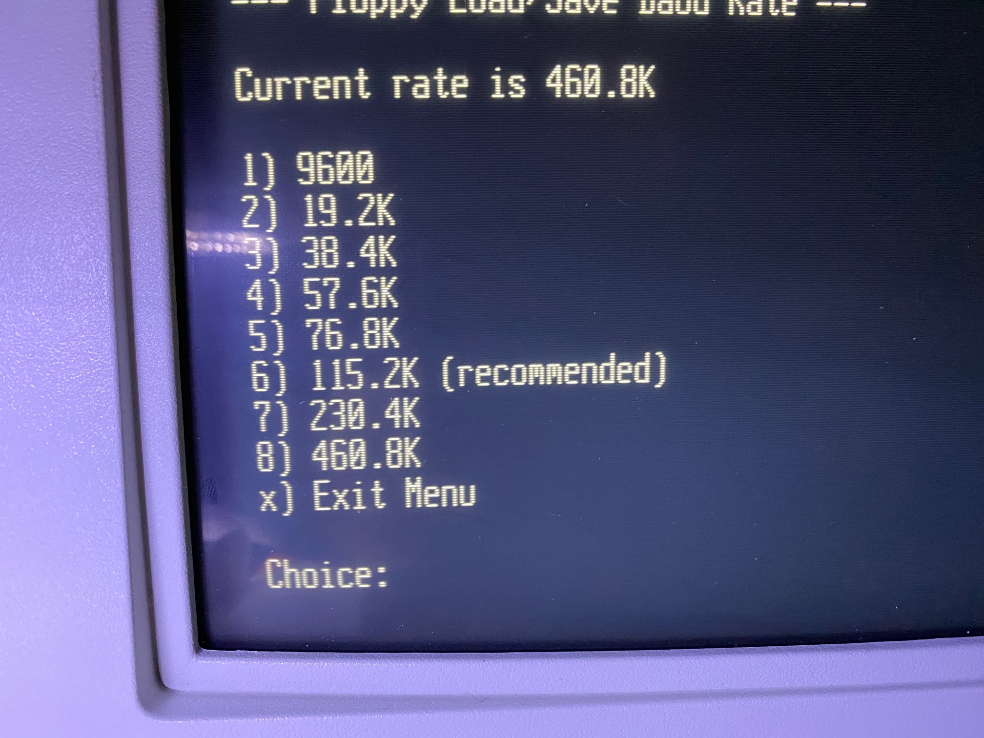

I've set it up for a terminal (wyse 150) on 2SIO Port 1 and Disk Transfer on 2SIO Port 2.

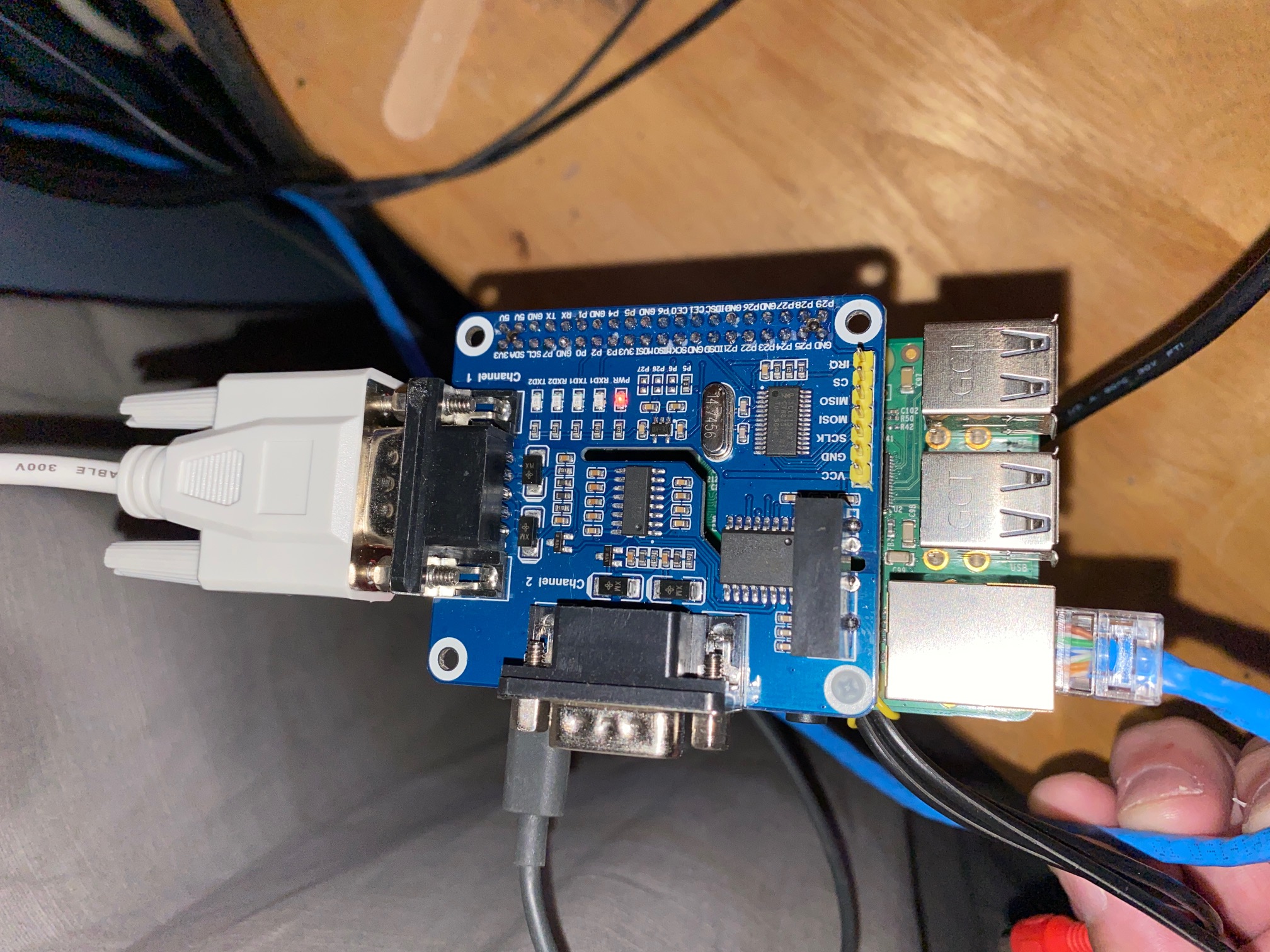

I've added a dual rs232 port module to a raspberry pi. With the short connection, I can set it for 460.8k/sec speed and get disk transfers completed in < 14 seconds.
I have not done it yet because I prefer my Wyse Terminal, but one could configure rs232 port 2 on the PI to go to 2SIO Port 1 and then terminal in from the PI. You could configure a script to know to send rom files and other port 1 files automatically over 2SIO Port 1 and dsk files over port 2.
It removes the need to have a PC to send .dsk files.

Cool! I forget who requested the option to use the second port for disk transfer and to support multiple baud rates for the transfer, but you’ve done a great job using those features.
