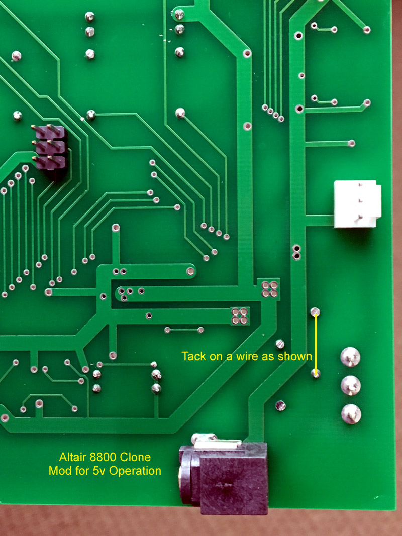

steve_a wrote:I'm still waiting on an ATX power supply and a 5v-12v boost converter -- I'll be using the 5v standby voltage from the ATX power supply boosted to 12v for the Altair Clone. You can draw something like 3A through the standby and the Altair needs a whopping 40mA, so I think that'll do fine.
If you’re not going to use the 12v fan connector on the Clone PCB anymore, then the PCB can easily run from 5v. One jumper can be tacked onto the back of the board to bypass a zener diode and the Clone will run from 5v. Let me know if you want more info about that.

AltairClone wrote: If you’re not going to use the 12v fan connector on the Clone PCB anymore, then the PCB can easily run from 5v. One jumper can be tacked onto the back of the board to bypass a zener diode and the Clone will run from 5v. Let me know if you want more info about that.
Sure! The boost converter I have isn't the greatest in the world, and if I could get away with using only the standby voltage I'll do it!

Tack on a jumper wire where shown by the yellow line to configure the Altair Clone PCB to run from 5v instead of 12v.
