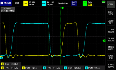

AltairClone wrote:Yes - good looking scope shots and it sounds like you have your head wrapped around the issue.
The minimum phi2 high time is 220ns, so I don't like to take all the time we need from phi2 - that leaves us too close to the 220ns parameter.
The minimum phi1 high time 70ns, so we can take some time from there as well, which adds to the time between phi2 fall and phi1 rise that we need.
Assuming R42 for phi2 is presently 6.2K, then 5.6K will take you from 280ns on phi2 down to around 250ns. That gets us about 30ns
Assuming R41 for phi1 is presently 13K, then 10K will take you from 125ns on phi1 down to around 95ns. This gets us another 30ns. This give us 60ns total additional time between phi2 fall and phi1 rise.

I checked the existing resistors and they were 6.2k and 13k at R42 and R41. So, today I replaced those with the recommended resistors 5.6k and 10k and I think we have success!
In testing, I kept the order of the boards as before: CPU and front panel in slots 4 and 5; FDC+ in 9. The very first thing I tested was running kill the bit from the front panel injection. That worked. Then I plugged in the 882SIOJP in slot 1 as before, and loaded CP/M using AMON and the Serial disk drive. That worked. Then I set up the boards in the configuration that didn't work initially. CPU and Front Panel in slots 1 and 2; 882SIOJP in 7; FDC+ in 9. I'm happy to report that the slot sensitivity issue seems to be gone!
Just to recall what the issue was. Whenever I tried typing in AMON, I would get inconsistent characters appearing on the terminal. This is now gone, I get a good solid echo back of what is typed.
Here's an updated scope capture of IC-Q. Things look much better. Width of phi2 is 259ns and gap between phi2 falling edge and phi1 rising edge is around 84ns.
Big thanks to both Mike and BillO for their help on this.
