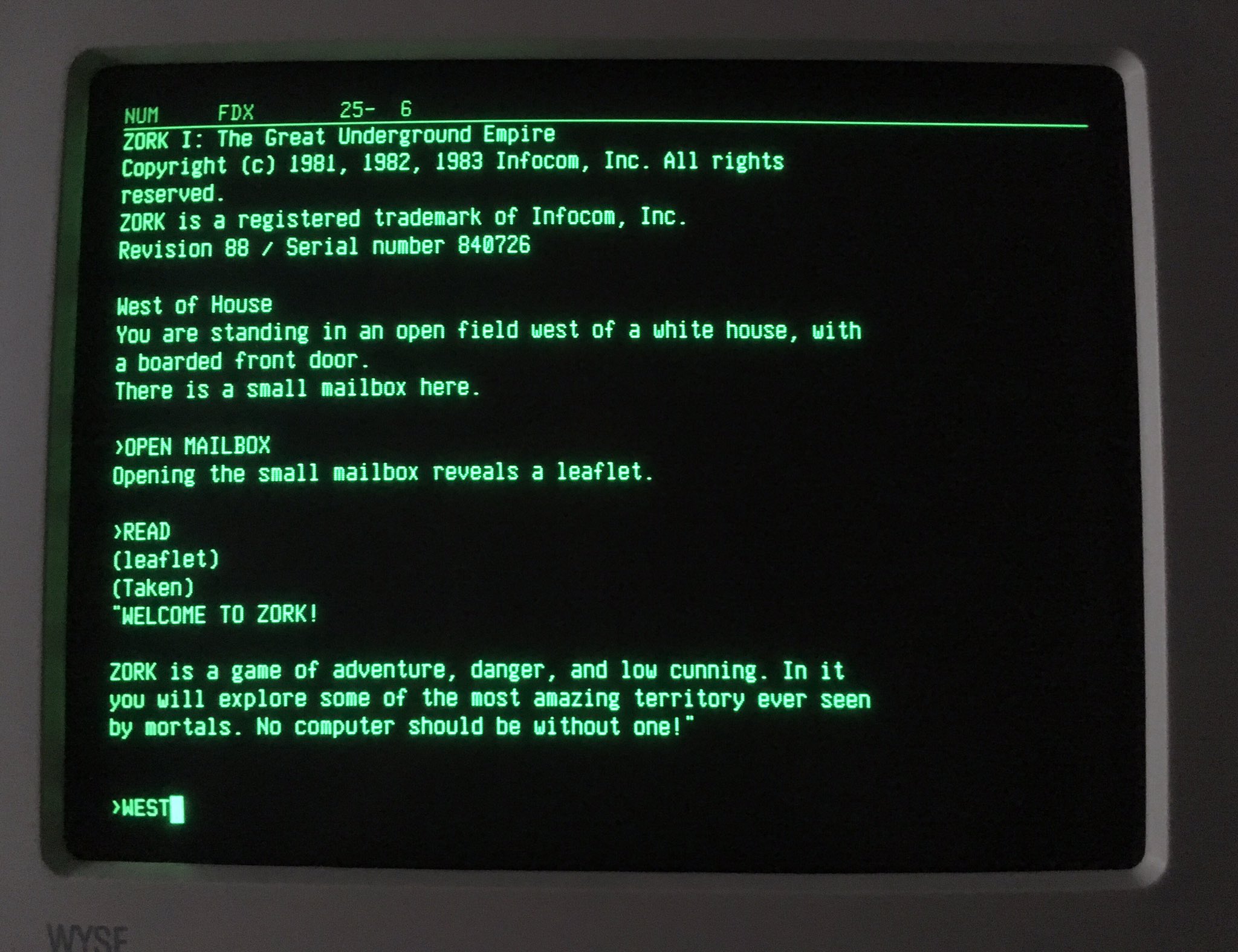

The returns team at my work cleared out a banks DC recently, I was going though the pallets of returns and found an new/unopened Wyse WY-55 terminal... it's finally happened I have a "real" terminal for my 8800!
gmh wrote:The returns team at my work cleared out a banks DC recently, I was going though the pallets of returns and found an new/unopened Wyse WY-55 terminal... it's finally happened I have a "real" terminal for my 8800!
Sure beats a terminal program on a PC, doesn't it? (Unless you have to mount floppy disks, that is!)
