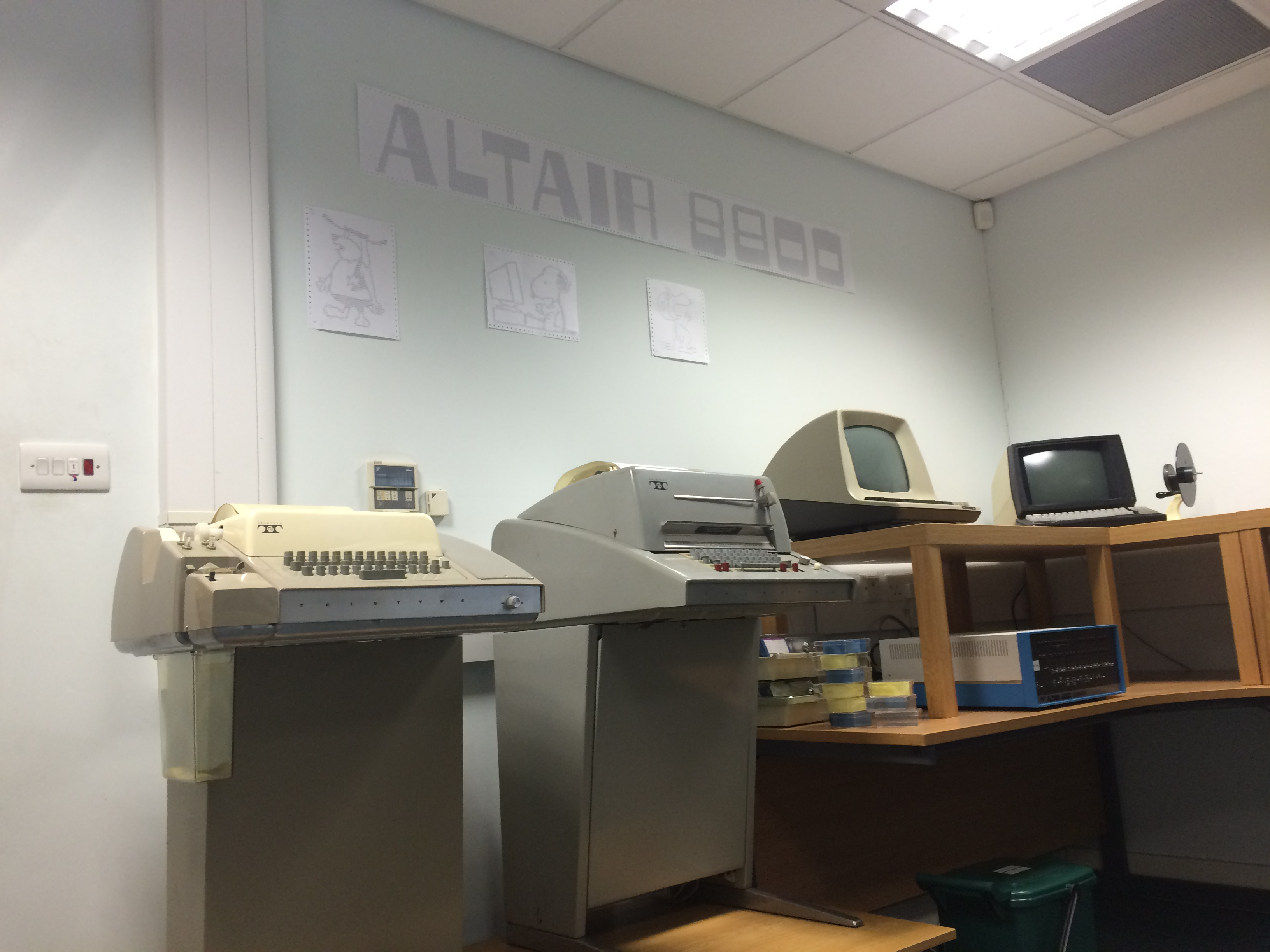

Wanted to show off our new 'Altair 8800' banner printed on one of our Teletypes. Thanks to Caterman for the program that prints this.

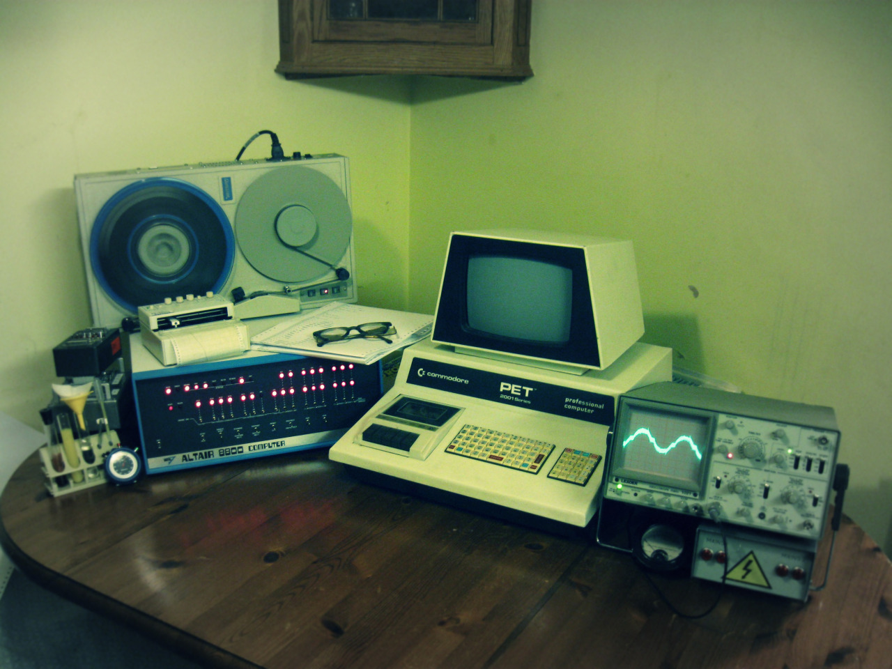

It's my first post here, so I thought I'd start off with some pics.

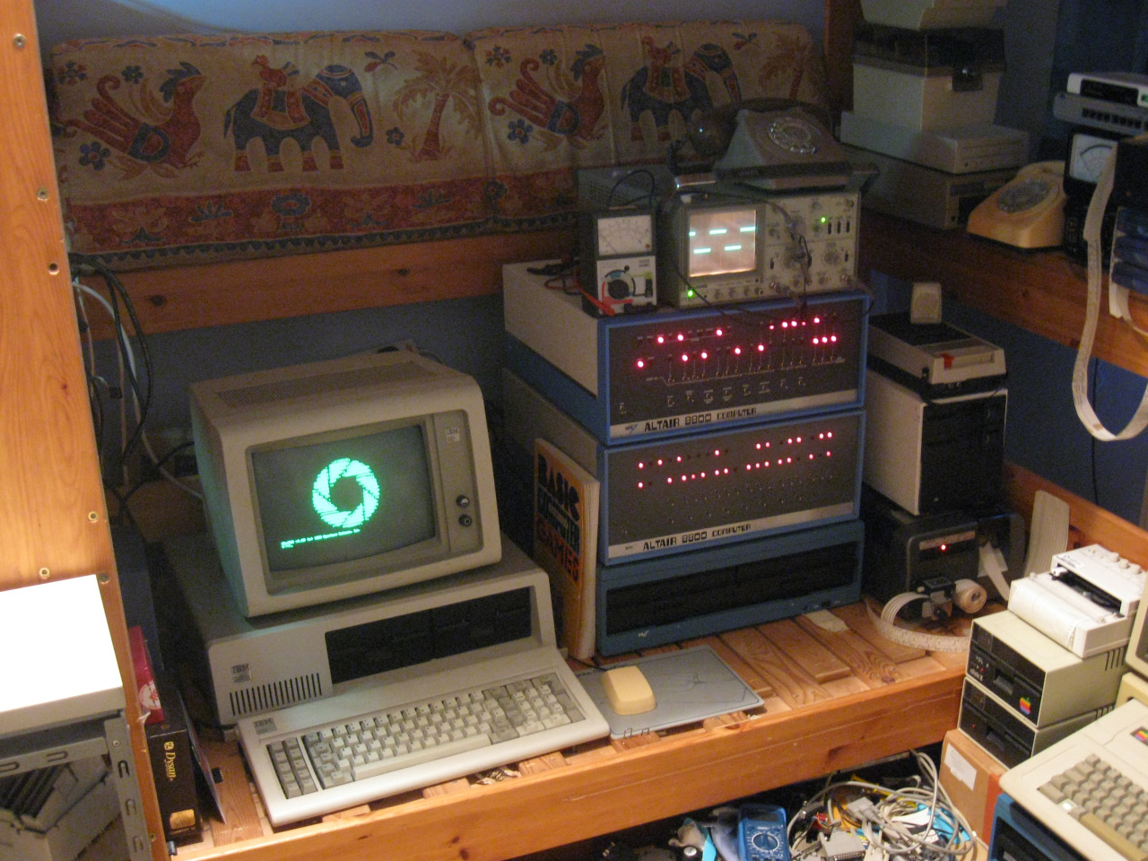

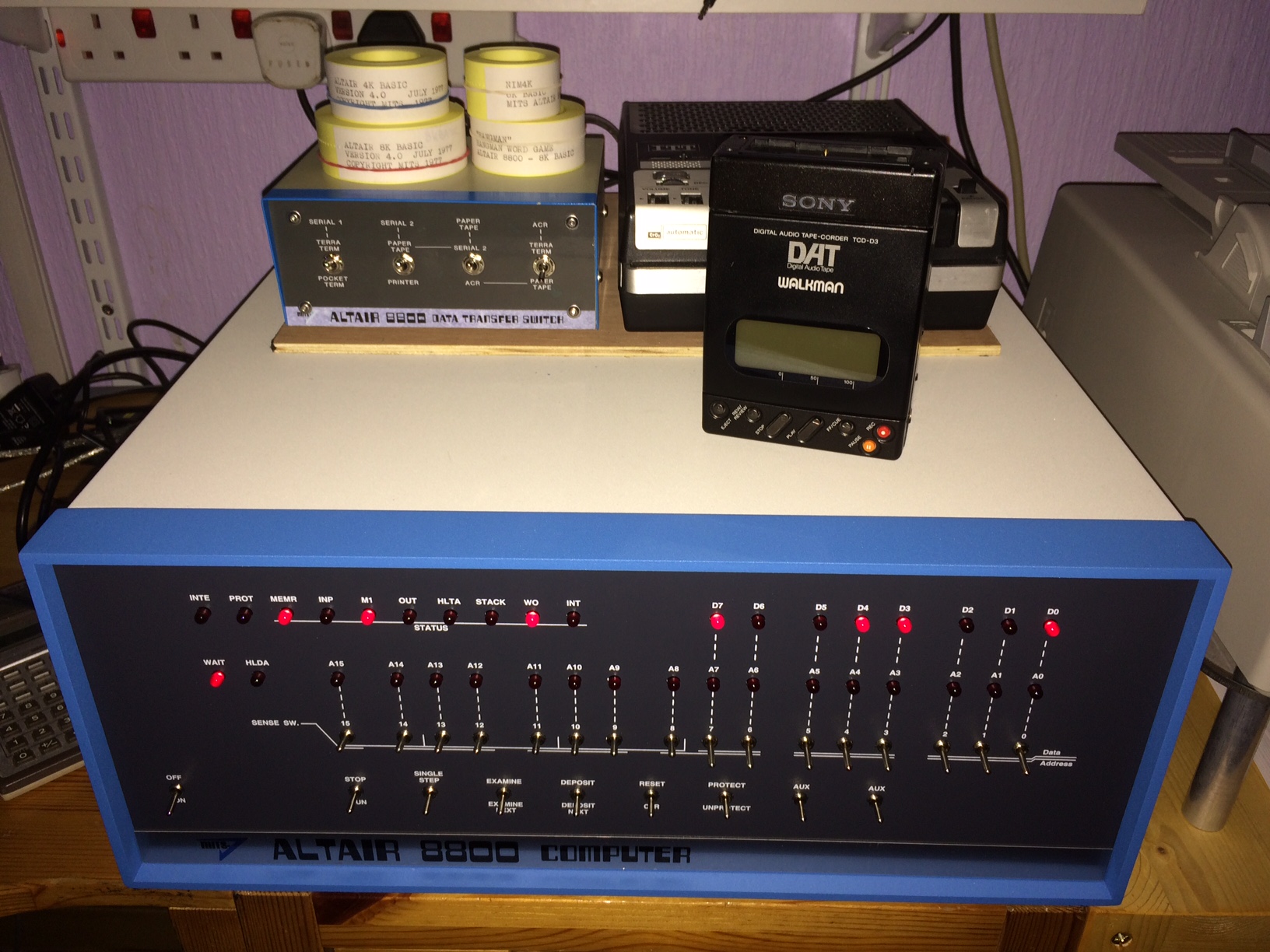

Just got my Sony D3 DAT working. A bit overkill but really easy to find the data on the tape with start ID's.
Plus using a DG90P tape on long play should give you approx 6 hours of data on one tape!!!!!!!!!!!

Hey I have a Sony DAT somewhere, hasn't been used since the 20th century I think - hadn't thought it could be used with my Altair Clone! Now that's an idea.. thanks!

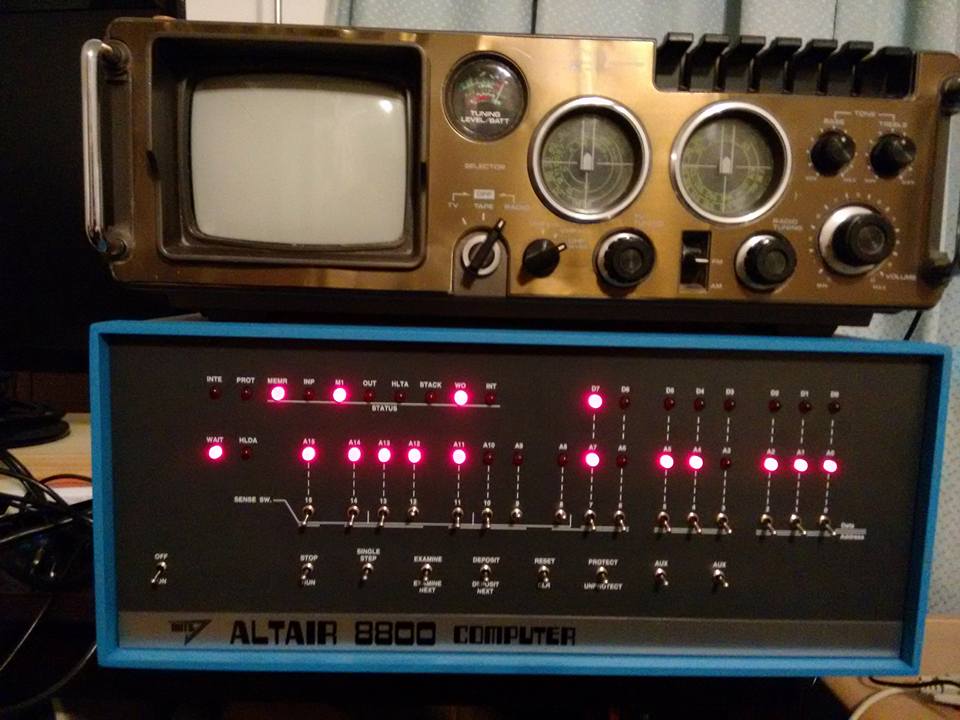

Here's my Altair stack. The radio, tape, TV combo was manufactured in 1978. It does a great job of recording and playing tapes, and has a great speaker to boot! Most importantly, its tapedeck has a counter, which is absolutely a must for using cassette tapes as storage media. I plan on building a TV Typerwriter (of the Don Lancaster variety), so that I can use that small monochrome CRT as a terminal.
That's a great retro look! All those meters and controls really make your setup look like it's ready to get to work. I've always been a fan of lots of readouts, knobs and switches such as on the submarine Seaview or in space capsules.pngwen wrote:Here's my Altair stack. The radio, tape, TV combo was manufactured in 1978. It does a great job of recording and playing tapes, and has a great speaker to boot! Most importantly, its tapedeck has a counter, which is absolutely a must for using cassette tapes as storage media. I plan on building a TV Typerwriter (of the Don Lancaster variety), so that I can use that small monochrome CRT as a terminal.

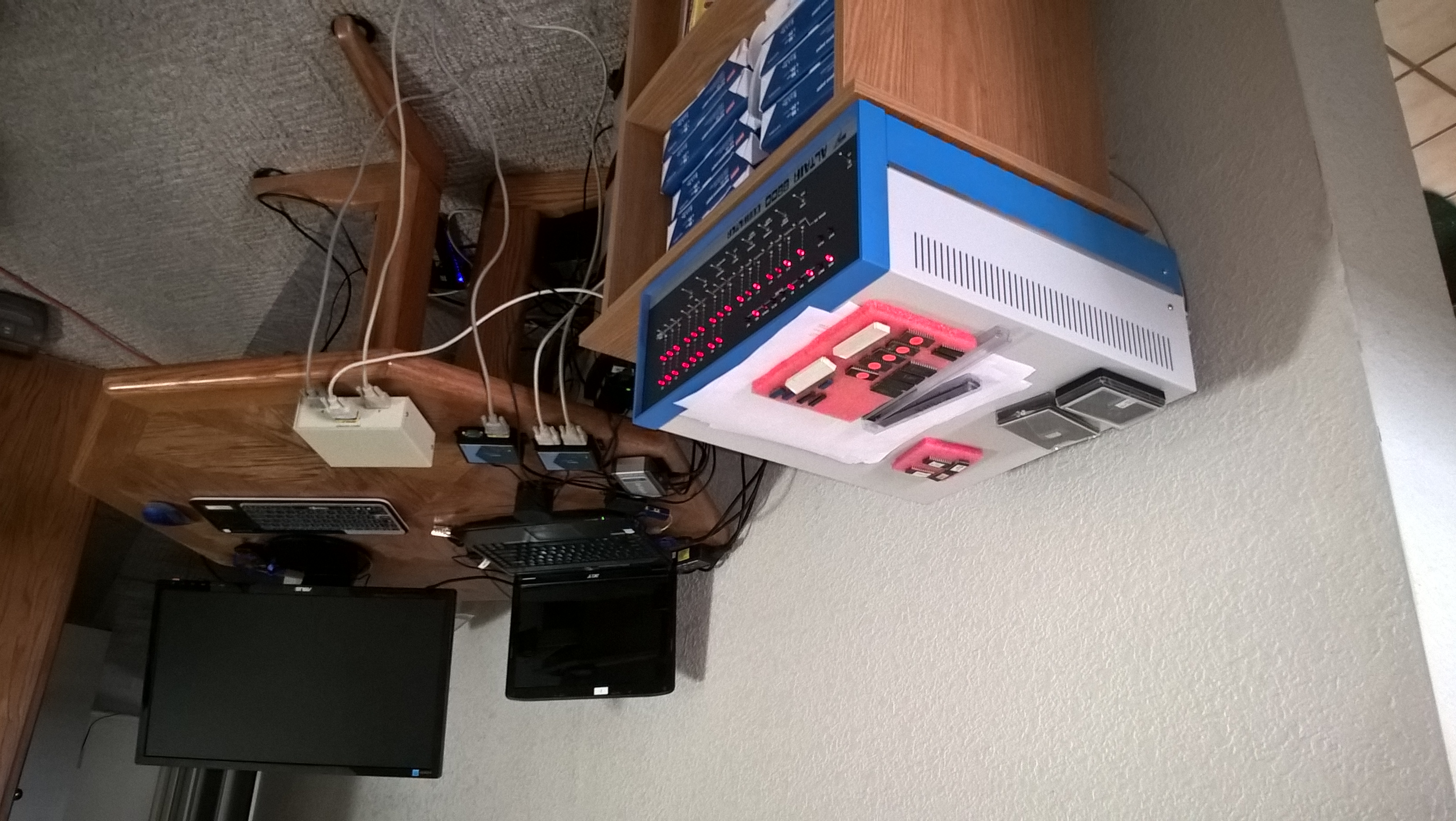

Here is my Altair Clone running Remote CP/M (RCP/M) software. The RCP/M is connected to the internet using a GW312 Serial to Ethernet Server and accessed using Telnet.
Click on the image to see it correctly.
