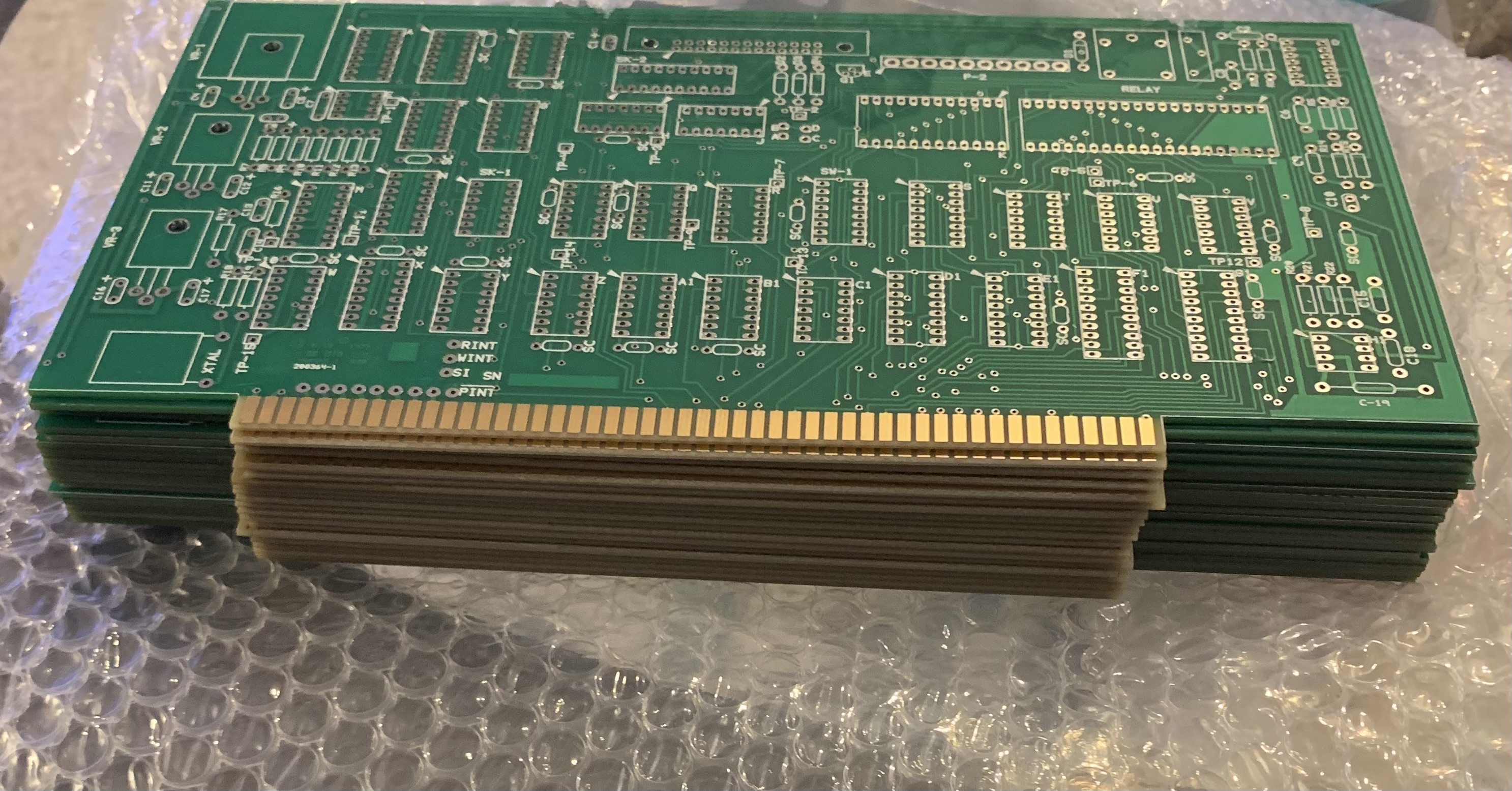

I'm probably the most anxious of anyone. Their first attempt at producing the boards was a fail because the didn't mask the connector fingers when they applied the HASL finish. They built a second set and this time the fingers weren't completely covered in gold. They also got some gold on the via's that next to the fingers, which didn't bother me since it has no functional impact. Probably my fault anyways for not putting enough space between the fingers and via's. They are redoing the gold finish on the fingers and claim they will ship by the 26th. We'll see.
- Joined: November 1st, 2023, 2:03 pm
Re: Reproduction Altair 88-UIO Universal I/O Board
They’re here!
