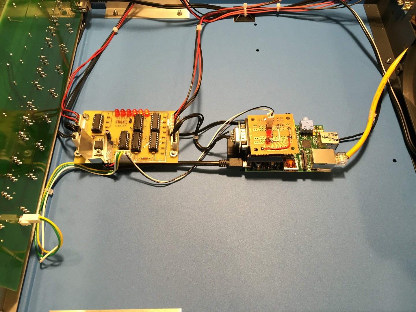

I see that several Altair Clone owners have put their units on the internet for sharing and/or remote access. Here are pictures of my version on that theme. In my case I installed a Raspberry Pi (board on the right) in the case as my serial to network interface. I also wanted to be able to select between my external Wyse 55 terminal via the standard RS232 connector on the back of the Altair or the internally installed RPi network interface. I designed a second board (the one on the left) that accomplished this task. This board also allows me to take control of the main serial remotely via a interface line on the RPi if I forgot to switch it from the extra Aux switch on the from panel of the Altair. I'm building a third PC board to replace the prototype control line daughter board plugged in on top of the RPi.
Once I get some time, I'll document the whole thing and place it on my or some other website for others to look over.

Re: New batch planned?
What a great looking job! Look forward to seeing the details posted.

So I have the primitive versions of the Serial AB switch and Raspberry Pi project details up on one of my web sites. This covers the details behind my earlier post in this thread. Have a look if you are interested.
http://www.astrorat.com/altair8800/serialabswitch.html For the Serial AB Project
http://www.astrorat.com/altair8800/altairmeetrpi.html For the RPi Project
Remember that this is a work in progress. Once I'm done, I'll re-post in a new thread.
If you have questions post them here or send me a private message.
Thanks JNZ for the kind words.JNZ wrote:That's a really cool project! I too have RPis lying around, and I like to make my own PCBs. I like the idea of using only PDIP. Did anyone do wire wrapping for these boards? That might be fun too.
I did not go wire wrap during the engineering phase, I did create a breadboard version of the design for testing before I did the PC boards. Once I had everything working on the breadboard I made the PC boards. I did a small six board run with no silk screen or solder mask. I'm using two right now. As it turned out, there where only two bugs in the boards. 1) I turned around the power LED so the anode/cathode labels are backwards. 2) I turn around pins 1 (should be GND not +12VDC) and 2 (should be +12VDC not GND) on the power connectors J1 and J2. Had to make two cuts and one jump to fix that. I have already fixed the schematic and if I ever make another run of boards the CAD file for version 1.1 is also fixed.
