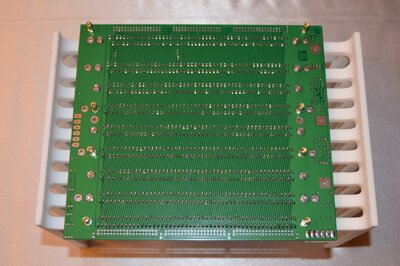

One more observation. With everything in the case, the 'feet' of the cage raise everything too high for my card set. Some of the ribbon cable 'clips' are too high to put the cover on when engages. Going to go to the shortest standoff I can and trim the bottom of the cage pieces to make fit.

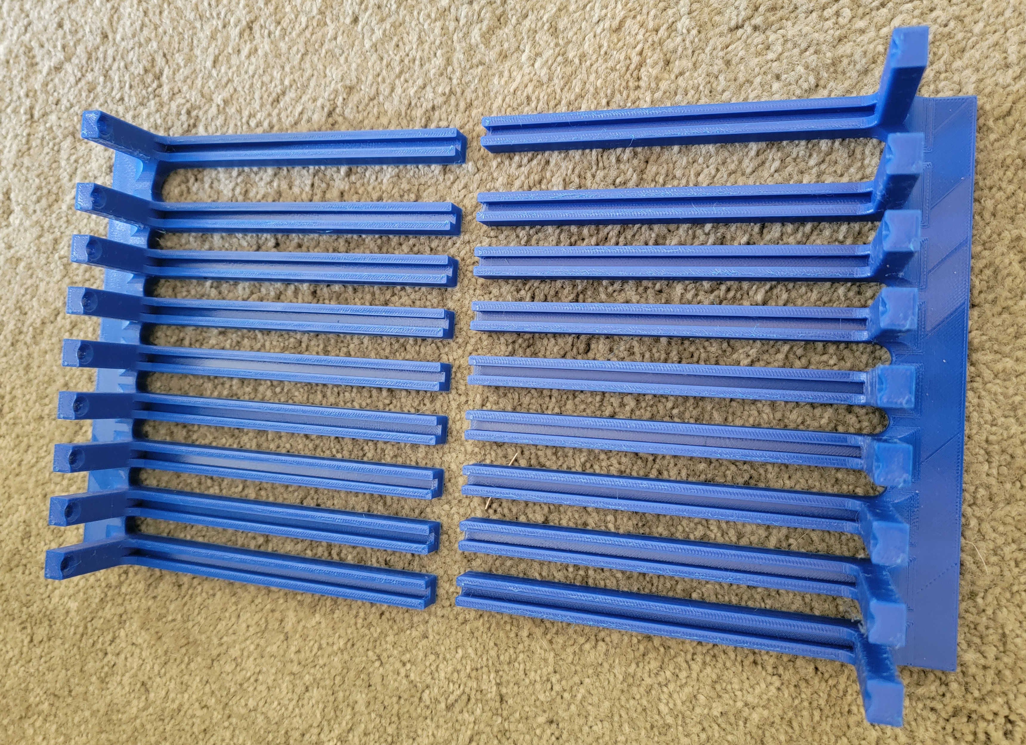

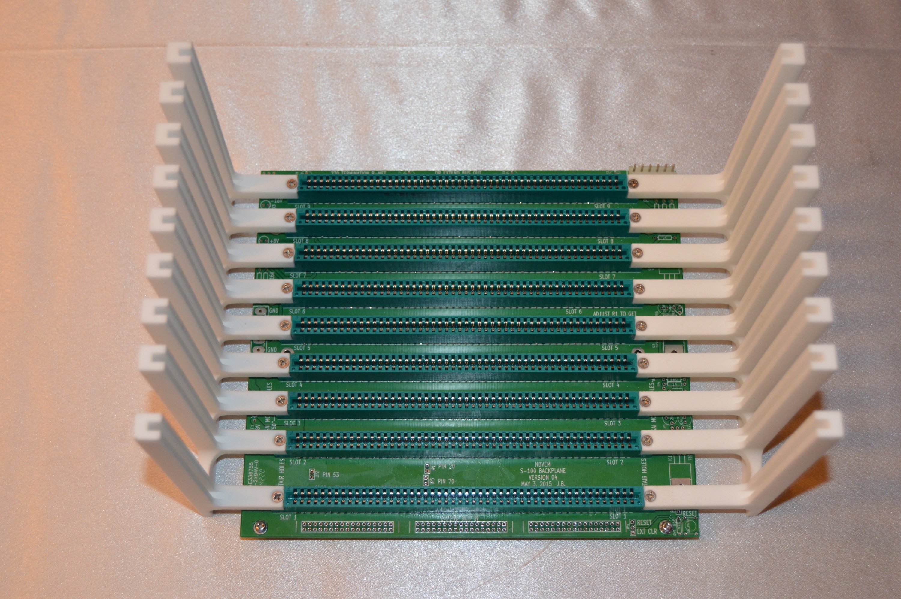

I've worked through the details of mounting an improved card cage for the 9-slot backplane. Use the STL files attached below to create your right and left sides. Everything mounts using the existing holes in the cabinet, so no drilling is needed.
To install the card cage and backpanel, you'll need the following hardware:
(18) M3x20 countersunk screws
(8) M3x10 threaded spacers
(12) M3 nuts
(4) star washers for M3 screws
(20) M3x6 screws (might want more for your power supply)
All 18 holes in the card cage / backpanel assembly use M3x20 countersunk screws. This keeps the screw head flush with the card cage so there's no interference with any circuit boards.

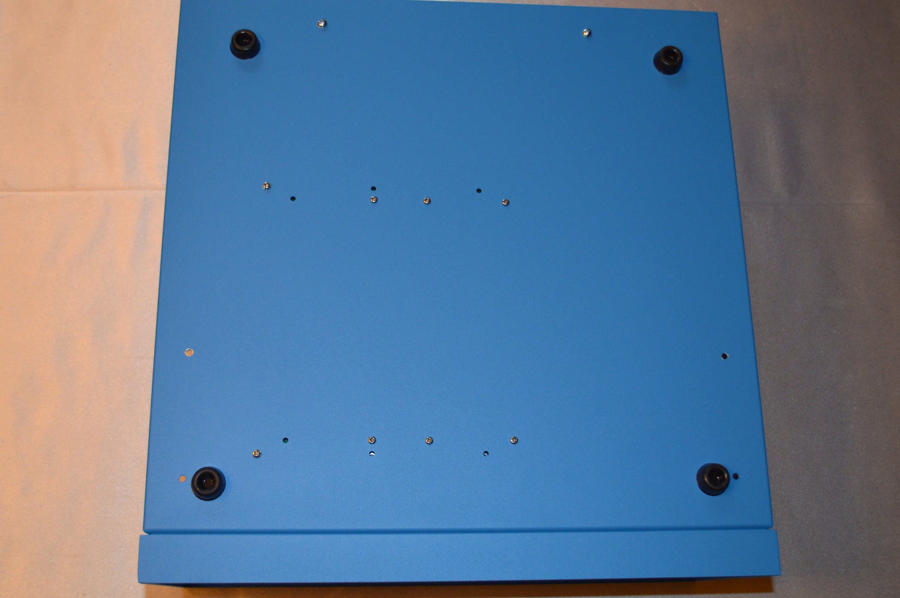

Underneath, use M3 nuts on slots 1, 2, 3, 5, 7 and 8. Use an M3x10 threaded spacer on slots 4, 6 and 9 and also use them on the outboard (IMSAI) holes nearest slot 1. Mount those outboard spacers with M3x6 screws and put a star-washer underneath the screw head. This will bite into the ground pad and provide good grounding.
Underneath the cabinet, line up the holes with the threaded spacers and mount the board with M3x6 screws. The easiest way to do this is to get the assembly into position and thread one screw into place. Don't worry about the other holes - if the assembly rotates away, it's of no concern as long as you get one screw in. Then once you've done that, use the screw as a pivot to rotate the assembly into position to thread the remaining screws. Use a star washer under the outboard (IMSAI) screws to bite through the paint to ensure a good ground connection.

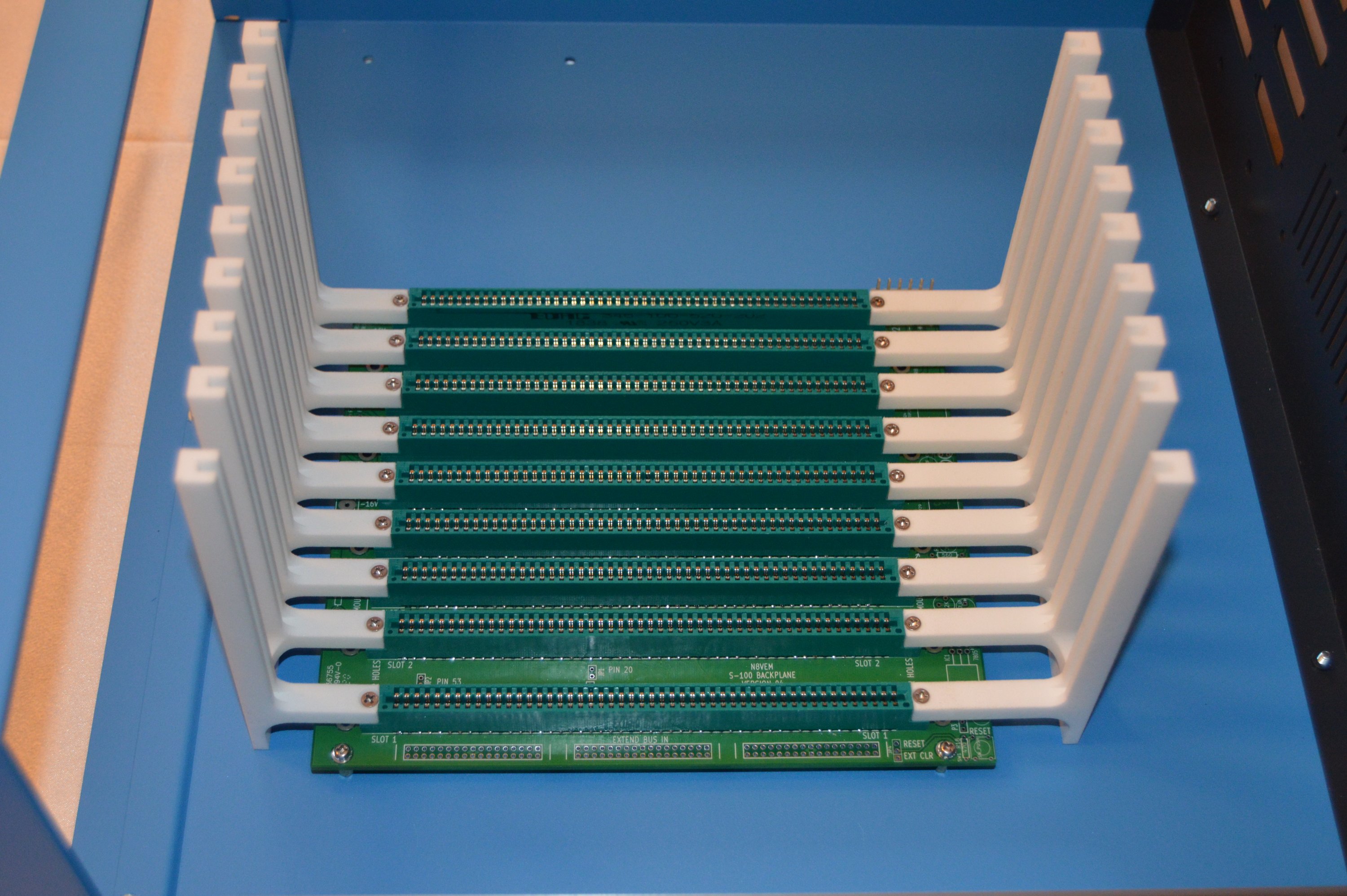

Here's what the backpanel and card cage assembly looks like when mounted in the cabinet:

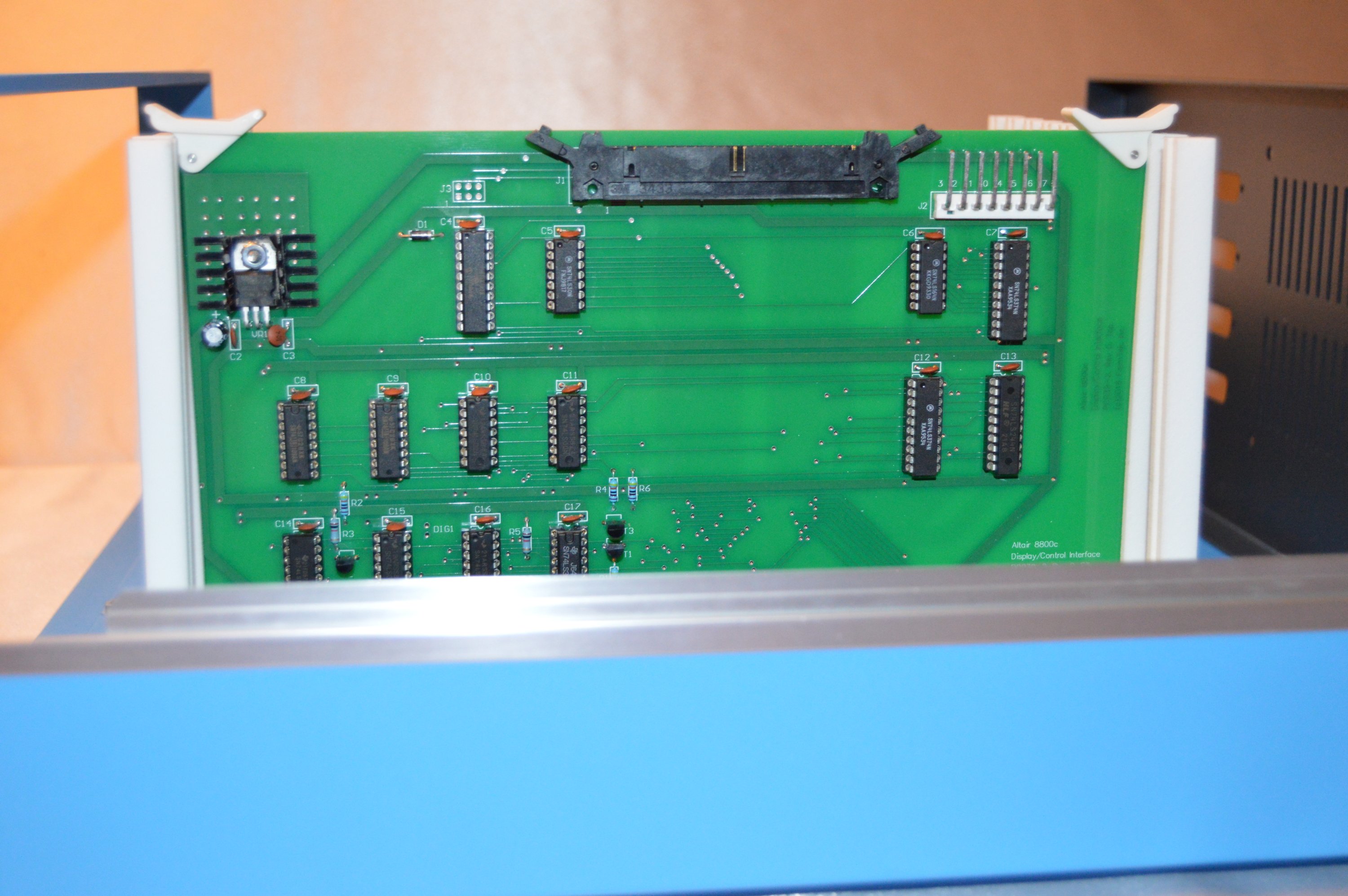

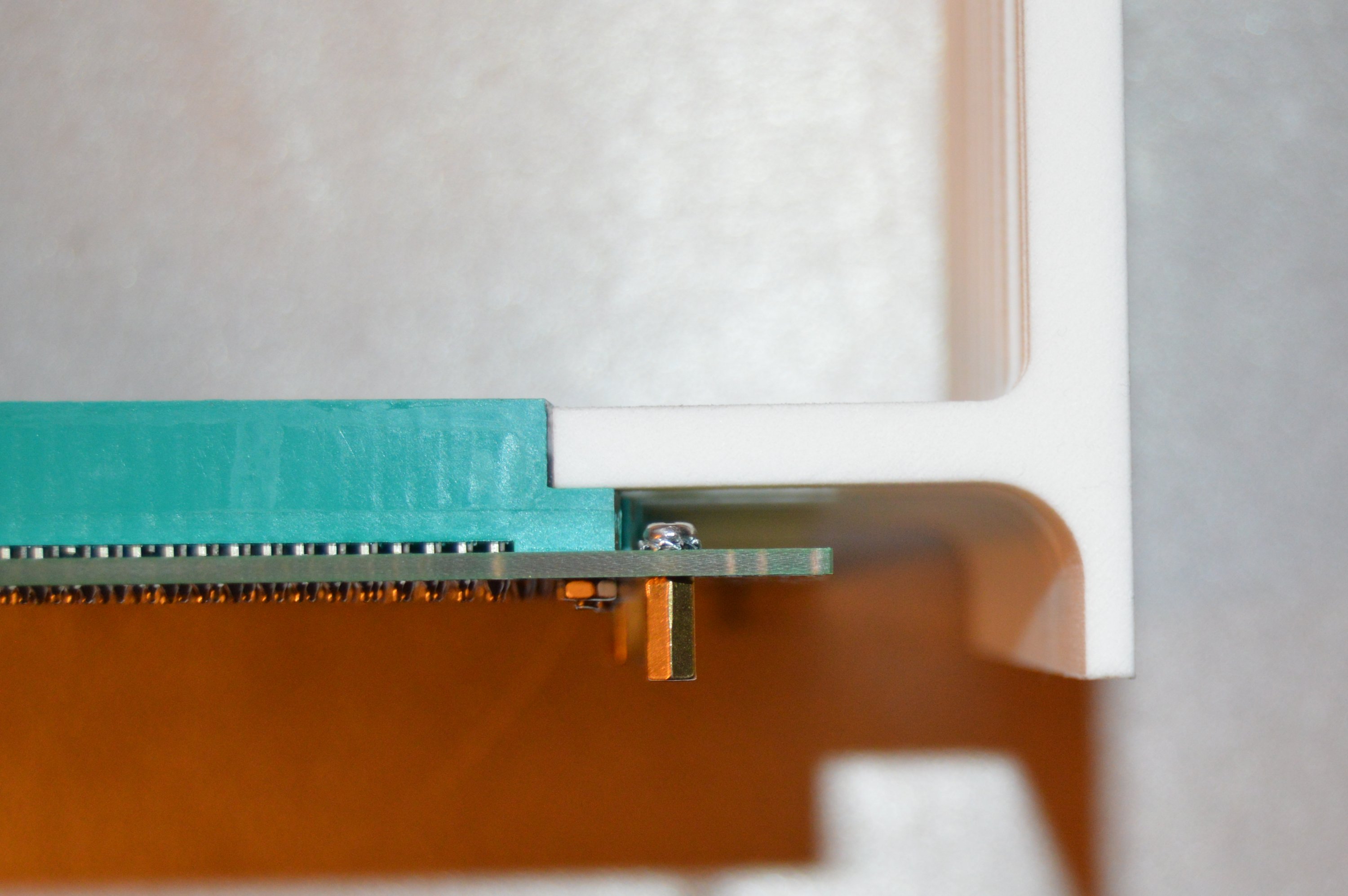

And here's a photo of an installed board, showing ejector alignment with the top of the cage:
