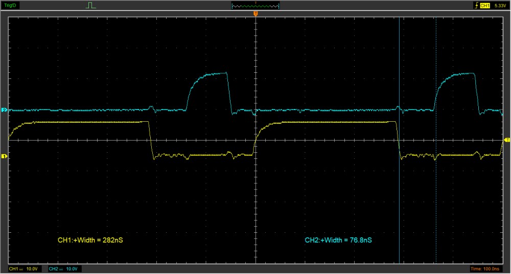

I was assuming it was a hardware issue. Just wanted to have the AMON source code to see how it's accessing the hardware. I'm a 6502/6800 guy and am a bit unfamiliar with how things are done in the 8080 world. In any case it's usually a handy debugging tool to see how the software is supposed to manipulate the hardware.
I'll try your suggestions Mike.
The 2-phase clock image is attached.
td1 = 65ns
td2 = 74ns
td3 = 137ns
The pulse widths are on the image.
And my CPU is an 8080A-1
td1 = 65ns
td2 = 74ns
td3 = 137ns

The timing spec that causes the most processor behavior problems is TD2. Yours is presently on the hairy edge. I’d tweak R42 a bit to shorten the phi2 high period by 20ns-30ns or so. This, in turn, increases TD2 by the same amount and leaves the phi2 pulse time well above the 220ns minimum.
I don’t recall the leading edge of the clock having such a slow rise time. I’ll have to set up a test configuration and see. The rise time is based on R29,30 and R32,33, and the capacitance they’re seeing from the output of IC-N and 8080 clock inputs. Doesn’t look quite right.

1) and 3) did not make any difference (did 3 before 2), but after moving the card to a different bus slot it's been sitting for over 5 hours without a spurious character.AltairClone wrote:

I agree about the clock, especially the rise time. I'll make some adjustments there and post the results. Since I'm using the -1 CPU, the rise time constraints are a little tighter. I'll also pull the MB and check out my soldering on that one connector. I used EDAC connectors so I doubt it's the connector's fault. I won't be able to get to all this until next weekend though.

Don’t go tearing apart your motherboard until you get the CPU clock looking a bit better. It’s not unusual to have different issues in different slots due solely to the timing issues caused by the shape of the ringing waveform at each slot. A CPU clock adjustment may make the bus cycle more tolerant and both slots could then work fine.

Well, that's why I'm here. To tap into the experience available. I'm very grateful for your input Mike, and it seems you may be right on the money.
I had a few moments today to try different combinations of slots and it turns out the 88-2SIOJP board is only happy if it is closer to the CPU than the FDC+ card.
I'll get to fixing up that clock first thing next Saturday morning.
