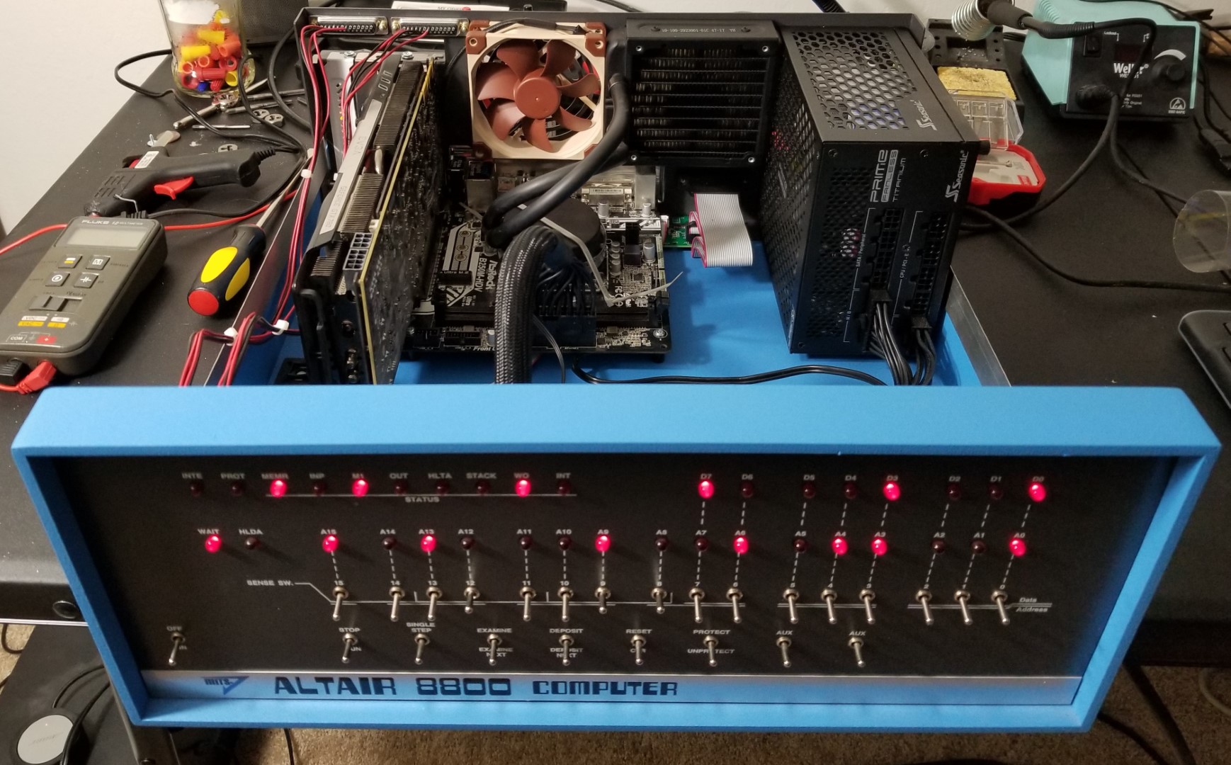

Not to resurrect too dead of a thread, but real life kind of got in the way of my backplate project. Busy at old job, get new job, move, busy at new job, what have yous. I finally had the chance to sit down and revisit, but I've realized that the backplate is just fine the way it is. I'm not going to change anything.

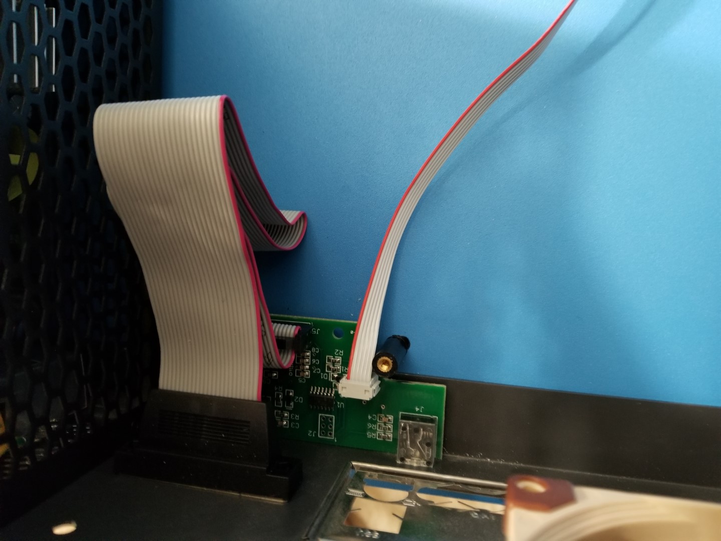

The last thing I had to check was whether a cassette interface fit. Short answer: It does, but with some modification. Long answer: Where I decided to put the cassette interface left a motherboard standoff right in the way of the circuit board. Luckily, that corner of the board didn't have any electronics in it, so it met with the Dremel tool. And like just about everything else, it just BARELY fit. But it sill loads 8K Basic, so I think no harm, no foul:
From the back:
So I am going to call the design complete:
  • A Micro-ATX Motherboard fits (20mm motherboard standoffs must be used).
  • An ATX Power supply fits. Barely. Case screws may have to be shortened depending on power supply model. My fanless power supply lets the screws poke into vent holes.
  • Using Mike's 5V modification, the clone circuitry runs just fine off of the ATX power supply standby voltage.
  • Two 92mm cooling fans fit. One of the 92mm cutouts is large enough for an Asetek 545LC 92mm liquid cooler.
  • PCI expansion cards fit in the vertical cutouts (motherboard acts as the inside anchor)
  • The two Altair serial ports have space, the internal wires reach, and there's enough room for a fairly large db-25 cable to plug into both of them simultaneously.
  • The Altair cassette interface fits, the internal ribbon cable reaches, and there's plenty of room for 3.5mm headphone jacks top to bottom.
So for the good stuff: I've sent off a request for quote for 5 more of these. For those that are interested, I'm going to sell them, at cost, on ebay (apologies in advance, its my first time selling on ebay).
When I got the quote for the first one, for five they were $120 apiece + a "setup fee" of $70. My guess is I'll get them out for around $150 + shipping. When they get back to me with the quote I'll keep everybody up to speed.

I've realized that last set of pictures was pretty crappy. I spent a little time putting the dummied-together unit back together and snapped a few more photos (my serial number sticker didn't survive the transfer):

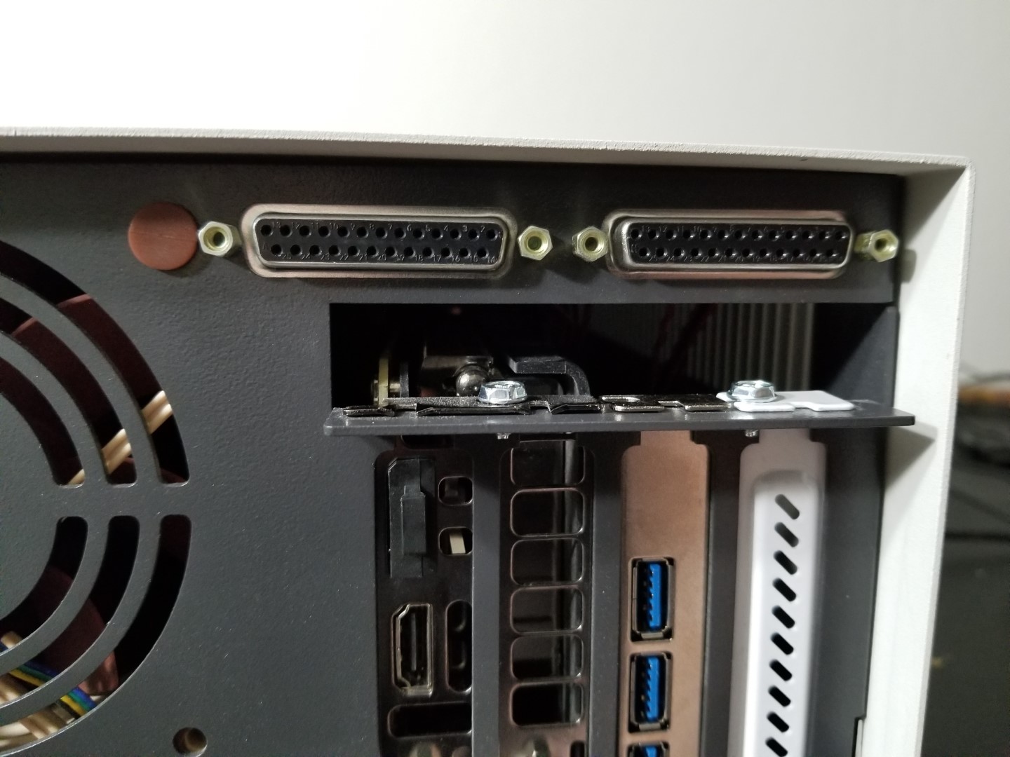

The main event, the backplate:
Tape interface:
Serial Ports:
steve_a
Posts: 27
Joined: May 16th, 2018, 10:34 pm
Re: A new backplate showed up at my door today...
Post by steve_a »
I can only attach 3 photos, so here's a second post.

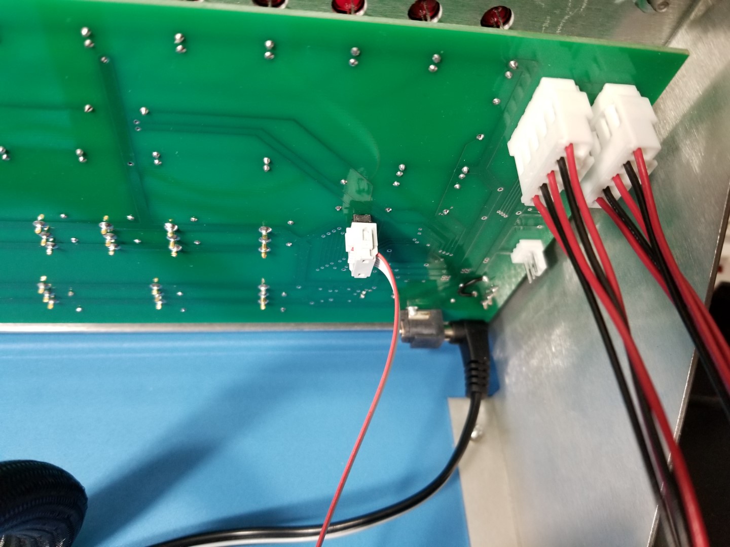

Except the stock fan (can't run with the 5V mod), everything hooked up inside:

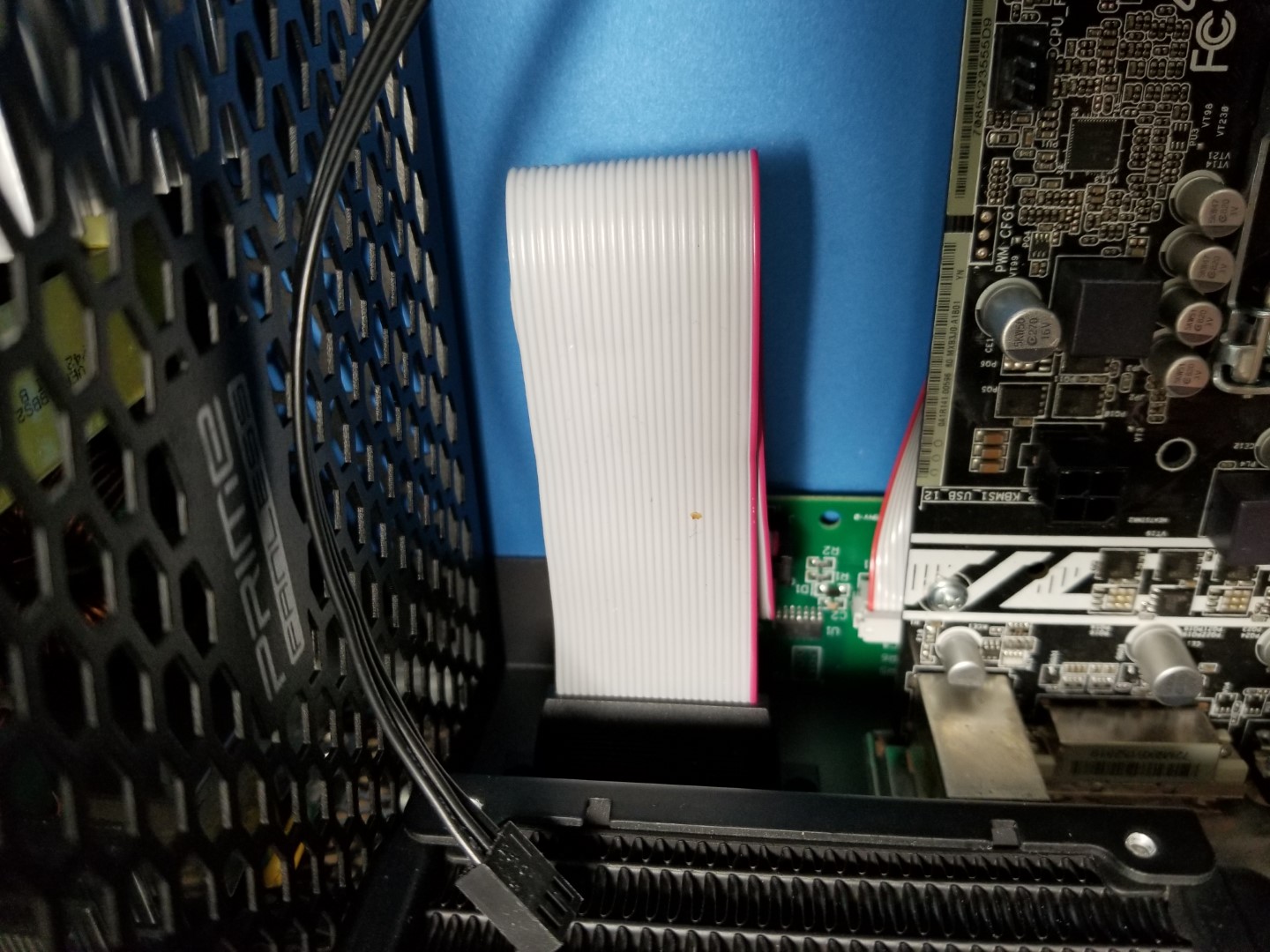

Tape interface squeezed in under the motherboard:
Clearances around the serial ports:
steve_a
Posts: 27
Post by steve_a »

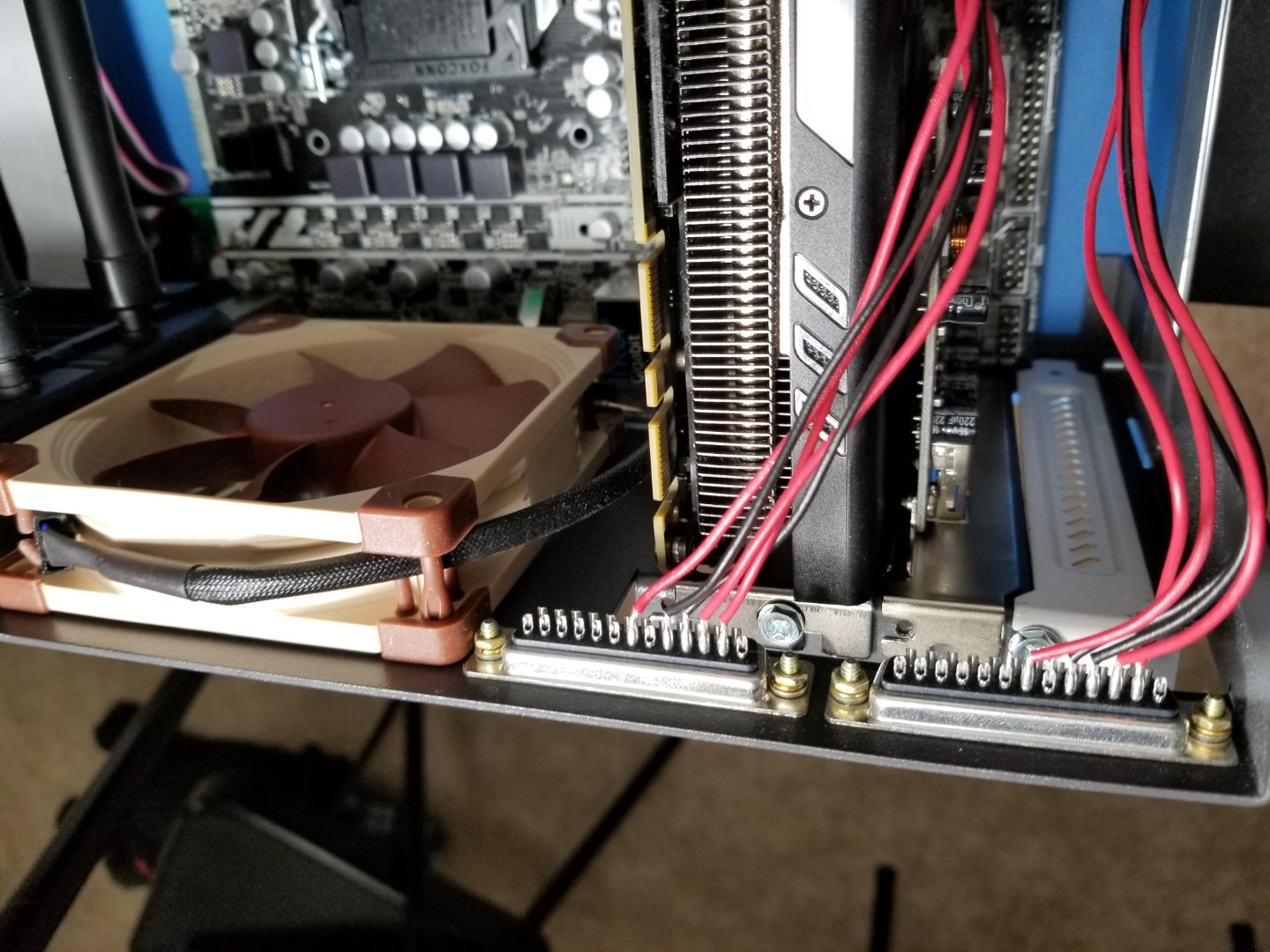

Last post of photos:
Clearances around the fans:

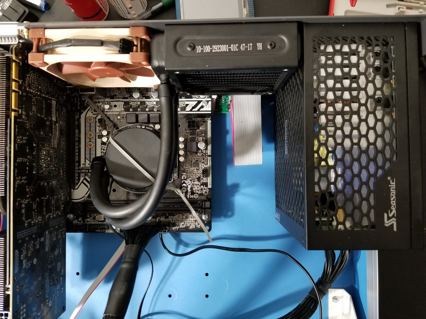

The whole thing, dummied up and running.
(small edit: After flipping through my own photos I plugged the PCI-e power cables up to that GTX 780 and it did fit with the top cover on. Hopefully the newer cards have the same dimension constraints)
Now just waiting to hear back from the backplate fab shop if anyone else wants one, and to purchase *actual* micro-atx equipment.
Cheers!
