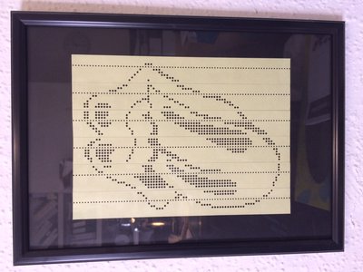

It's very difficult to not answer your question about the blank punch position, but regarding flipping to the other side of the tape...
I ended up flipping the image on my paper-tape message printing program for the same reason you mention. I did it in a loop rotating the input byte to the left through carry and likewise to the right for the output byte. Not elegant, but it works.

Re: Wall art for 1970s lab--Snoopy?
Ummm...the holes go all the way through the tape. Just turn over all the tapes and Snoopy will be facing the other way with no arrows. :)mail@gabrielegan.com wrote:It would be an interesting exercise for a student to take the code that produces this and transform it so that Snoopy appears when we look at the other side of the paper-tape. I guess that means mirroring each byte so that the least-significant-bit goes to the most-significant-bit, the second-least to the second-most, and so on. That's just the kind of beginner's exercise my students should enjoy, competing to make the most efficient coding. (My first instinct is to use eight masking operations in a row to pull out each bit, but I wonder if there's some mathematical relationship that makes it simpler).
Thanks again, everyone, for this stimulating stuff.
Haha, well that's just too easy! Though in my over-engineered defense, my background in this topic was with printed messages on papertape which read incorrectly if turned over :)
