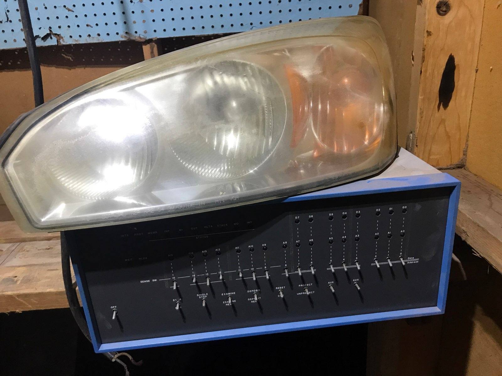

I am in the process of obtaining this Altair from the estate of a friend's relative. Unfortunately the machine is current in another state and we do not have immediate access to it. This photo is the only one we currently have.
Based upon the graphics I would believe this is an early version. But I am bothered by the lack of the chrome strip and Mits/Altair badging. Is this possibly an early kit, or has the badging gone missing, or have any other thoughts. The graphics look consistent the the "early" computer on Mike Douglas' deramp.com page.
I am looking forward to a personal inspection. Just wondering what the experts think. Sorry for lack of better photo and details.

Yes, the silkscreen style indicates it’s an earlier model. The missing nameplate is just that - missing - it’s not something that was added only for later models.
A rear pic could help with dating as well based on whether there is an internal radius on the DB25 cutouts. Earliest card guides were natural nylon colored instead of blue/green.

I know this forum is for clones and such, but I don't know of another forum with as many knoledgeable people. I received the Altair as a gift today. It is n early one, with a Rev 0 CPU and White porcelain 8080. I can't make sense of the date code on the CPU, does anyone have any ideas?
There are a fair share of "bodges" that I will try to undo, Also came with two "aftermarket 4K memory cards, and a partially completed tape interface. Motherboard does not appear original.
The front panel is the early design, but is missing the name badge. Does anyone know of a source for a replacement or reporduction?
I need to come up with a plan for first power. and see if it will rn. Any advice welcomed.
