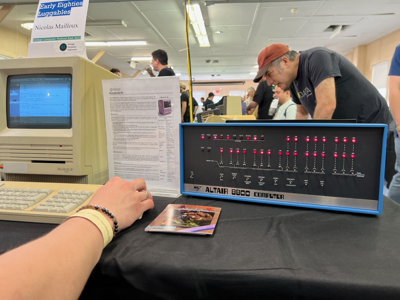

Hey guys!
I'm currently at VCF East showcasing my AltairClone, and I'm having some trouble getting a copy of the Adventure game to run on it. It's been quite a while since I've dealt with custom image disks and loading them onto the clone.
Would anyone be kind enough to spare some time and make me a disk for it? There are a lot of people around, and I can't fully concentrate on relearning everything.
